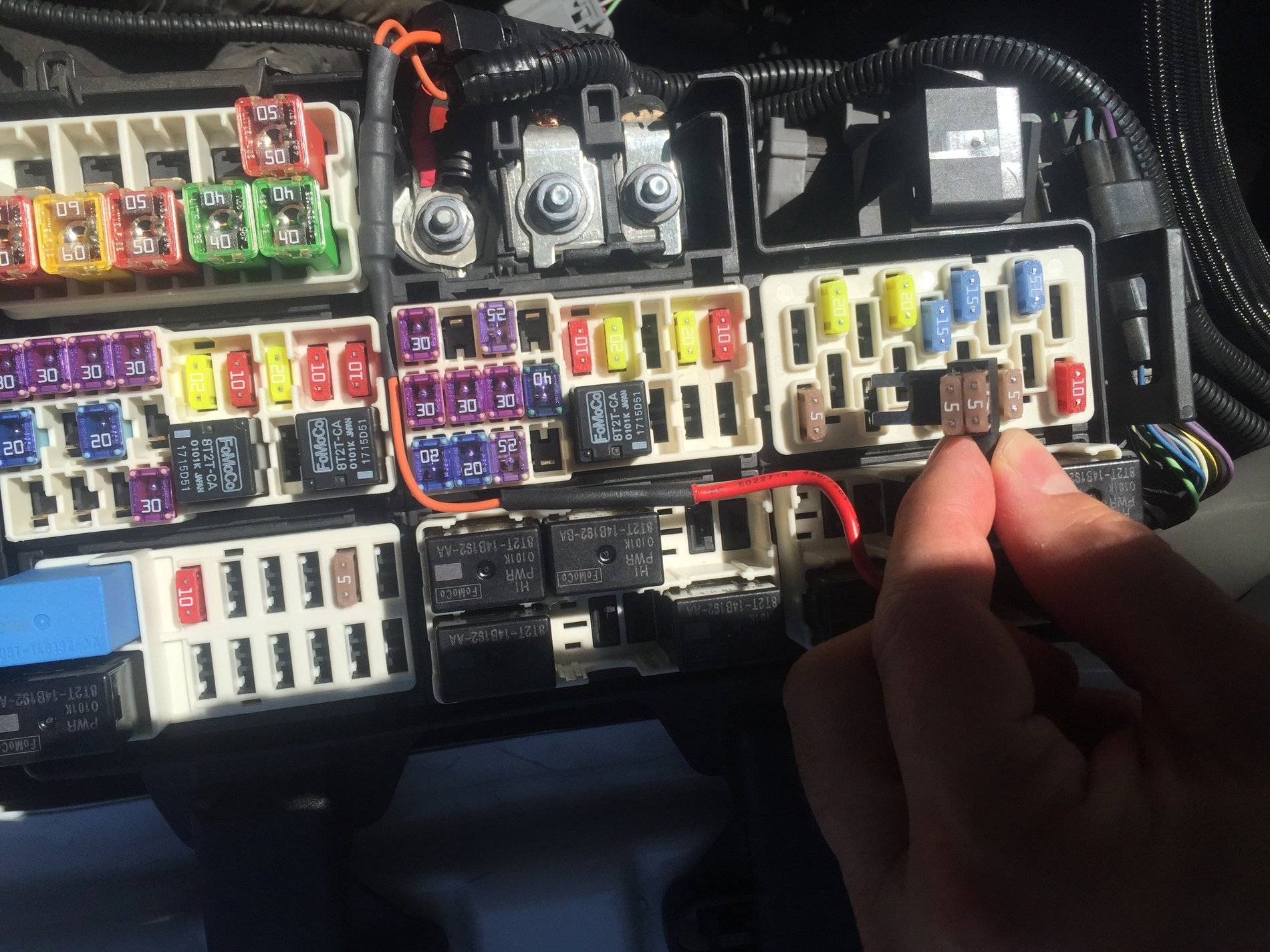

Hey guys. I am finishing up my whipple install and I see that the IC pump harness i got from whipple is the one with a plug to the IMRC. However I am doing a lund tune so i need it to work key on. Anyone have into on how to modify this harness to work for a key on source?

Well for any future searchers Whipple Tech got back to me and here is what they said.
"cut off the 2x connector put a ground eye on one wire and a add a circuit fuse tap on the other piggy back on fuse 62 antilock brake 12v ign
see attached diagram"

Slot 62 is the location I installed my harness 5 years ago.
