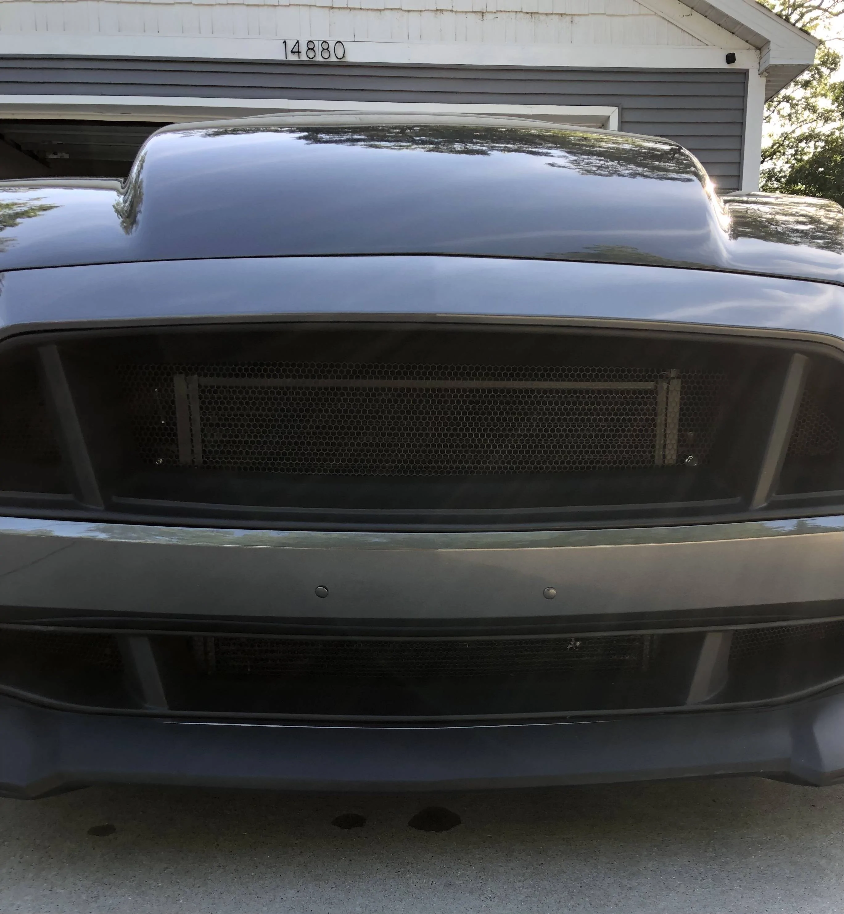

The occasional trip to get ice cream or short cruise you’d be ok without the HE, but any type of spirited street driving your gonna want a HE. A dedicated drag car and ice is fine, but street car you’ll want some type of HE. I have an hr one way to the track and like cruise and hit up Mexico once in awhile.
I run the Whipple Oversized HE, pic below.

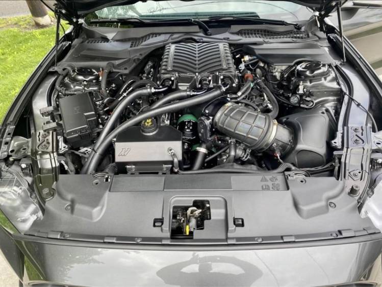

Depends the size of ice tank but You’ll never see temps more than 20 degrees over ambient. I have mine setup Ice tank-Intercooler-oversized HE-ice tank. Brick itself is an additional inch thicker than the regular brick. If you want the lowest IAT’s street/strip go with it.
Does that fit under the stock hood? Did it require adjustable height motor mounts?
QWKSLVR
May 17, 2019
104
Grand Haven MI
Jamie
‘17 Mustang GT
This is only draw back on the setup besides cost, it will not fit under a stock hood, requires more under the hood room with whatever choice of cowl hood or adjustable height motor mounts.
