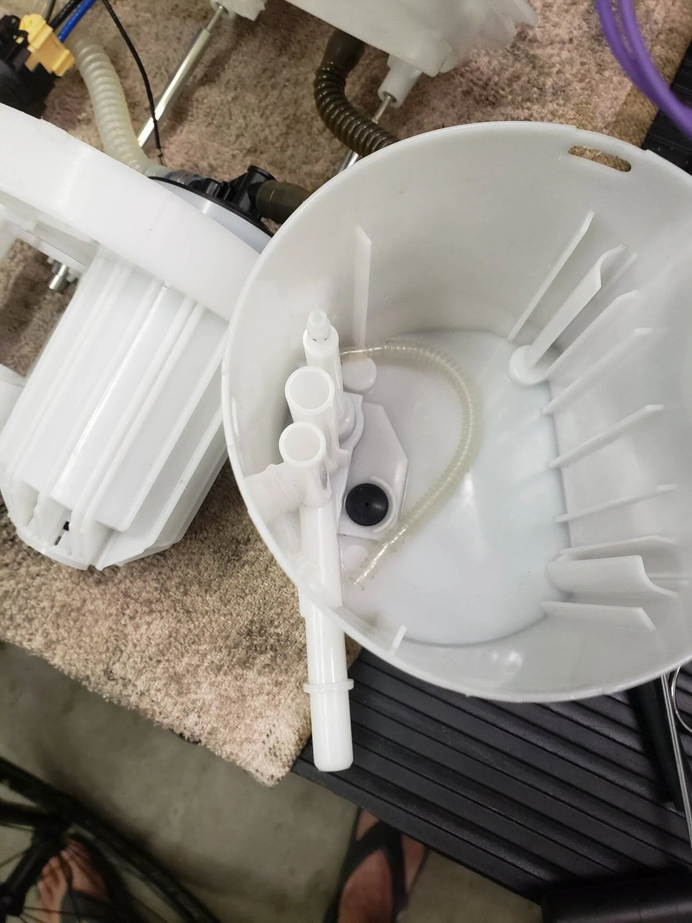

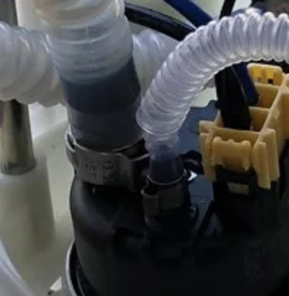

The fuel pump in the s550 has two hoses attached to it does anyone know what the second hose is for

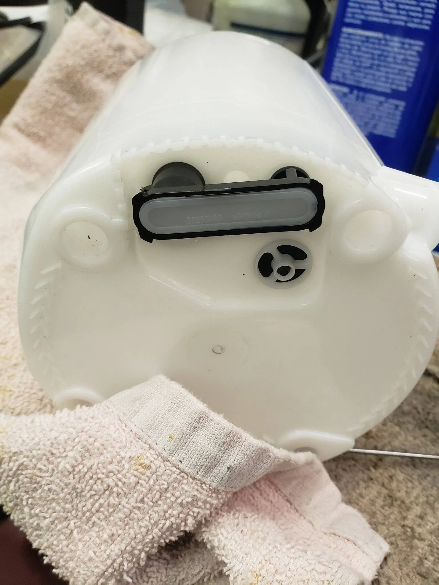

It's to operate the venturi/siphon system that draws fuel from the R/H side of the saddle tank into the L/H side. IIRC, it also keeps the fuel basket filled with fuel.
