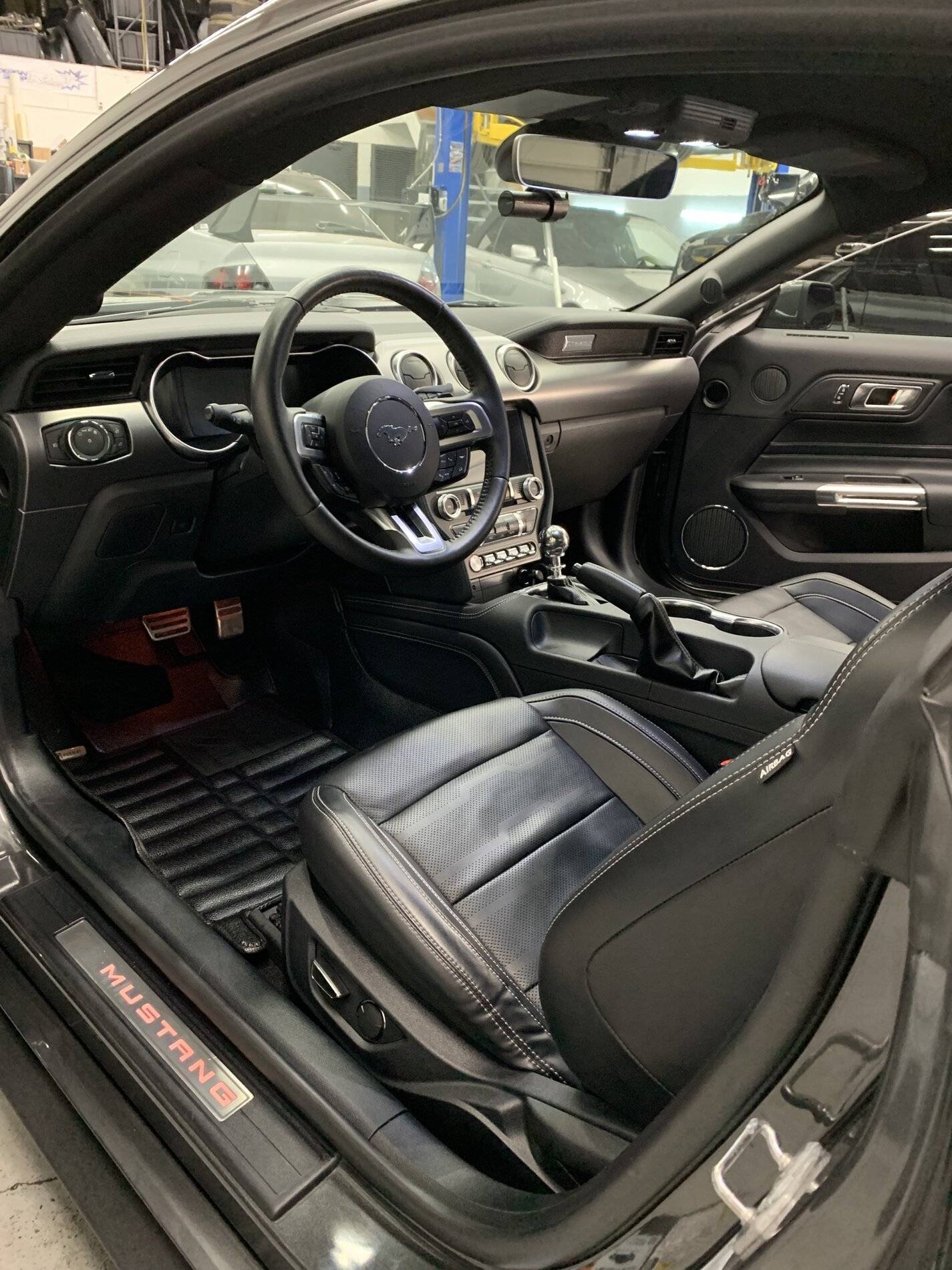

Not the best photo but mine is mounted underneath. Let me know if you have any questions.

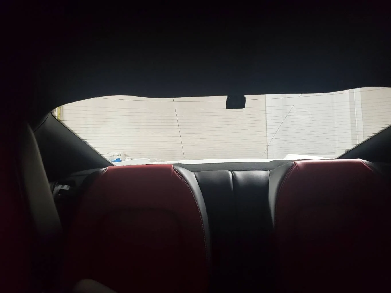

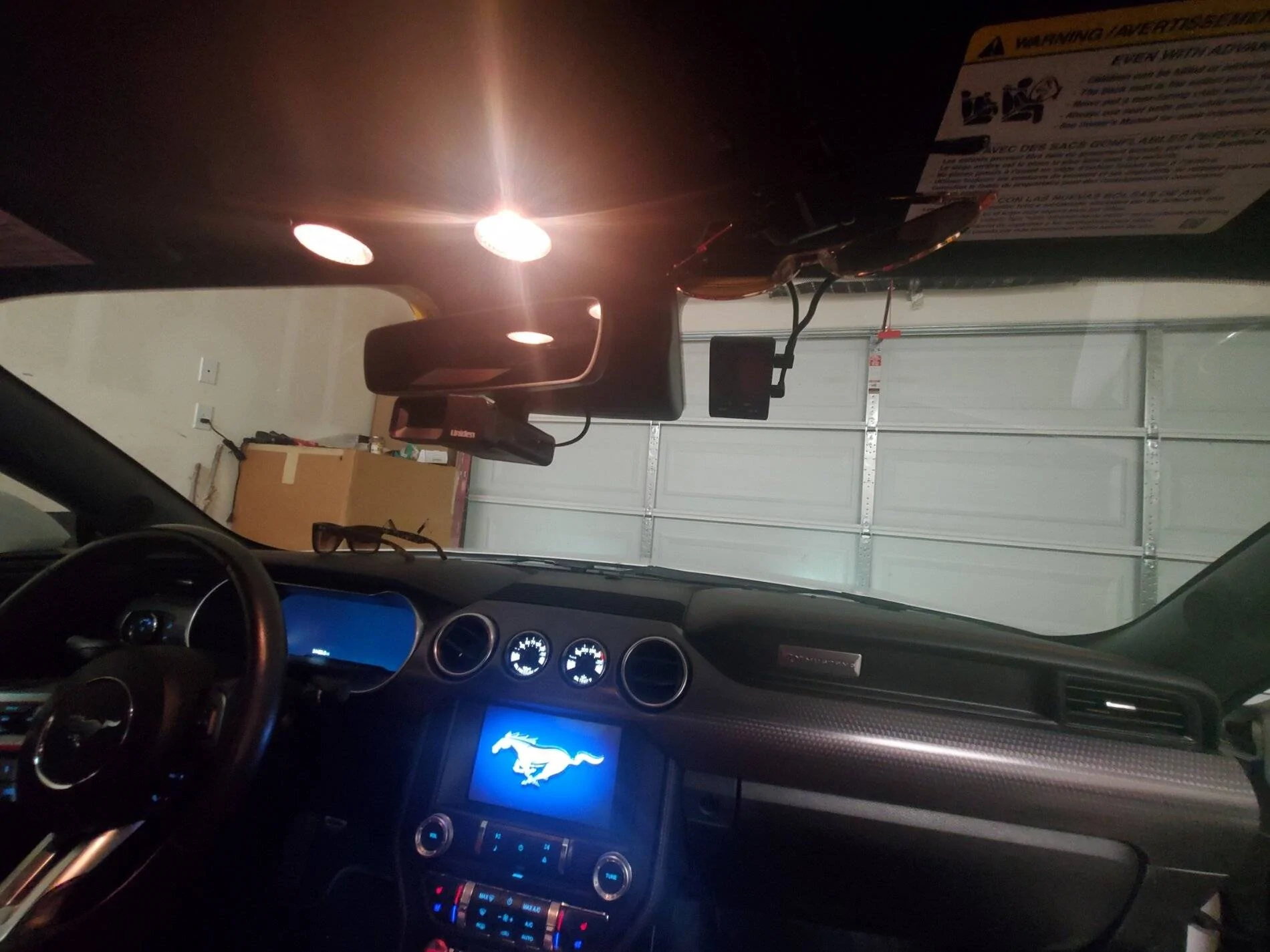

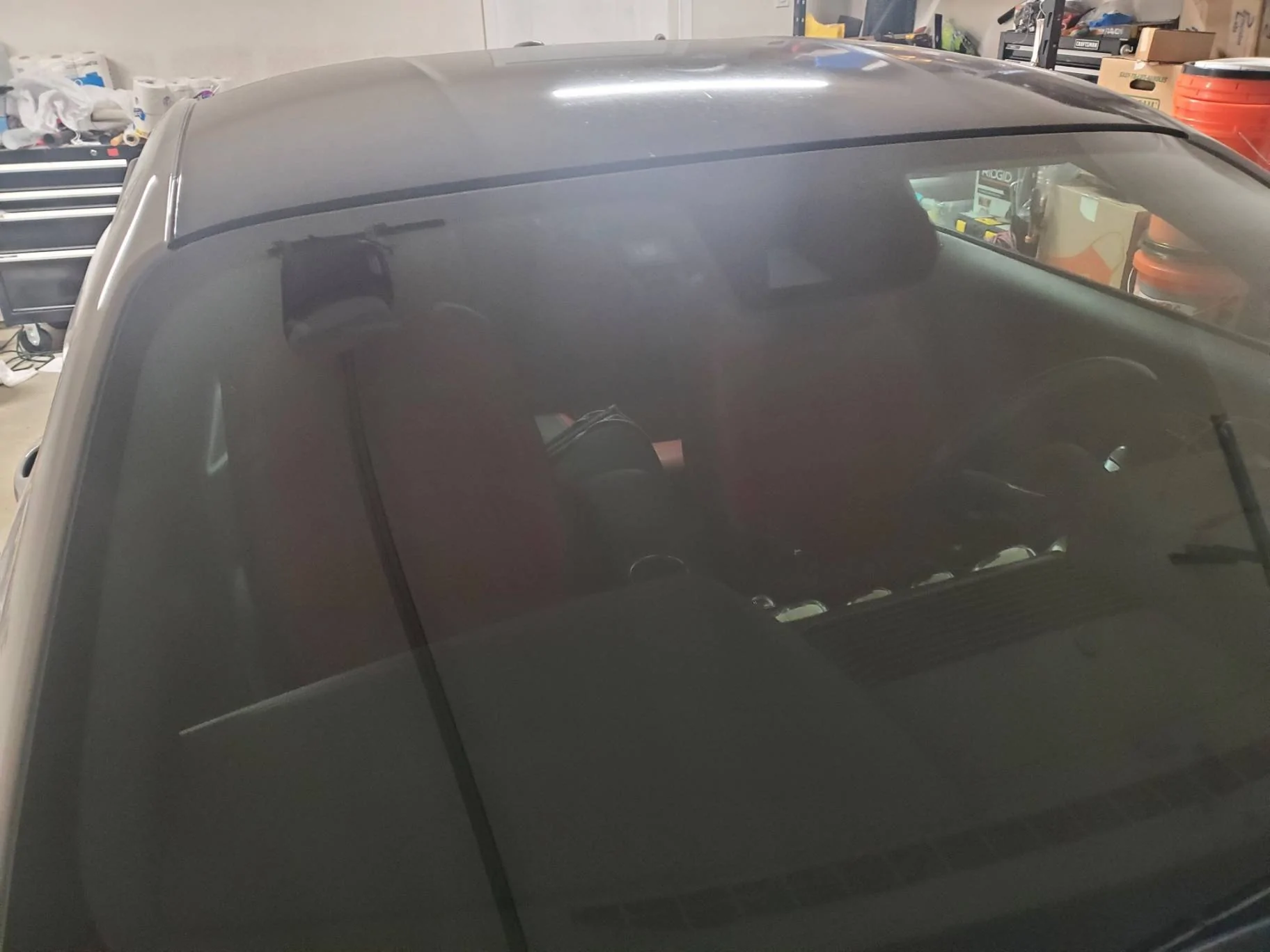

If you're still looking for suggestions, here's my setup:
Street Guardian SG9663DCPRO+ (I have the older model with the wedge back camera). I attached it to the passenger's side so that it wouldn't be in my way when I drive. For the previous cars that I used the dashcam in I was able to put it on the driver's side but here it just took up too much windshield real estate.
Front:

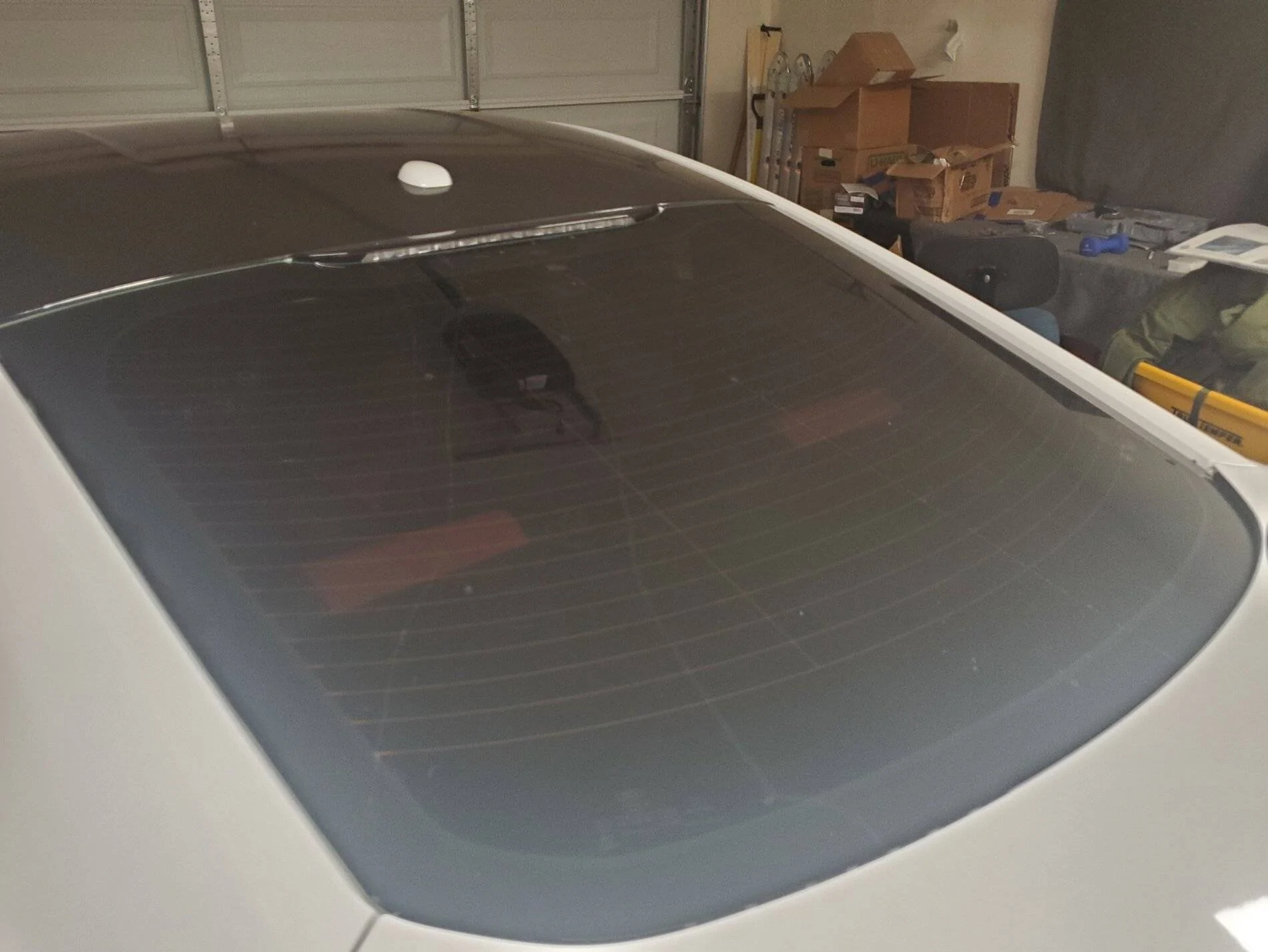

Back:

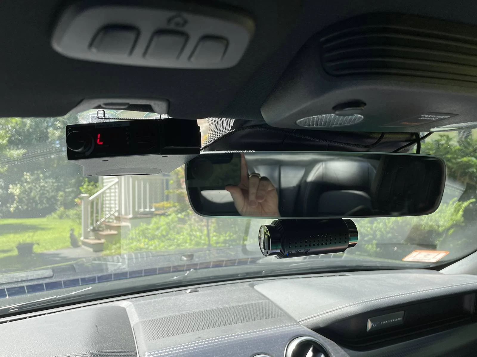

Mine has been to the right of the S&S block, but I'm trying it here. If the unit can keep a solid GPS signal, I'll leave it here, move the V1 over to the right side of the package, and conceal the wires.

How do you have that V1 mounted? You're not getting the Gen2?

Standard suction cup to the windshield, power from a mirror tap.
I've thought about the Gen2, but the Gen1 works well in my area (local cops with always-on radar, state cops with laser). The trade-in value is pretty low, so I just keep "forgetting" to do the upgrade.

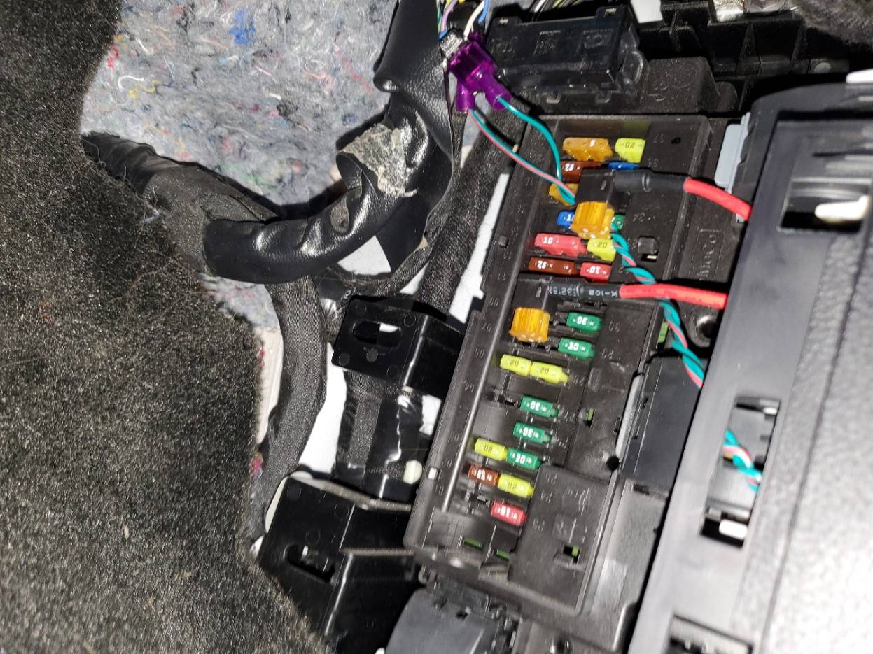

I used the fusebox on the passenger's side. I had 3 wires for my cam:
  1. Ground
  2. 12v Constant
  3. 12V Auxiliary/Car Started

Thanks. Did you use fuse taps or tap the wires themselves?

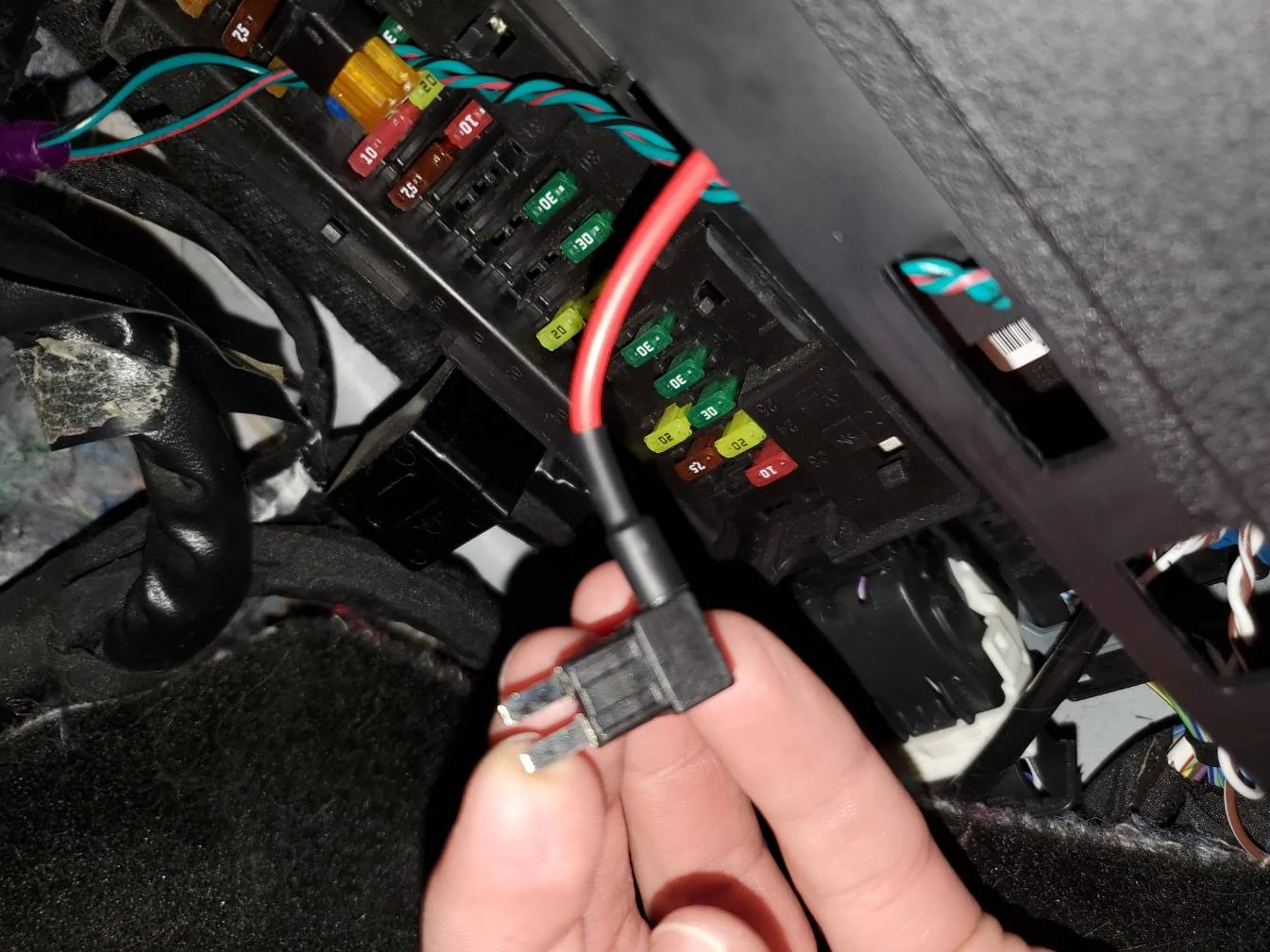

I used a fuse tap.
This is the last one I purchased but I'm not sure if it's the one that is in my Mustang. I'll take a picture of whatever is in my car and upload it later today.
If someone knows the style feel free to comment. I I recall I had problems using the fuse-tap in the style of the fuses in the car.

Here's a pic of what's in my car. It looks like the fuse tap that I linked above.
Also to take your fuse panel off; you need to lift it up before you can pull it out.
