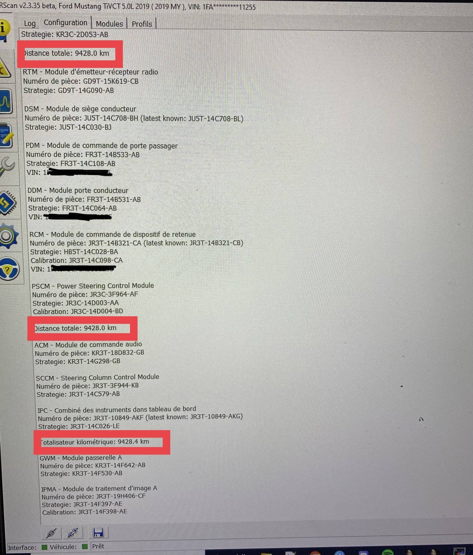

I have found a page on forscan displaying the mileage for each module (if available), on my 2019 it's stored on 5 differents modules (IPC, ABS, PCM, C-CM, PSCM)
I will try to connect to his 2013 to see. I don't think there is that much modules, but maybe in IPC, PCM and ABS/PSCM
I also wonder if modules syncs between each others. I don't think so, it wouldn't be logic if Ford wants to check mileage diferences.

I checked his car with forscan and it gives me the same value in IPC and PCM. There is also a DTC U0401:81-48 Wrong data received from PCM.
Weird, I don't know if modules syncs between each others
