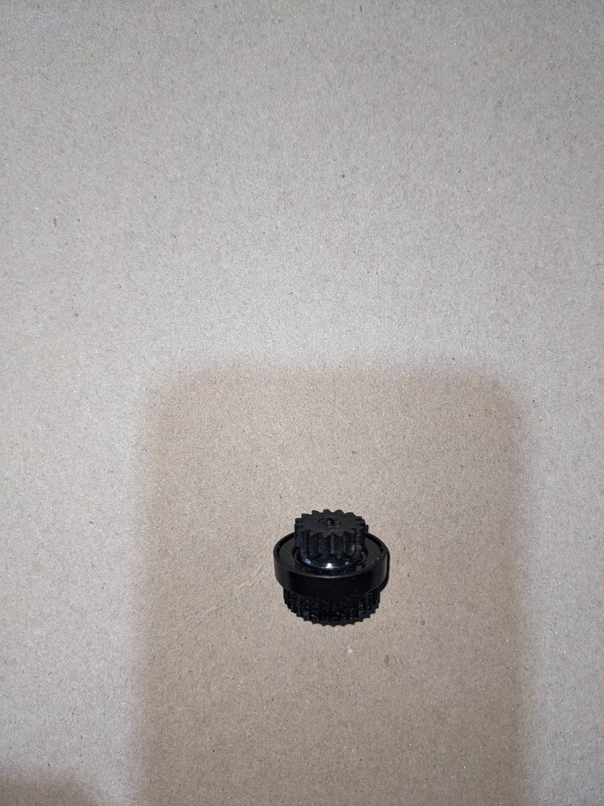

Last time I changed my cabin air filter on my '18 this plastic cog dropped to the floor. I suspect it may be for a soft open/close but cannot work out where it fits. Can anyone help out.

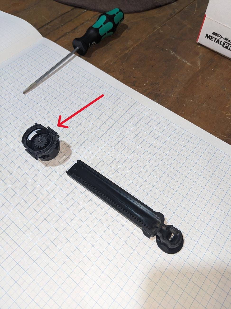

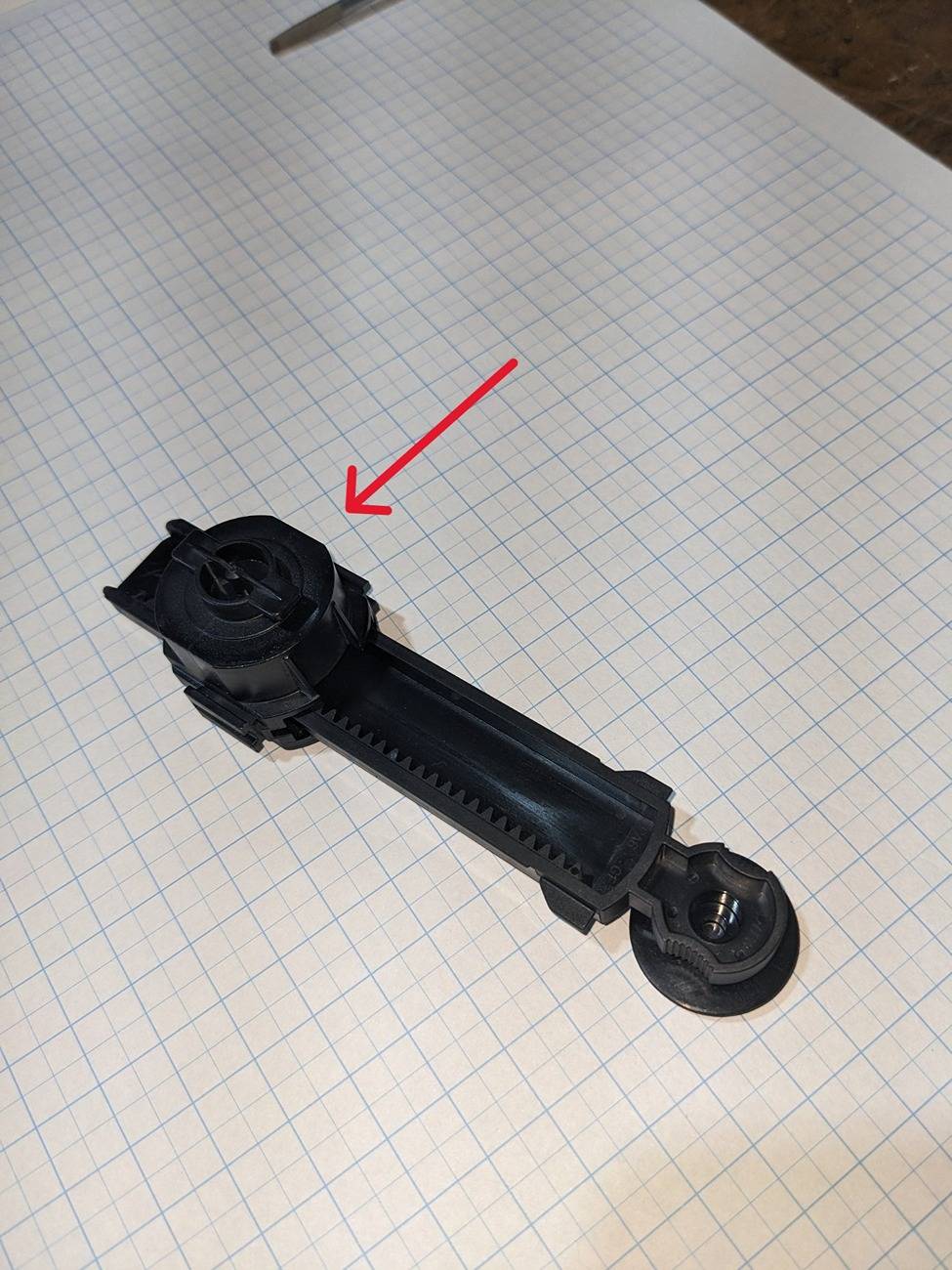

I found where the plastic cog goes. It is enclosed in the support arm. As MiamiGT350 said, you have to take the arm off and pry open the rear housing (red arrow in photo) to fit. The small cog sits in the arm's track.
Beats me how it came out in the first place.
