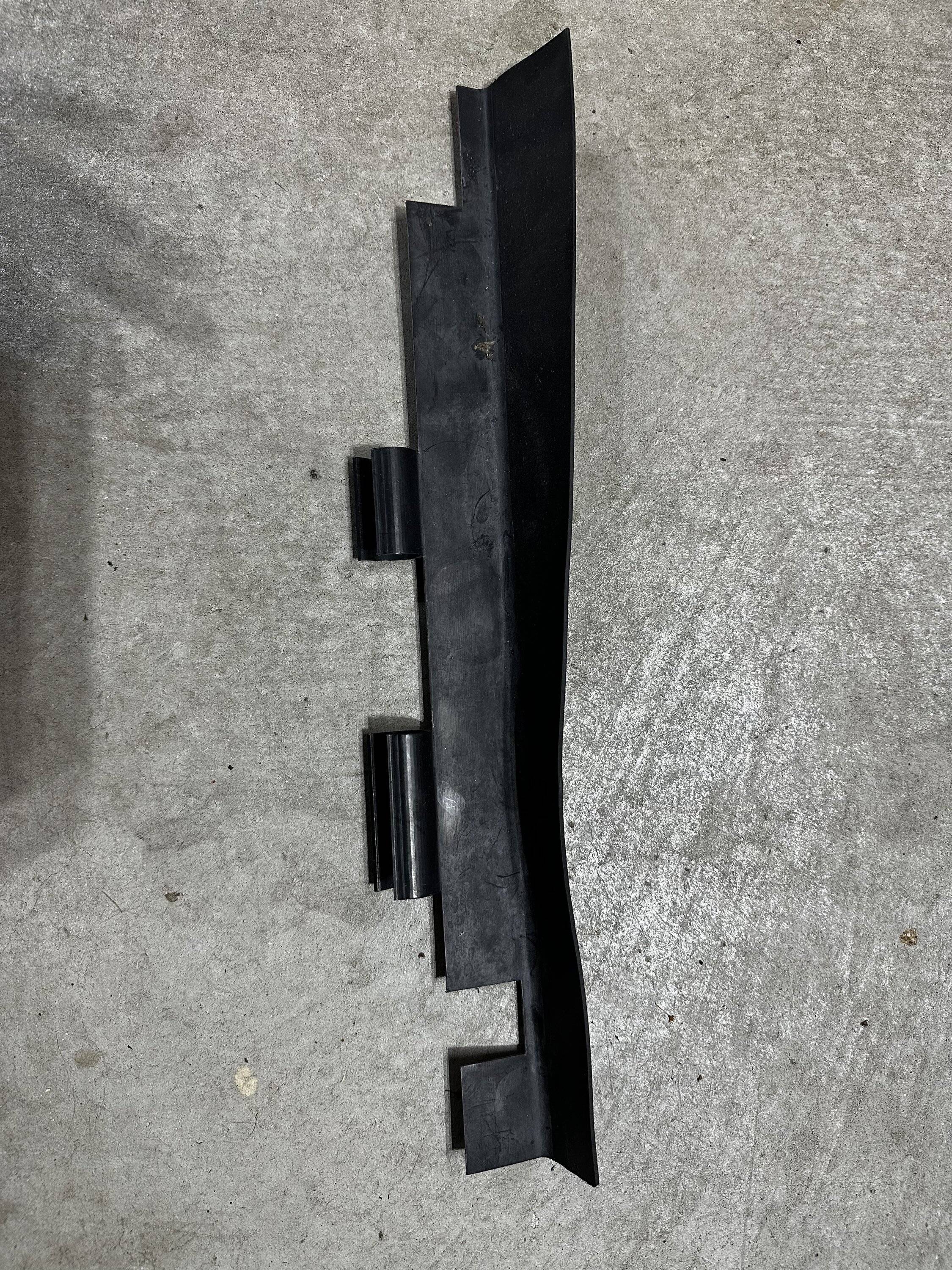

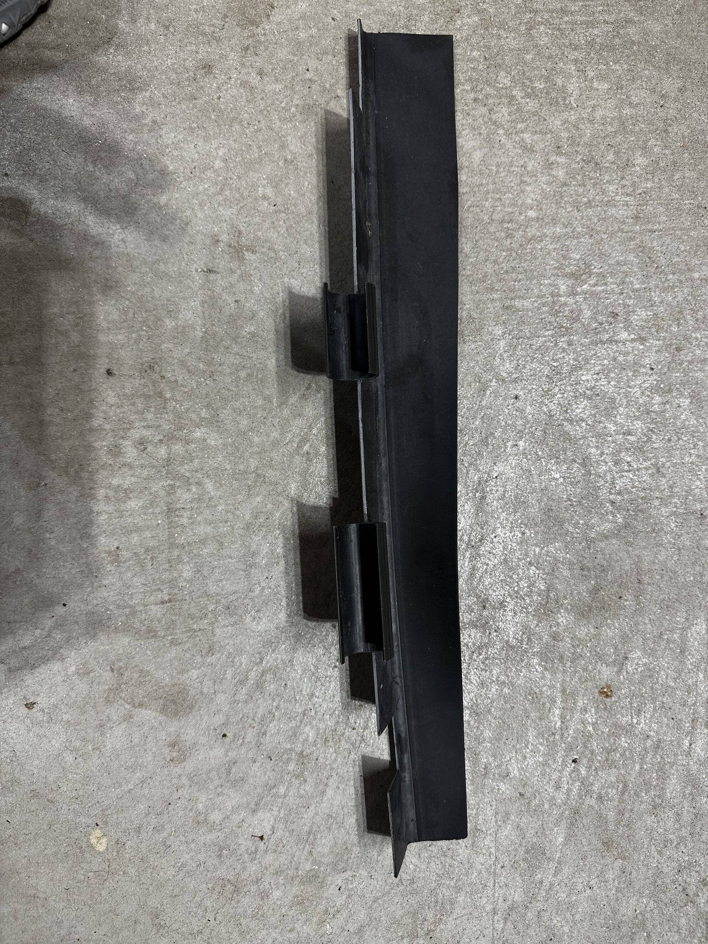

I recently opened the belly pan on my 2019 Bullitt. The part in the photos fell out when I took the pan down. I have no idea where it goes. Anyone have an idea where it might go?

I believe it clips onto the AC condenser, and helps force air through the condenser and radiator

It goes on the side of the condenser. There's one on each side and it helps direct airflow. Since it has the cut outs, I think it goes on the passenger side.

Thanks guys. That’s helpful. I’ll take a look at that when I get a few minutes.
