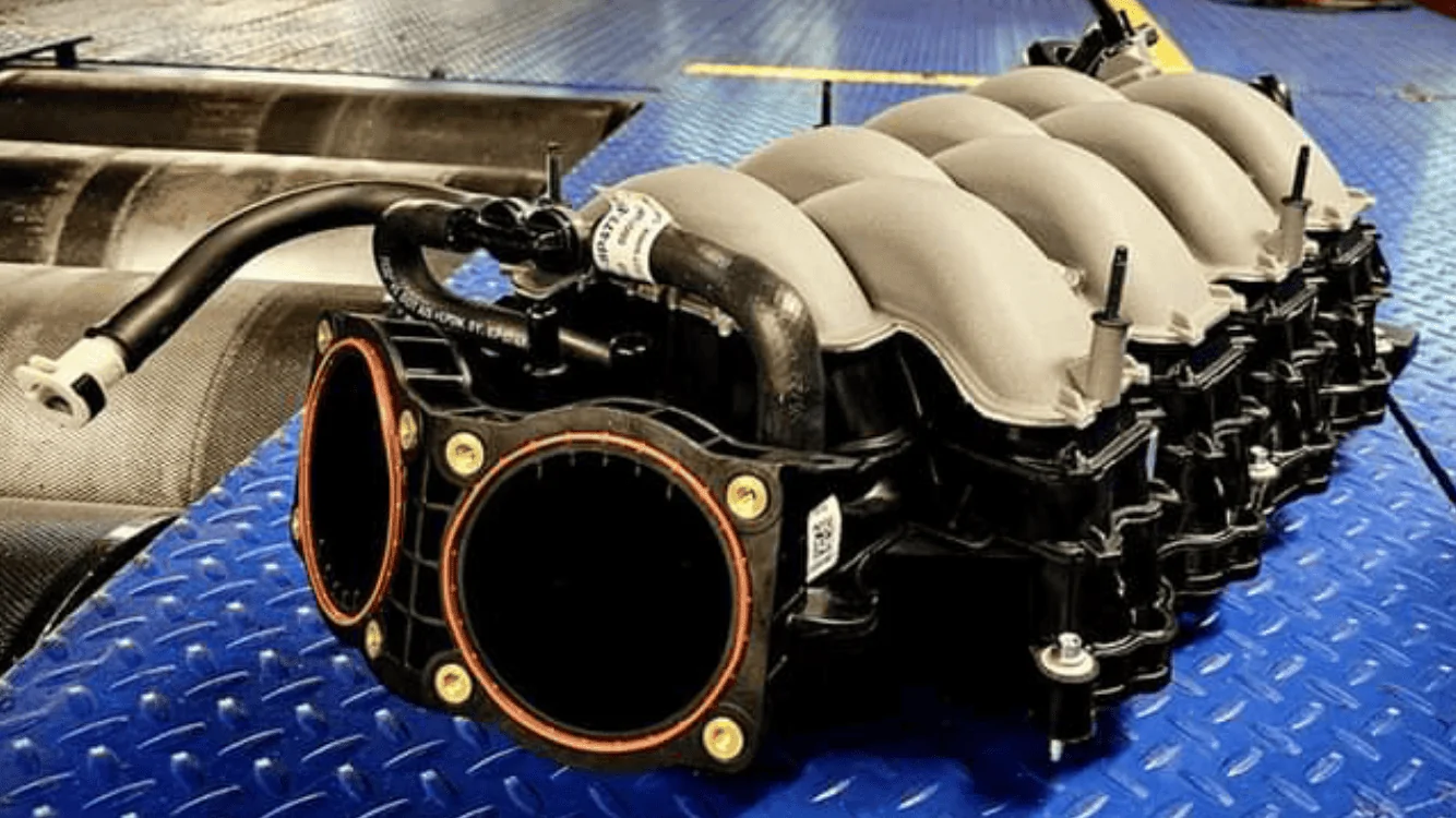

The reason I am looking into it is that Ford engineers have stated that a bigger throttle body was a main reason they started the development of the cobra jet. The new s650 mustangs also use more throttle body.
My car has stage 3 N/A cams and higher compression. I am going to fully port the inside of a boss302 and add a spacer to increase plenum volume aka a "poor mans cj". Then to support the manifold I am looking into bigger throttle bodies.
