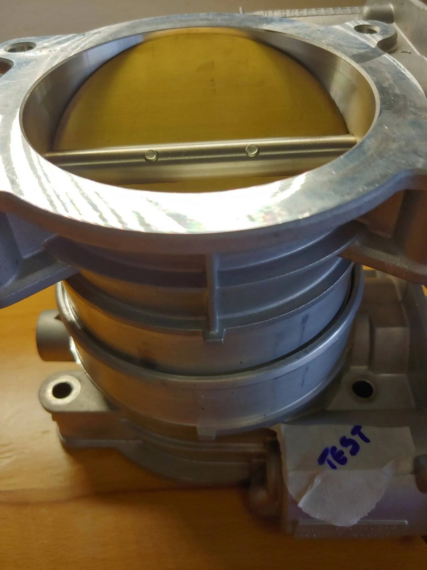

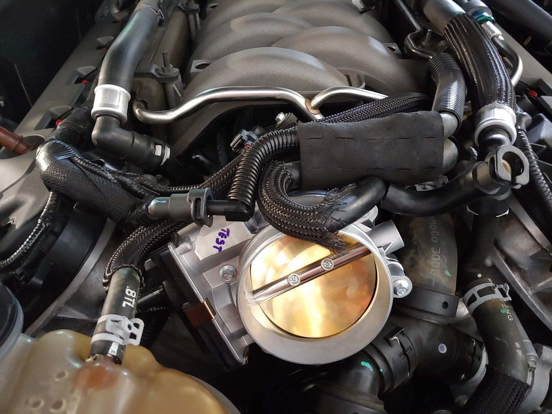

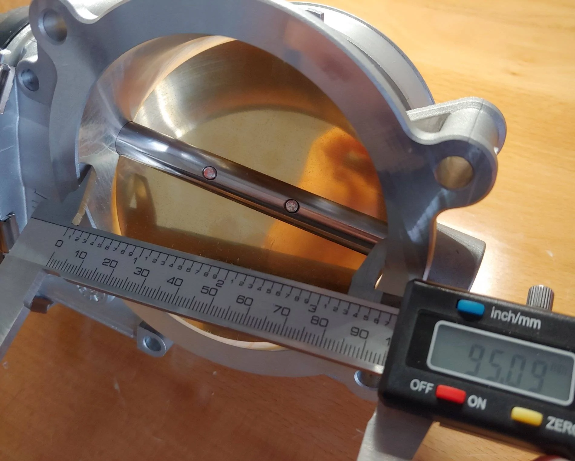

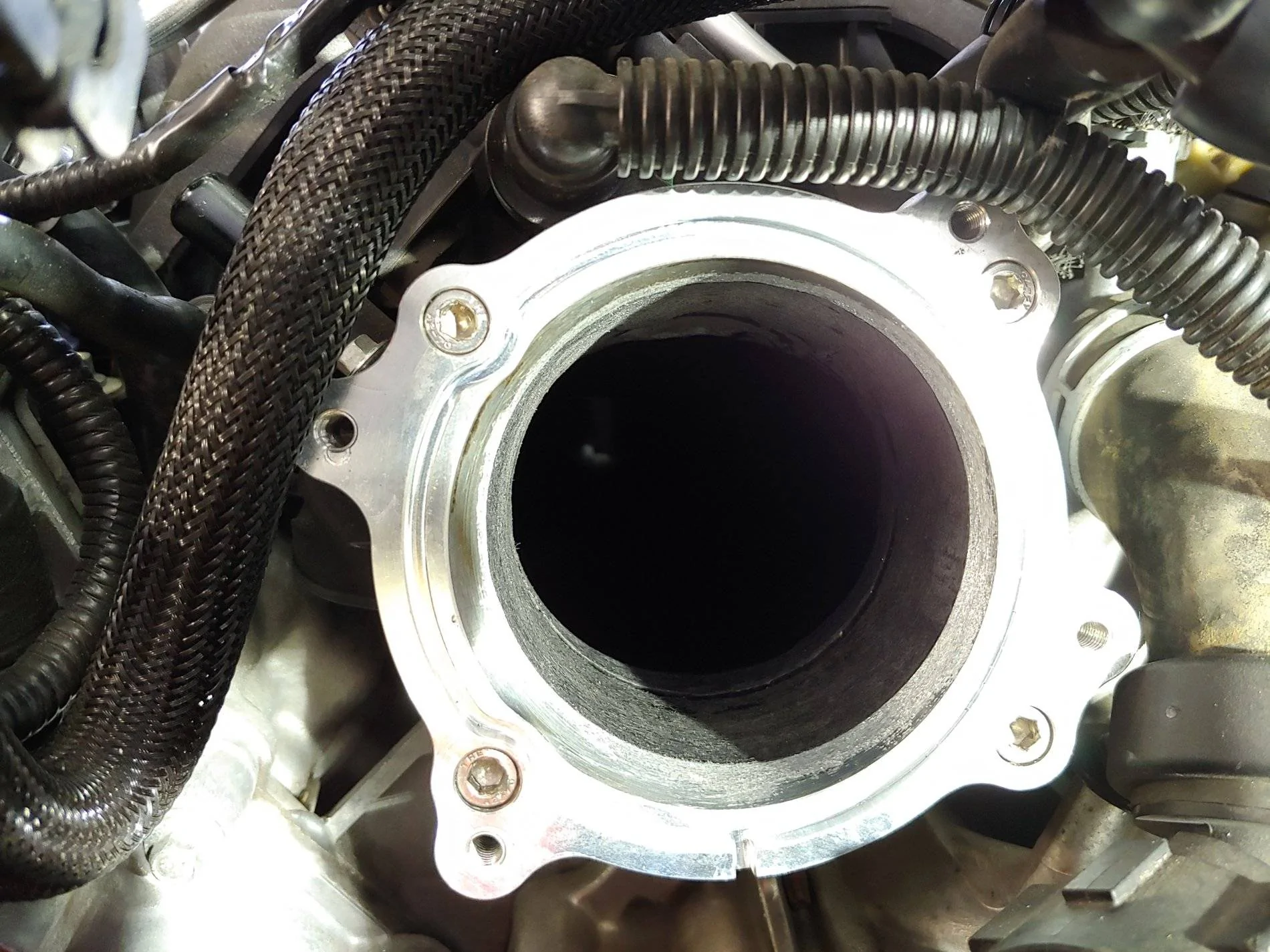

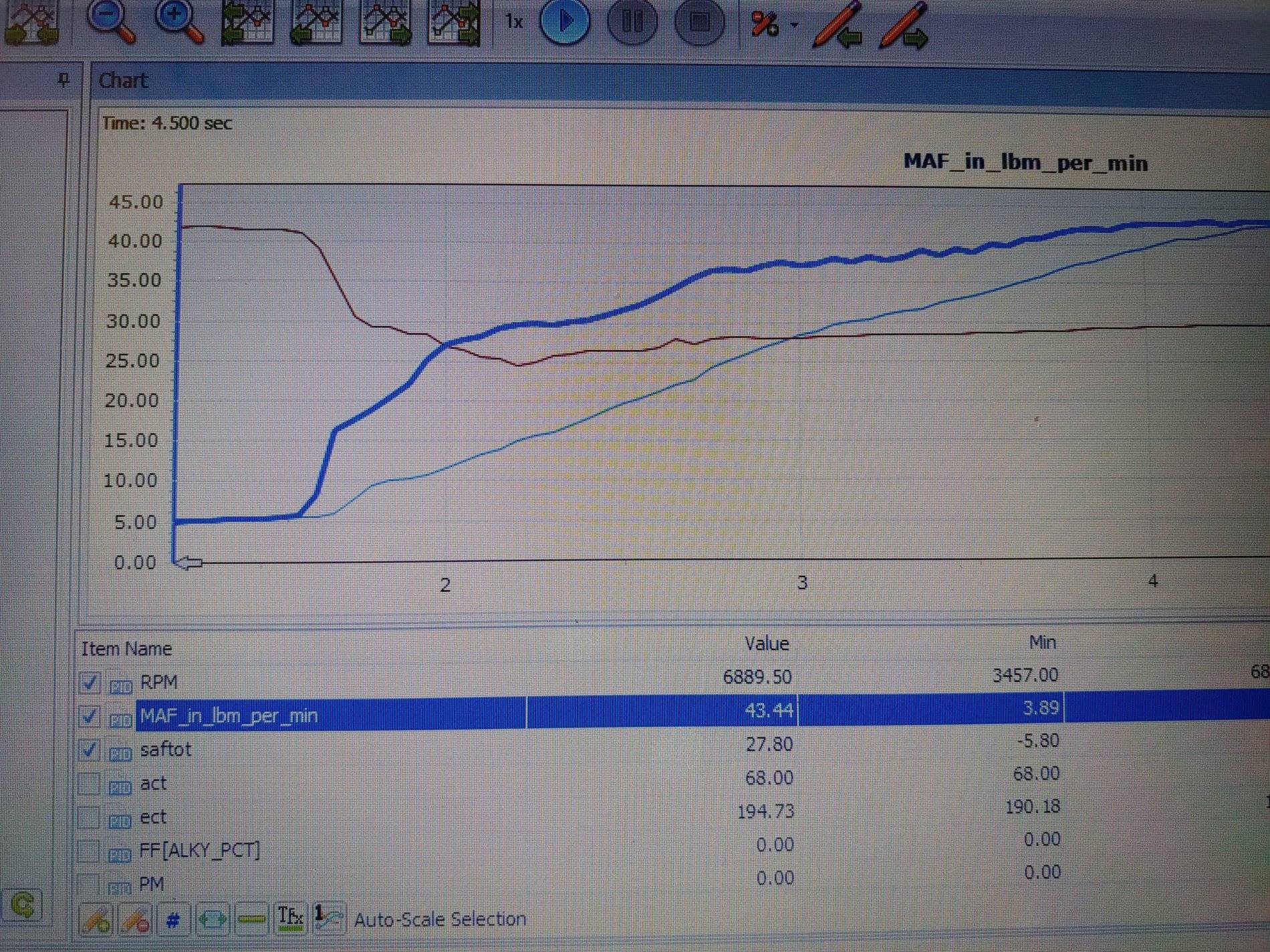

I have a 2016 GT with PP2. Otherwise its mostly stock save for Roush Mufflers.
I ported and modified the inlet and swapped out the GT350 TB for a custom 95mm TB. It was a bit of work to get it all working...BUT it does drive amazing with the PP2 tune. Logs also show a MAF lb increase from 42.5 - 42.6 range, to now 43 - 43.5. Not much gain...but I am simply preparing for a highly modded 2018 IM. I have a theory that the ported 18 IM is severely restricted with the stock 80mm TB that everyone uses. We shall see how it plays out. :)
The Coyote's OEM 80mm TB flows 927 CFM.
AFS modded OEM 80mm TB flows 1177 CFM retaining the OEM sized blade / aperture.
Personally I don't see the 80mm TB creating restrictions with the CFM's listed.
AFS modded OEM 80mm TB flows 1177 CFM retaining the OEM sized blade and aperture.
Thankfully Ford doesn't agree and they blessed us with the Cobra Jet manifold that has a larger throttle body opening. :)

Nothing against Brett, I love his work and have spent thousands with him. But the problem with that example is that one, he sells port work and two, you can't compare Apples to Oranges.
What was the CFM requirement for the engines you or him have tested? Was VE the same? Was a similarly comparable "system" tested with an 85+mm TB? IE; 120mm+ larger CAI with proper air filter and port/shape work on the TB *and* the manifold inlets modified to be similar in size comparison? Was the same ported 87.04mm IM opening used for both TB tests?
What I have found is just because a calculator says you need XXXX cfm doesn't mean that going more won't gain power. My cars have always shown a power increase from opening up the inlet side even when a calculator says otherwise.
The OP has a 15-17....What is the CFM of his stock IM? It must be MUCH less than what the engine requires...since any offering available will improve his power output significantly. ;)

Also not sure if you caught my post earlier. With only swapping from a ported GT350 TB to a non ported 95mm TB...no other changes at all, my MAF flow increased a bit. Back to back testing within 45 minutes. That's with a mostly stock vehicle. I wasn't expecting any flow increase to be honest. Based on my testing results on previous S550s, my car is seeing around 5 more horsepower now. Not a big deal, but very promising for what I have planned.
I'll let you folks continue. I'll be back eventually with some additional information and results as I get them.
