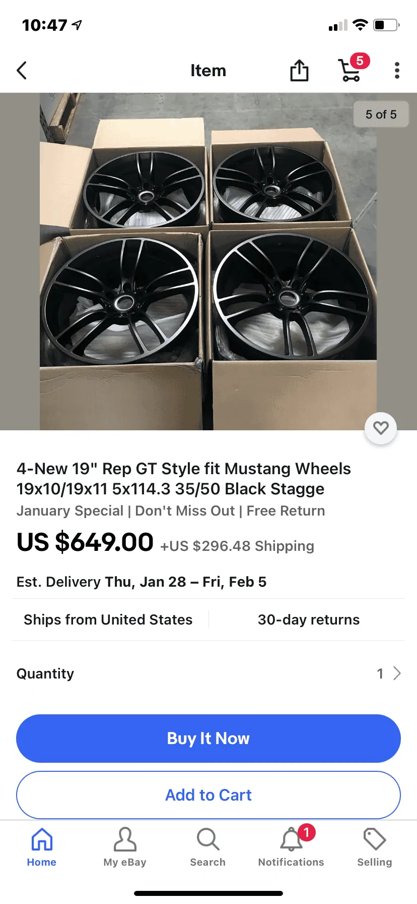

Anyone has or saw these wheels on eBay? Wanted to know if they are any good? Are the offset 35 front and 50 correct ?

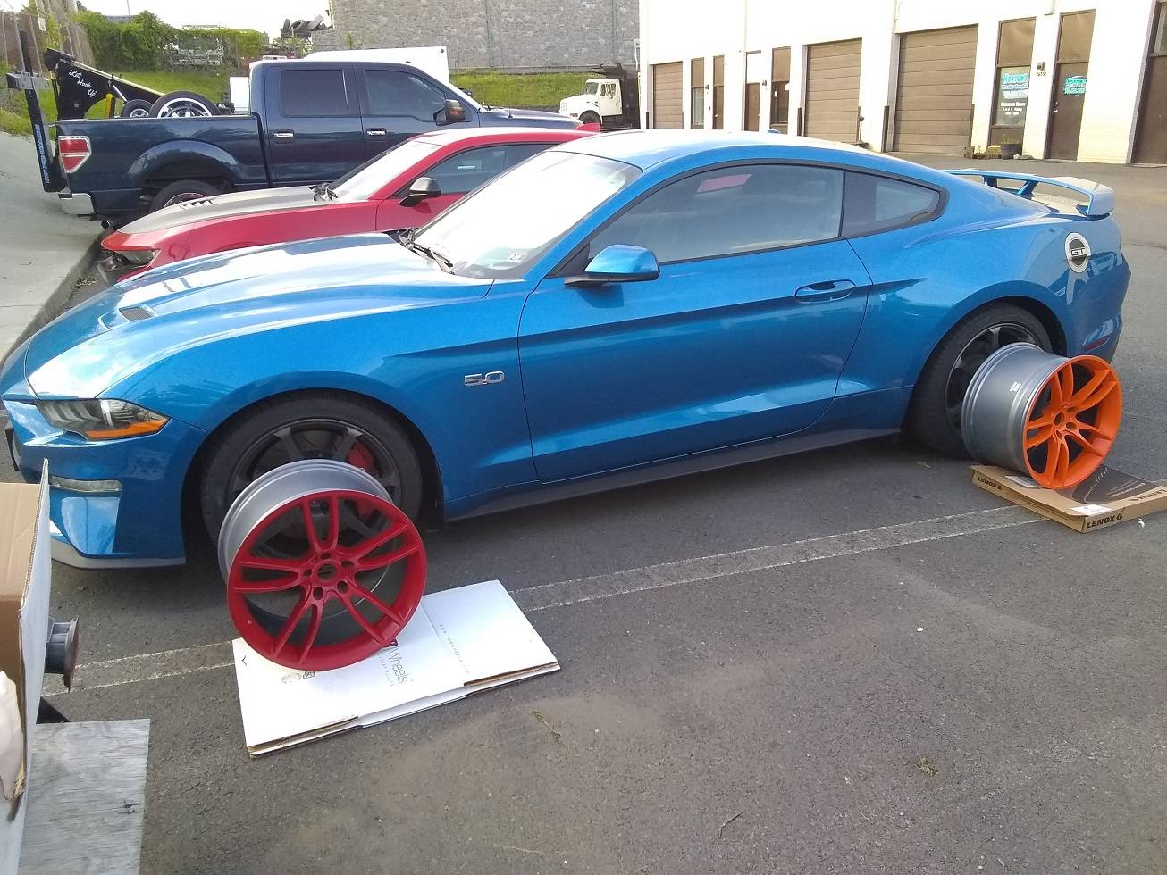

Those are either MRR M600 or LMR's SVE-branded clone. I have a couple sets of them in Gunmetal. One set is still new in box (19x10/11) and another set in 20x11 in bronze. Ouch that shipping.
I colorized one set with Plasti-dip.
more here

How about a link to the wheels so that we can look at the description. The picture tells us nothing other than they look nice.

Thanks for the info.. I heard the p51 are slightly more concave then these

Would they fit over PP1 brakes and take 255/40 on the front 10" and 275/40 on the 11" rear?
asking for a friend :)
yes they clear the Brembo's by a mile. Those tires would be at their limit on stretch but yes they'll fit - check tirerack's specs page to confirm. Better would be 275/40 or 285/35 front, 295-305 on the rears. So use your current rear tires on the front rims and buy yourself 2 new rear tires.

yes they clear the Brembo's by a mile. Those tires would be at their limit on stretch but yes they'll fit. Better would be 275/40 or 285/35 front, 295-305 on the rears.
That was the plan, use my existing PS4s until they are dead then next tires go for 275 front and 305 rear assuming no rubbing.
edit just read the rest of your post, thats a better idea
Do you think the rear 19x11 would also clear Brembos on the front of a Mustang GT, with a spacer presumably?
Price seems good, no?
price is normally 350 each, this is half price. The LMR clones are gone. I use 19x11et24 on the front. Since these are et50 you'll need a 25mm spacer and extended studs.

those are the genuine article - from MRR, not the knock-offs from LMR. Get a pic of the label on the box to be sure, but if AspireMotoring (my go-to vendor) is also selling them, they are MRR. Probably the very last left in the country.
How can you tell they are MRRs just from that?
For $650 brand new I'd highly doubt they are genuine MRRs, don't those go for $1500+?
