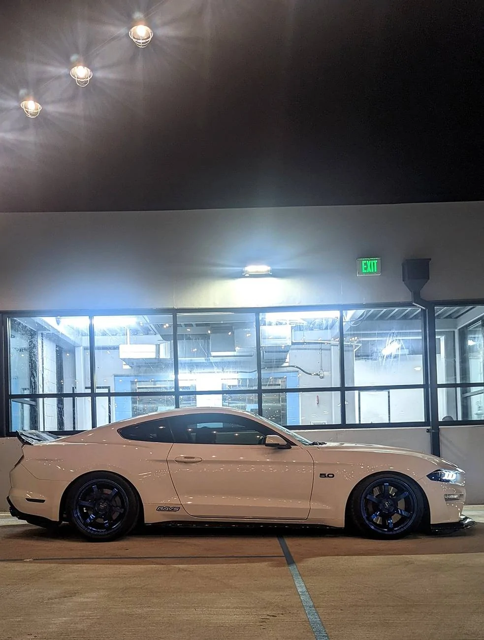

Esr??? Which spec are they??idk if mine counts but here it is....

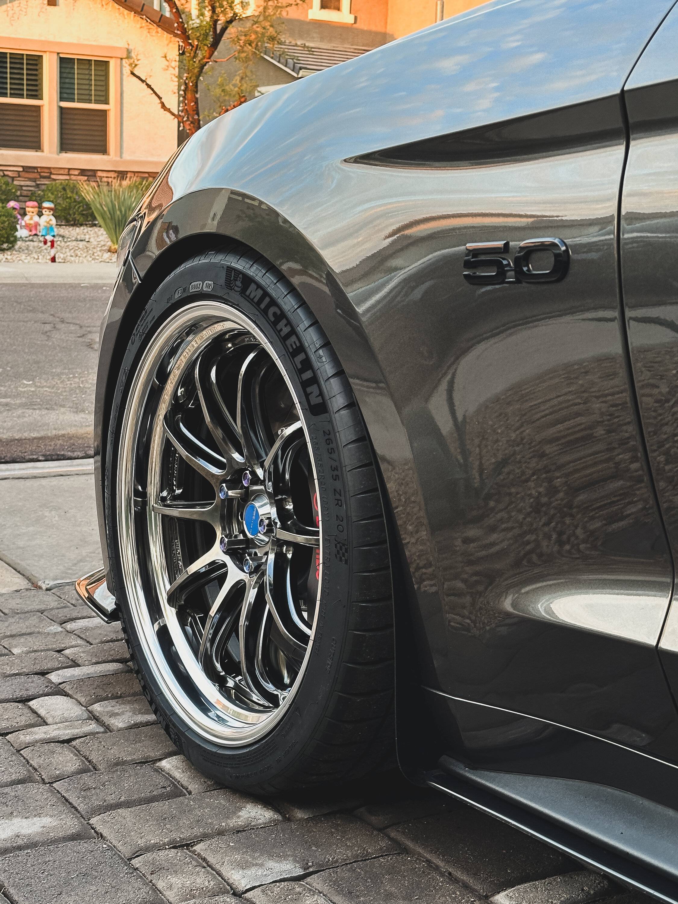

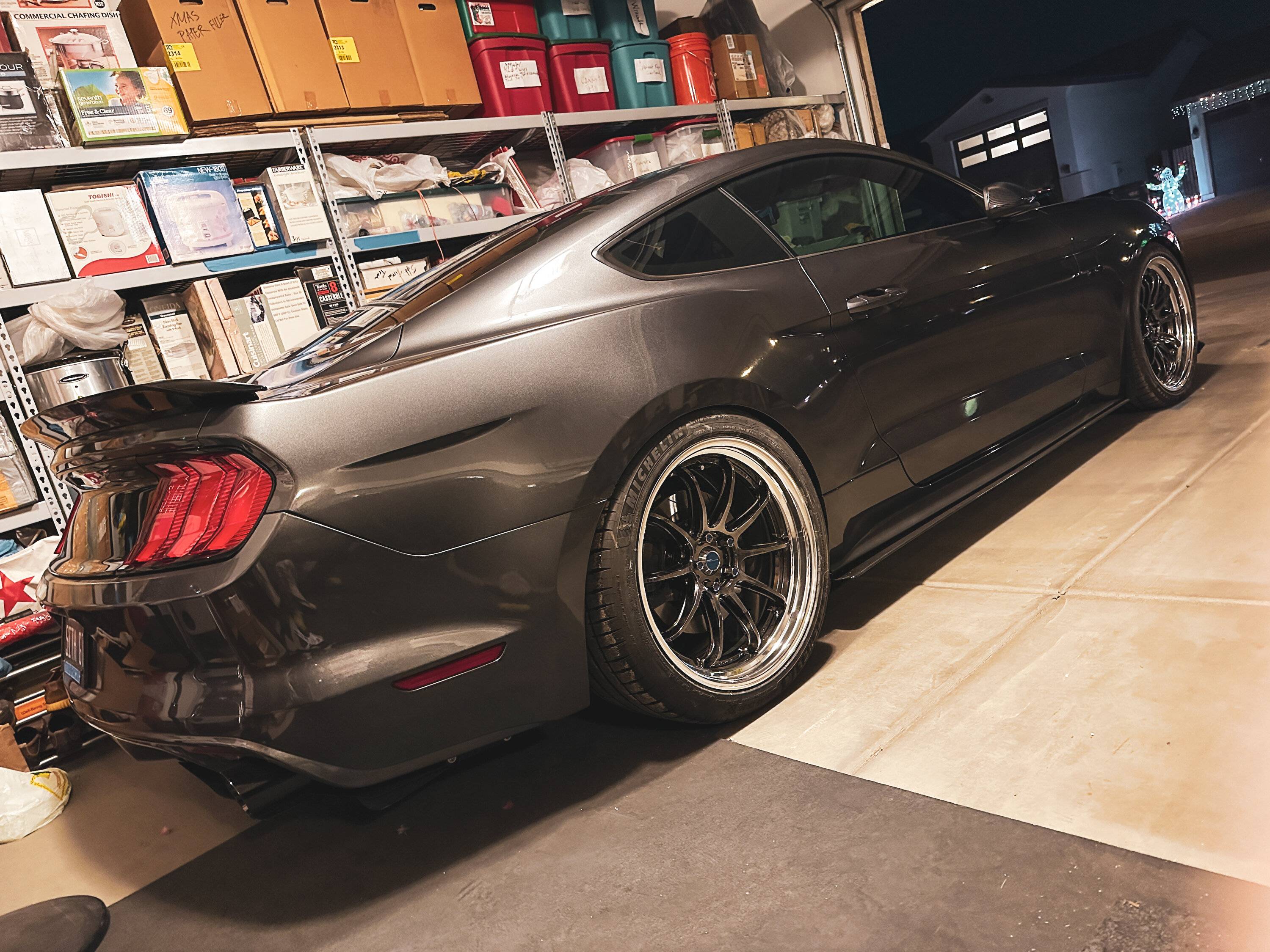

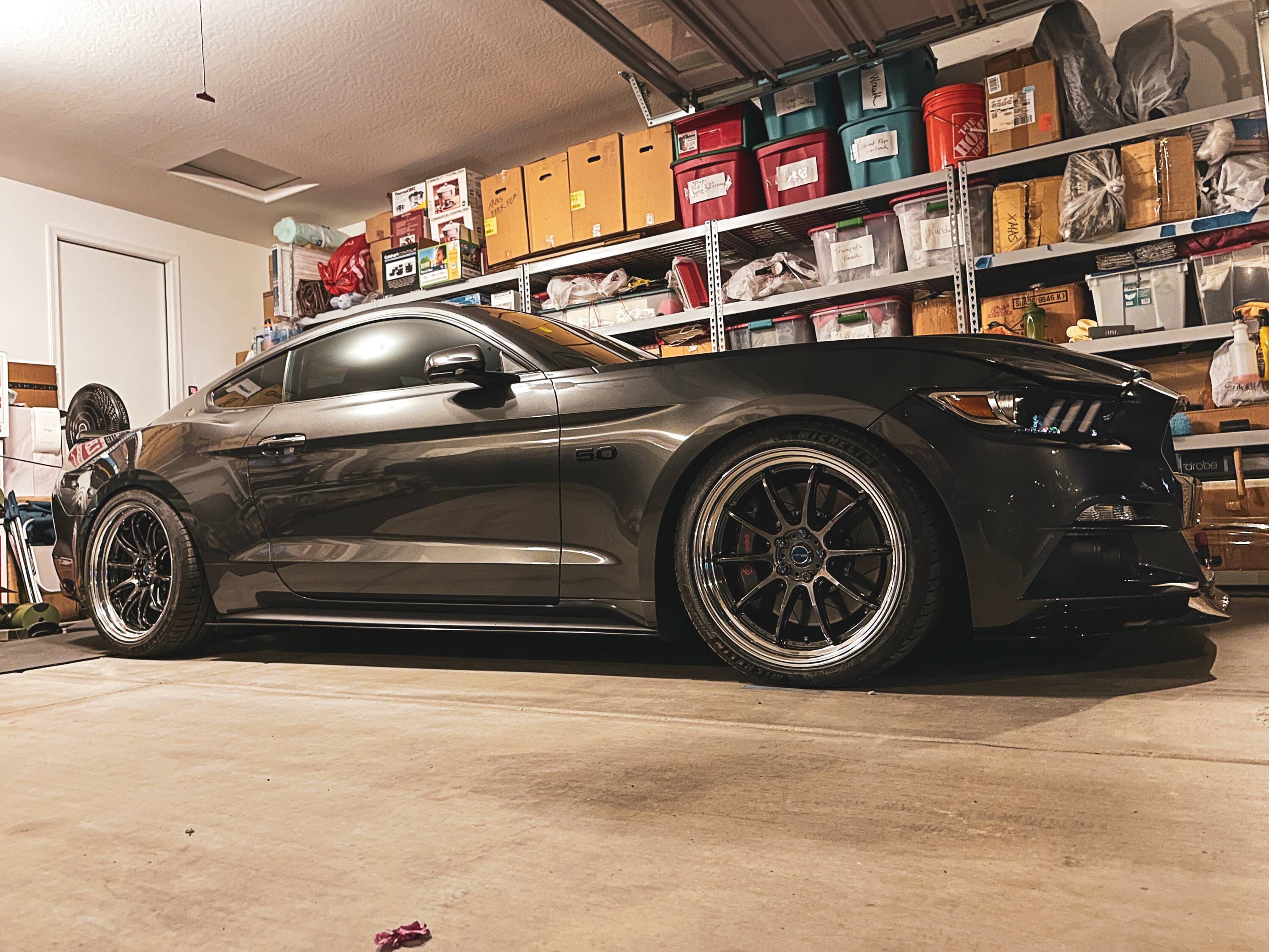

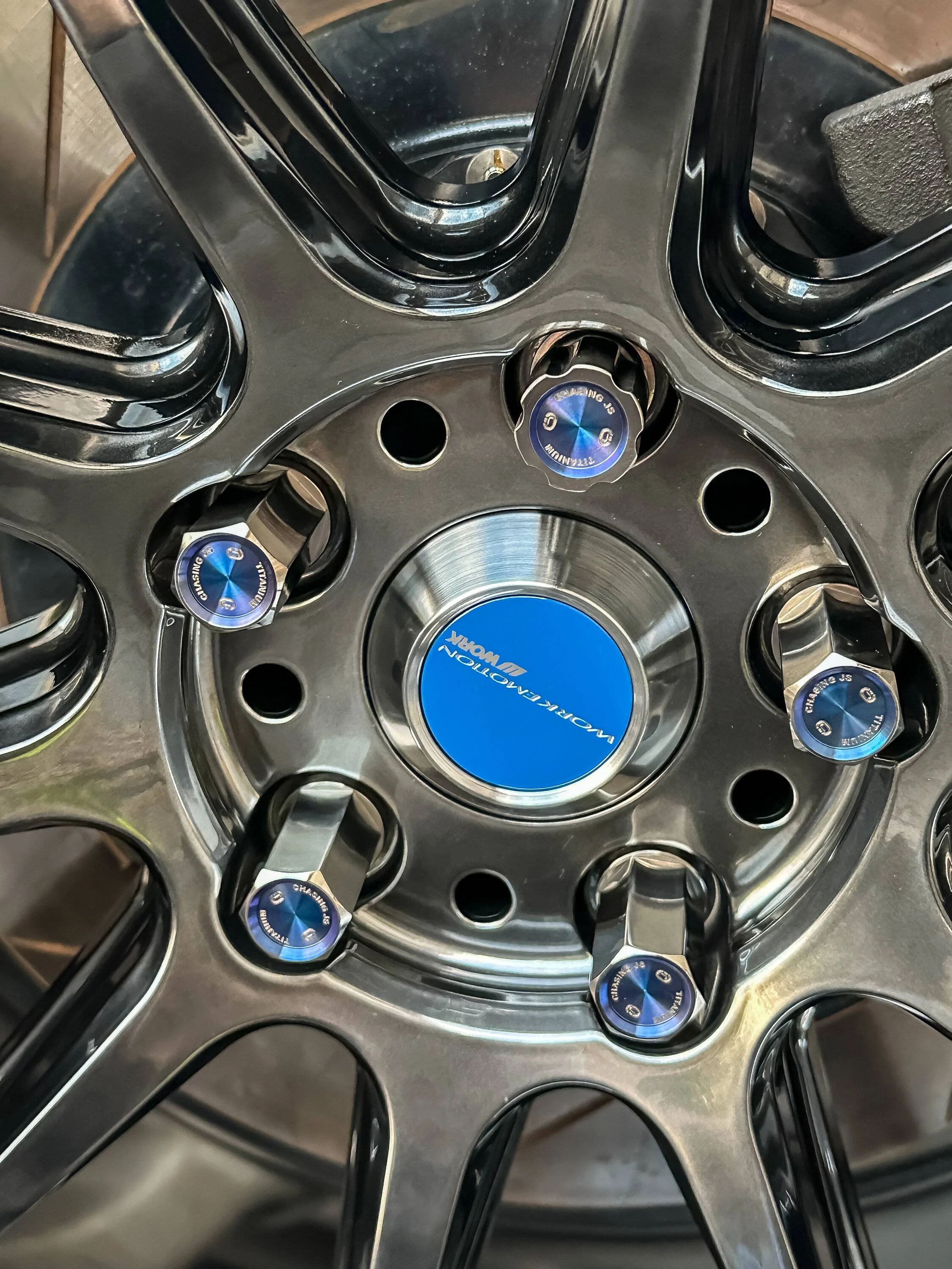

He returns!Staggered 20” Work Zr10 2P x Chasing Js Ghost Sapphire Titanium lug nuts.

Here’s some dusty ass tire pics that I shared on IG a while back. Happy Festivus! See y’all next year!

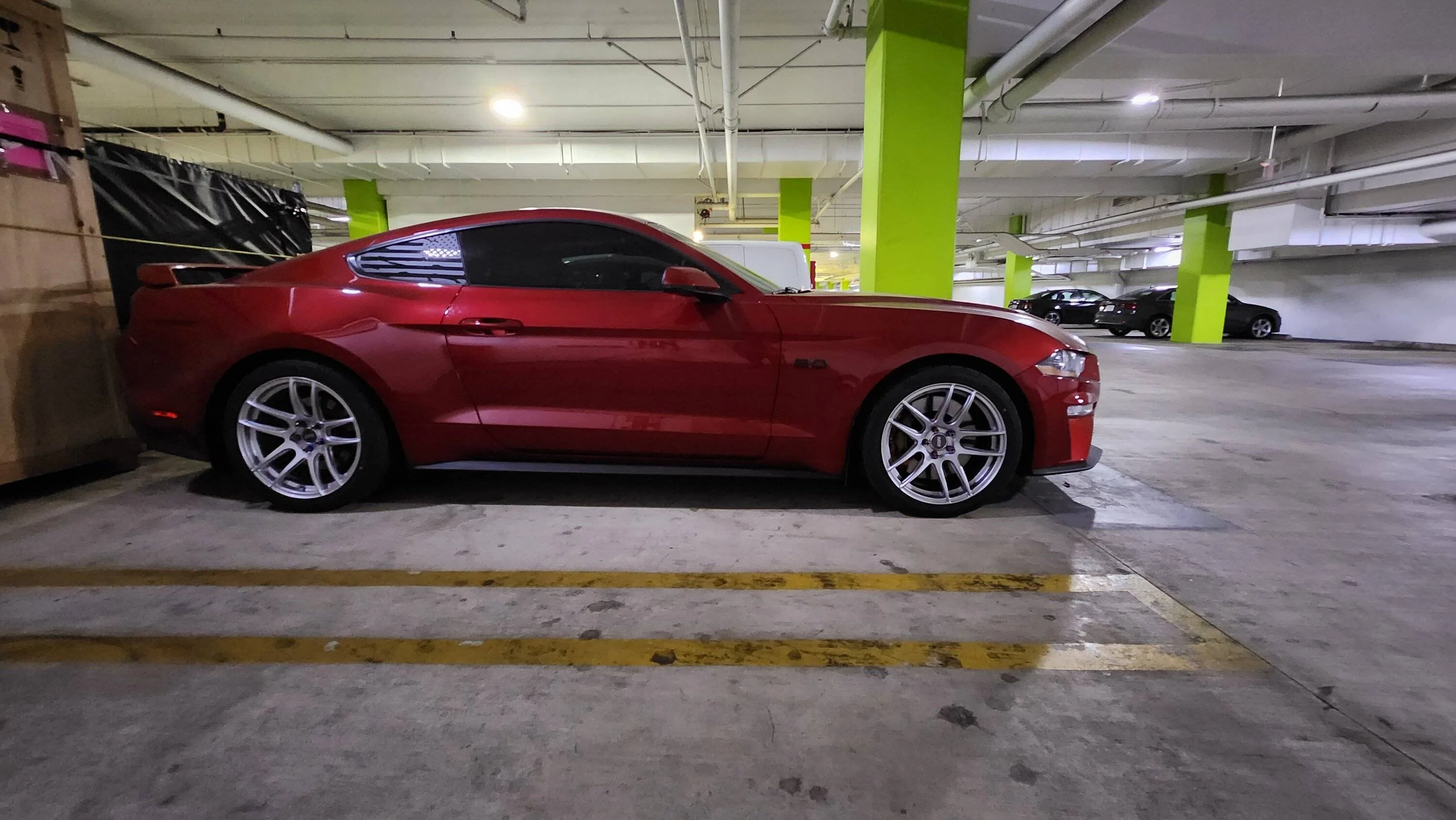

im running squared cs8 19x9.5 et35 with 5mm hub centric slip on spacers in front. tires are yokohama advan apex v601 in 285/35/r19.Esr??? Which spec are they??
Those look awesome! What are the specs front and rear? ThanksStaggered 20” Work Zr10 2P in Glim black face/ polished lip x Chasing Js Ghost Sapphire Titanium lug nuts.
Hi!im running squared cs8 19x9.5 et35 with 5mm hub centric slip on spacers in front. tires are yokohama advan apex v601 in 285/35/r19.
i read a bunch of various opinions on the matter. i recommend checking the manufacturer website for the tire specs and going with what is recommended. i think the yokohama's in 285/35/19 fit 9.5 width perfectly, which is also what the manufacturer specs suggest as the limit. overall the tires feel and ride like stock, but the car definitely handles a lot more balanced/neutral running squared when compared to the staggered pp1 wheels.Hi!
I'm also running a 19×9.5 square setup with a +30 offset, no spacers. The poke is perfect on the rear and a bit tucked in the front, but not enough to use spacers. I wrapped them in 275/35s and find the fender gap to be a bit more than I'd like on stock GT suspension. Next set of tires will be either 275/40s or 285/35s like you have. But, it seems that 275 is the recommended upper limit on a 9.5 inch rim. How do the 285s feel/ handle/ ride on your car and what are your thoughts about 275 vs 285?
Thanks!
Good call on checking the tire mfg specs. Continental also calls out 9.5 as the minimum width for their 285/35 R19. Thx for the advice!i read a bunch of various opinions on the matter. i recommend checking the manufacturer website for the tire specs and going with what is recommended. i think the yokohama's in 285/35/19 fit 9.5 width perfectly, which is also what the manufacturer specs suggest as the limit. overall the tires feel and ride like stock, but the car definitely handles a lot more balanced/neutral running squared when compared to the staggered pp1 wheels.
