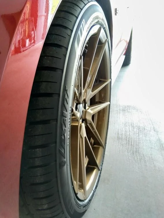

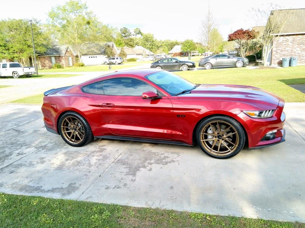

I would go with a +35 for the front.
+45 in the back is perfect. I have the same in the rear. With 305/35
If I wasn't going to lower it I would probably go with a 40 series tire. I think 35s are too small of a sidewall. LOL
This things rides so stiff.

Thanks.... Yours are +35 in the front? Can you share a front pic to see how it aligns with the fender?

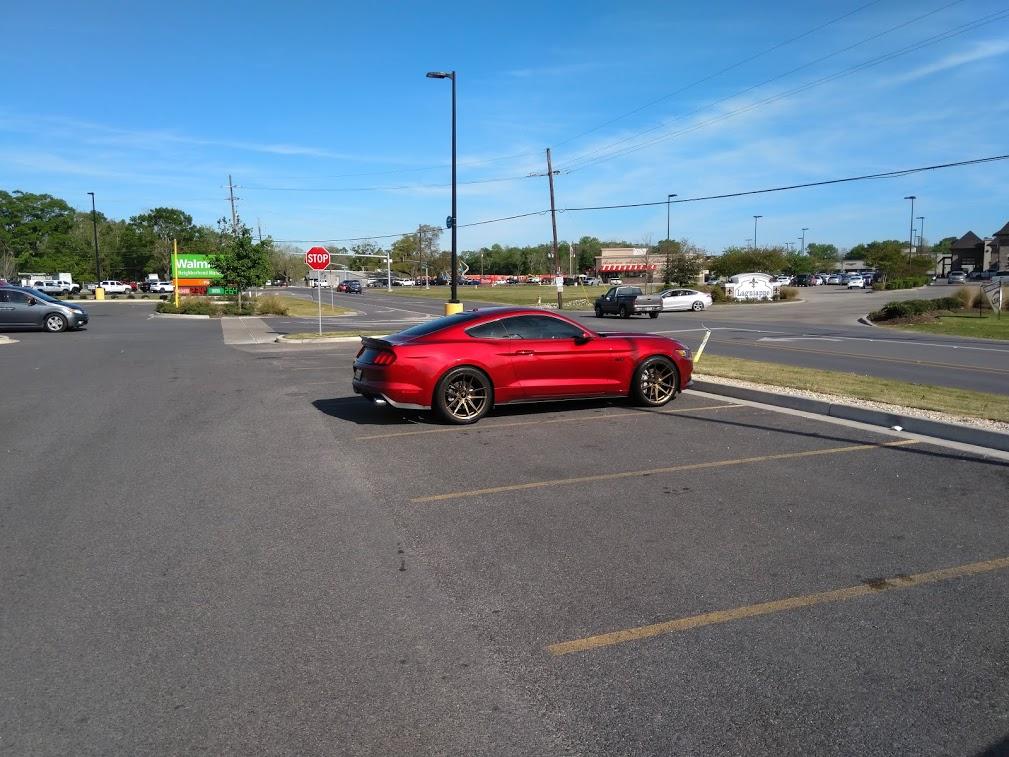

Ye +35 in front but on a 20x10" wheels 285/35
That's all I have right now. I can get more when I get home

Thanks. Appreciated. I don't know if it the pic but i see it a little poked on the front.
