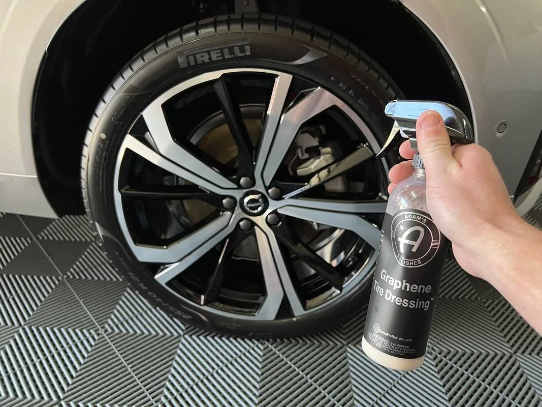

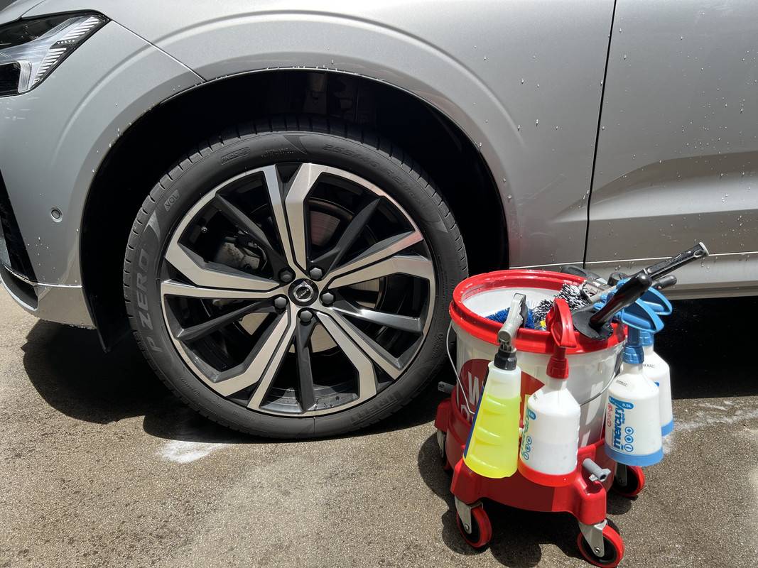

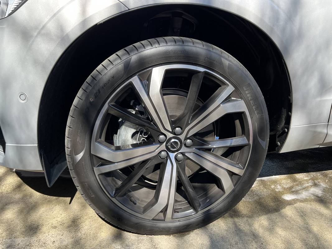

Having washed these last weekend, it's only fitting to make this week's post on the 21-inch 5-Double Spoke Black Diamond wheels on my sisters Volvo XC60 B6.
I really love the machined face set against the painted inner spokes. Cleaning wise, these wheels have a weird ledge that runs behind the spokes, which necessitates the need for a small wash mitt to get them properly clean behind the spokes and that ledge. The brake pads are also the typical euro dusty. This is basically the only car that I clean regularly that needs an iron remover wheel cleaner, which I use as a pre-treatment before contact washing with either foamed Brake Buster or soap. These Pirelli tyres are also receptive of different dressings, anything I put on them seems to look great.
Looks amazing :) . I recently got the Adams Graphene to try myself and I have used it once. I like it pretty good, seems durable although a little shiny for my taste even when I knock it back. KCx PSS is still my go to at the moment, although I want to try their Tire Glaze at some point, although with that name I bet it has the glazed donut look LOL :/

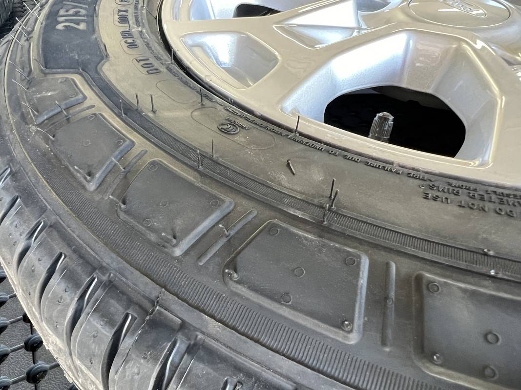

I could some tire cleaning advice. I have a brand new set of Conti ECS 02's on the car. I cannot seem to get the tire lube off of the side walls and out of the bead area. The discoloration of white and brown comes right back after they are dry. I don't want to apply a tire dressing to tires that I cannot get clean. Even multiple scrubbings with PS Brake buster doesn't touch it. I am thinking to try something harsher like a paint prep degreaser. Any thoughts?

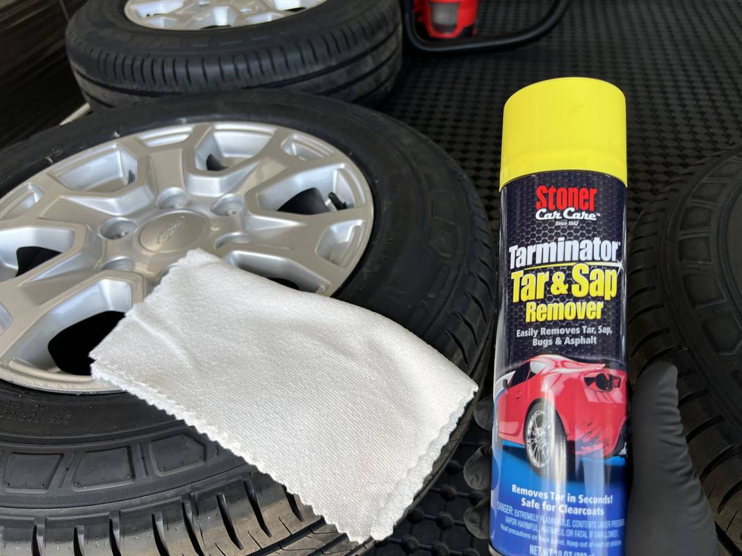

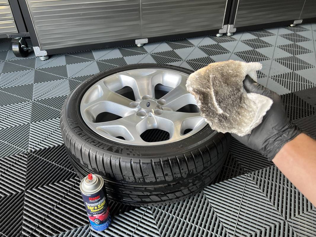

Brake Buster is great, but sometimes you need to break out the sledgehammer!

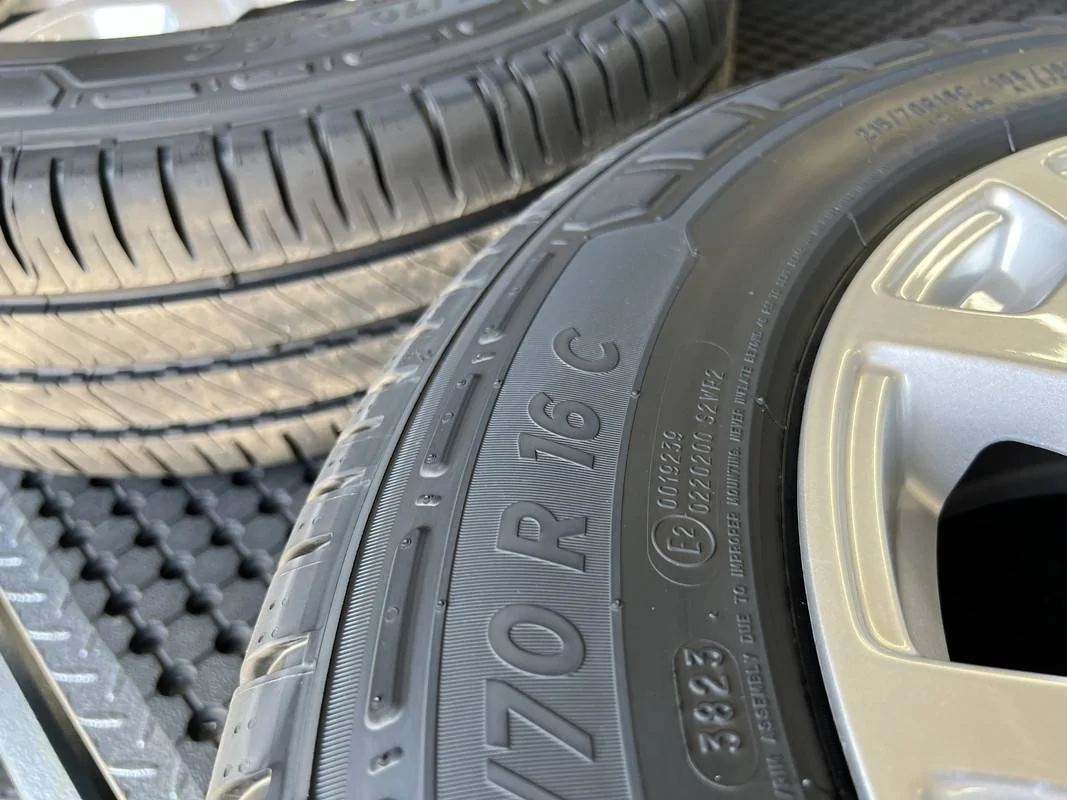

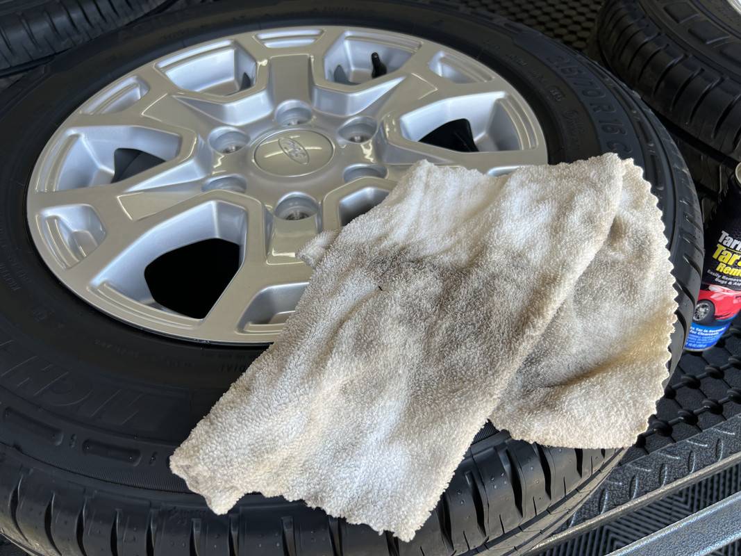

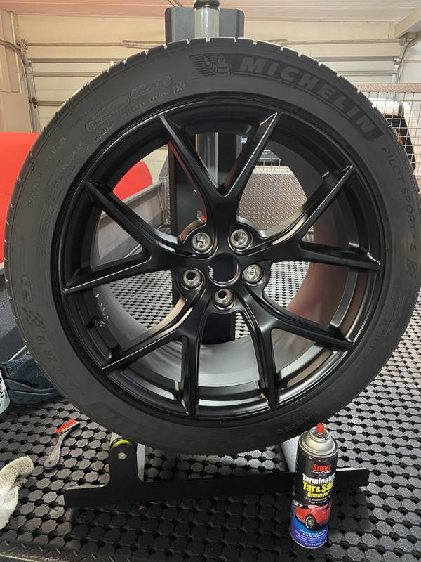

I have done this on a few sets of brand-new tires, as well as dealing with recalcitrant set of Michelin's that resist each and every normal tire cleaner on the market. The thing is, both of these products are off label.

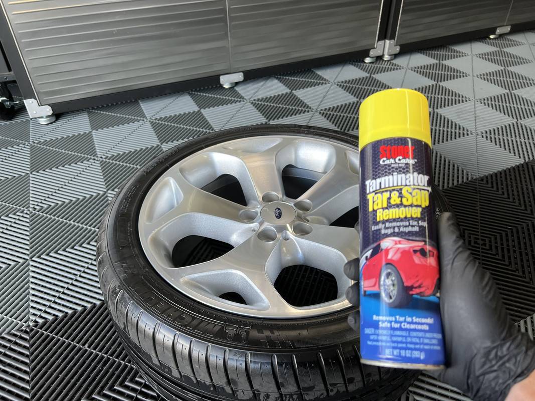

Stoners Tarminator!
Now, this is a heavy-duty tar and sap remover, but for some strange reason, using this to strip tires is its hidden talent. The use of Tarminator is not something you will do often, but its extremely effective for the initial clean to remove all of the fitment soap and release agents. And as mentioned above, occasional periodic use can help get tire back to that bare state.
Stoner Tarminator - 10oz (Aerosol) | Car Supplies Warehouse – Car Supplies Warehouse
Stoner Tarminator Tar & Sap Remover 295ml (autobuff.com.au)

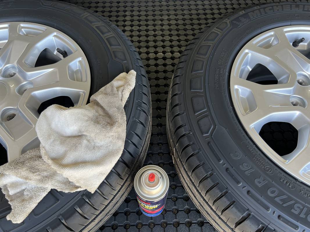

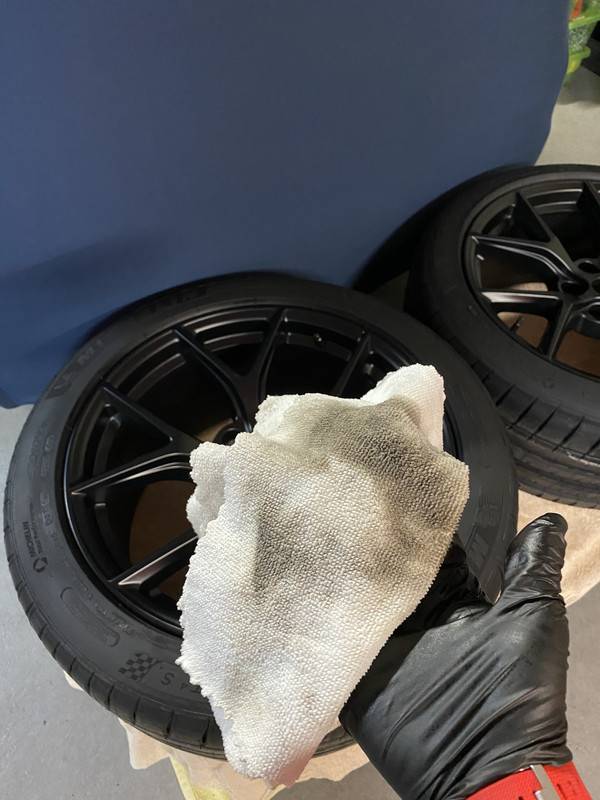

Start by cleaning the tires as normal, Brake Buster in your case. Ideally, blow dry the wheel and tire before using Tarminator. The important thing to highlight is to avoid spraying this directly onto the sidewall, especially if the wheels are matte black as it can stain them, it is a solvent after all. I spray Tarminator into a B-grade towel (you will destroy this towel, so don't pick something nice), then rub the sidewall or troublesome areas, be aggressive. Reapply Tarminator as often as needed. What you will notice is the product will go on wet and quickly absorb and evaporate to reveal bare, clean rubber.

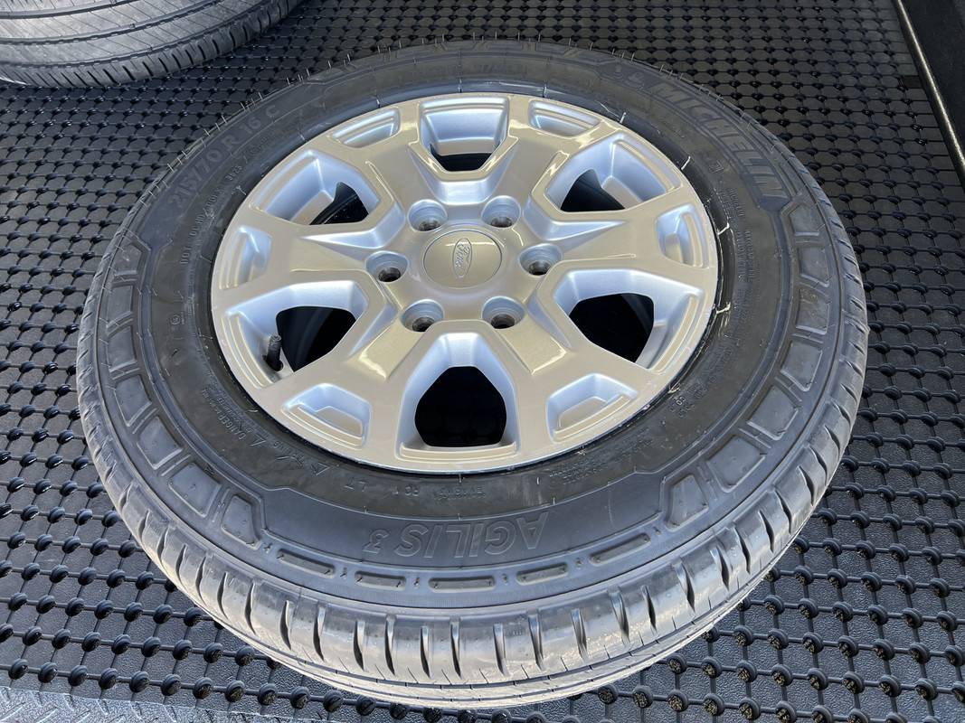

These were brand new Michelin's, right after fitment.
Mineral Spirits or Mineral Turpentine -
You would use this is the exact same manner as Tarminator. The magical thing about Tarminator over Mineral Spirits is that it doesn't dry the rubber out so much, the citrus oils within it seem to condition the rubber afterwards and prepare the surface for dressing. Considering how cheap Tarminator is for you guys in the USA, its a no-brainer in my opinion.

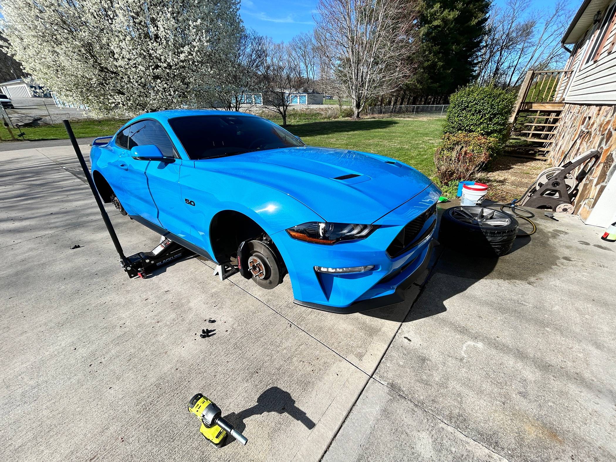

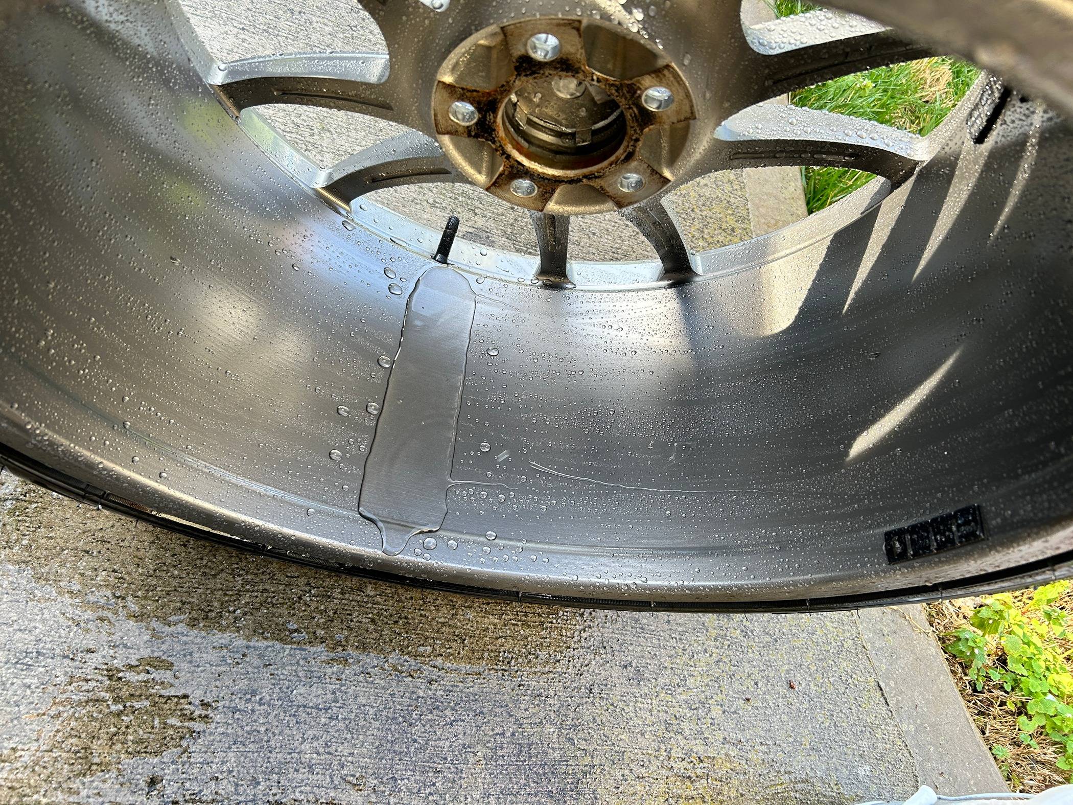

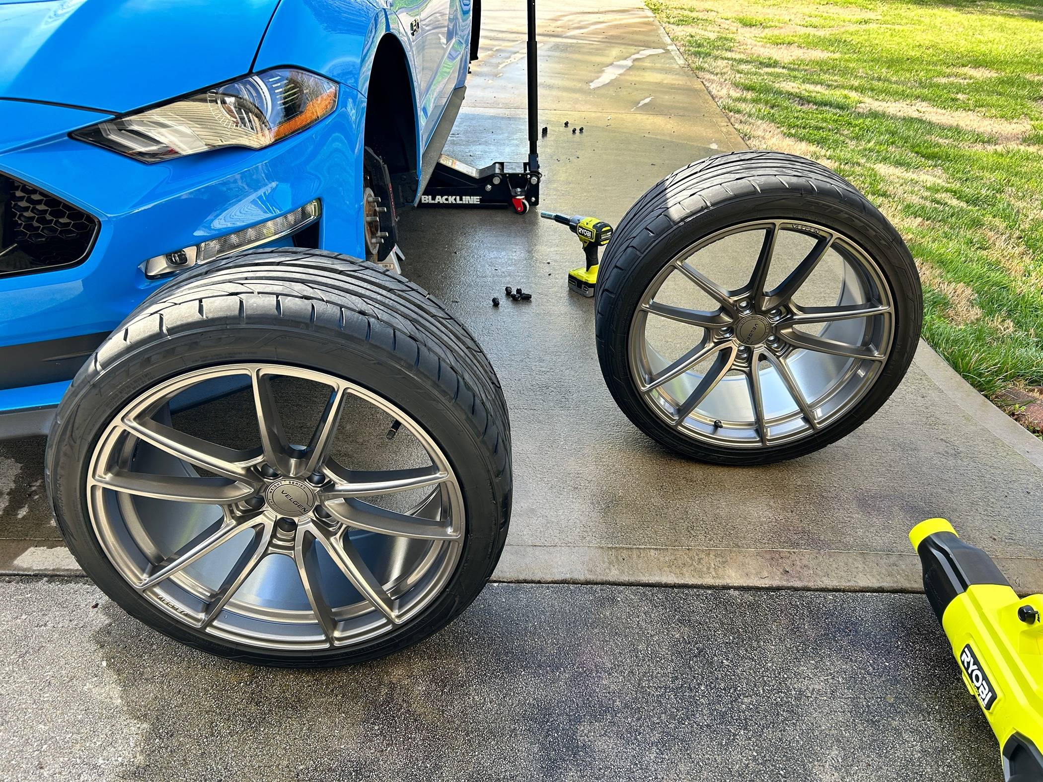

I was preparing for a local Mustang show near to me today (Ponies in the Smokies) which officially kicks off Monday. Anyway, I paid some extra love to my wheels today. Removed, cleaned thoroughly inside and out with CarPro TRIX to do the 1-2 punch on the iron and tar deposits. Used some KCx Active Foam in the bucket for soap. Found after cleaning they were still beading reasonably well after almost a year since coating. Rather than do a full re-coat I just sprayed thoroughly with CarPro Hydro and rinsed, blew dry then put back on the car. Did as deep a clean of my front calipers and fender wells as I could while it was apart. Much better :)

That's a huge job and, not one of my favorites, but the results are always worth the effort.
LOVE those wheels, Alex!
Thank you, I l LOVE them. They are much easier to clean than my PP wheels were even on the car LOL. I am glad I went with Gunmetal instead of black like I originally planned on.
