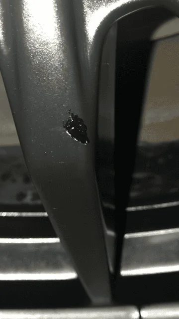

Can anyone confirm the wheel paint code for 2016 GT350, I was told it was Ebony Black, paint code M6373. I recently got the tires changed and they chipped the paint on one of my wheels. I wasn’t too worried about it, so I thought I would just get some touch up paint. I went to a auto body place and the mixed me up a bottle of M6373. I painted the chip and let it dry and it’s not even close. It appears to almost be a gloss black while my wheels are like a matte black or dark matte grey.
Any info or help would be great
Thanks

I am also curious about getting the proper touch up paint. Did you check with a ford dealer? I believe M6373 is the code for ebony mustang gt wheels which do appear to be more glossy.

I recently went through this same situation, and the way I understood it was that the ebony black wheel touch up paint was a match for the gloss black Performance Package wheels that are on the regular GT.
So I found a post from a while back where the guy used some VHT wheel paint in satin black from the local auto parts store so I did the same. Sprayed a little out on a piece of cardboard and used a small touch up paint brush to fill the chip. I don't have any pictures on me but the color matched up pretty dang close! I still need to go back over it with a few more coats to thicken it up to bring the paint level up closer to the original paint so its not as noticeable.

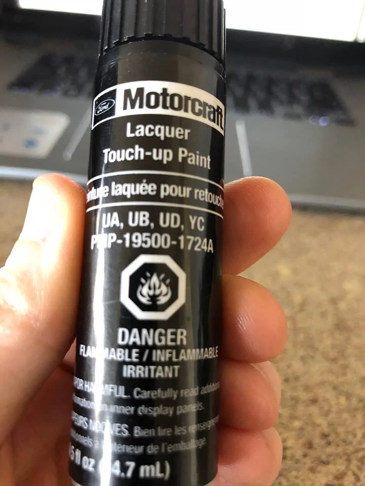

The dealer I bought the car from sent me this for my wheels.

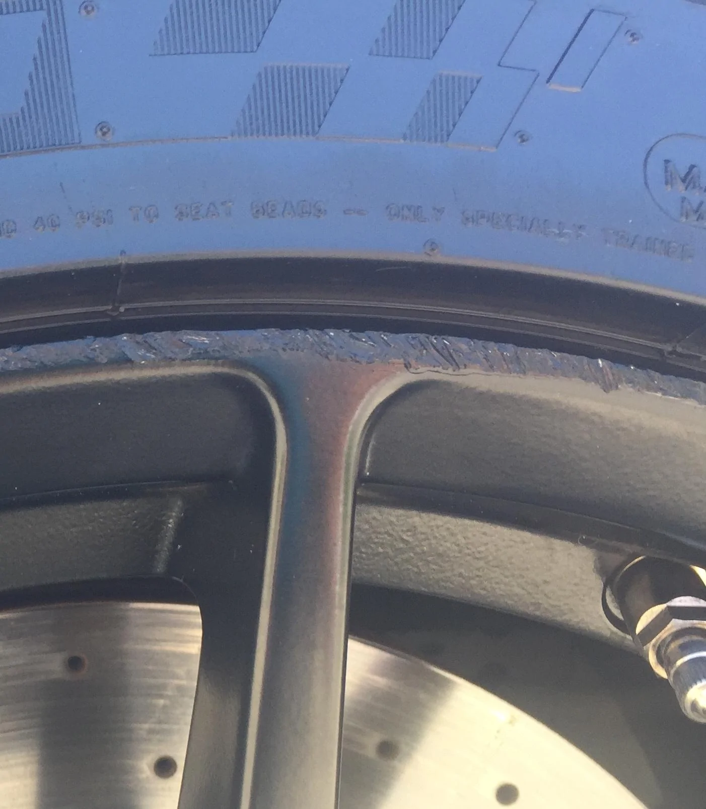

Are these wheels on these cars more of a grey? Mine as shown in the original post look grey and not black.
