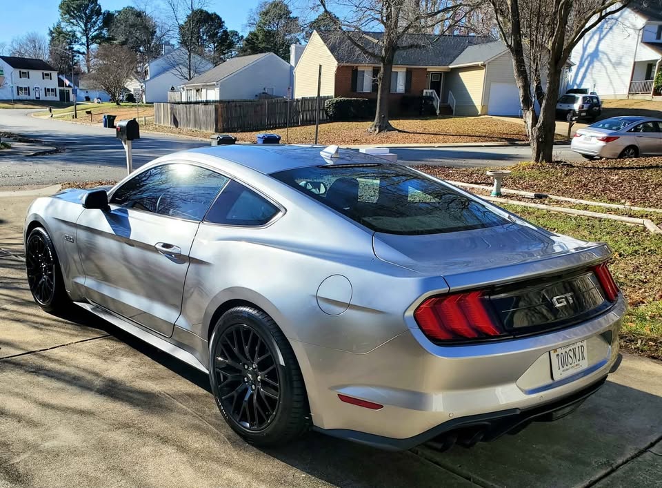

When I had the stock PP wheels, I used 25mm spacers in the front and back. It gave that nice flush fitment. The ones I had were from Steeda. Ensure you get the hubcentric ones.
This is the best picture I could find. This was before it was lowered.
