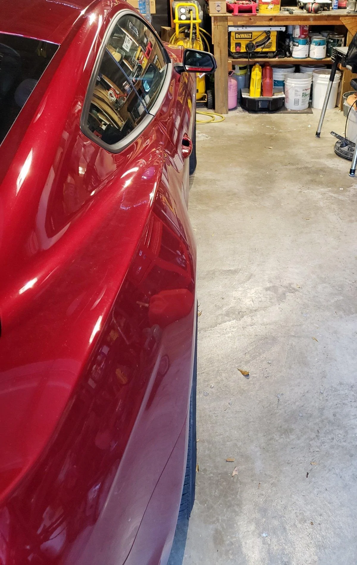

I ran 25mm spacers for a little while and didn't notice any difference in handling but not long enough to determine any issues with tire wear or bearings.
Hard to tell from this picture but you'll get a slight amount of poke from the rear and none in the front.

25 mm in the back will poke. If you are like me and hate poke, I would strongly recommend going with 20 mm in the back. 25 mm in the front works fine.
