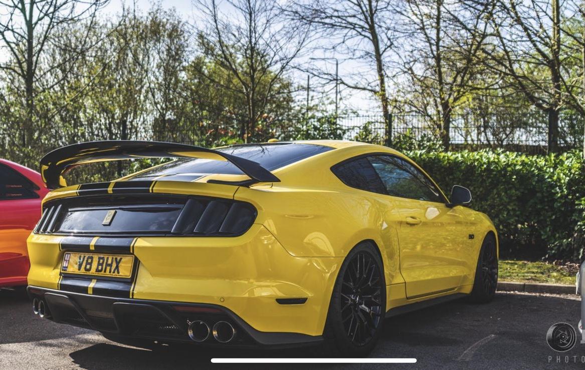

Depends if you have an aversion to poke or not. If you like a fairly aggressive stance whilst still being legal then 25mm all round will allow you to fit them yourself with no grinding of the studs. I had 25mm front and 23mm rear which fitted straight on. If you're doing it yourself be sure to follow manufacturers fitting instructions regarding torque as there's a lot of "stuff" going around at the moment regarding quality of spacers which i'm not going to add to.
After three years I took mine off and replaced with aftermarket wheels - RTR Tech 7's - which whilst not being as aggressive a fitment as I previously had do fill out the arches sufficiently well.View media item 14917This is the RTRs...

I can't see the photos. It says that I don't have permission to view the album ¯\_(ツ)_/¯

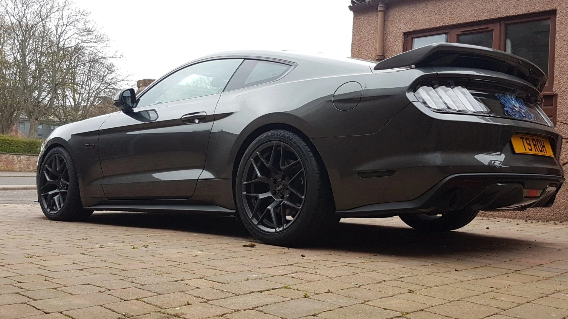

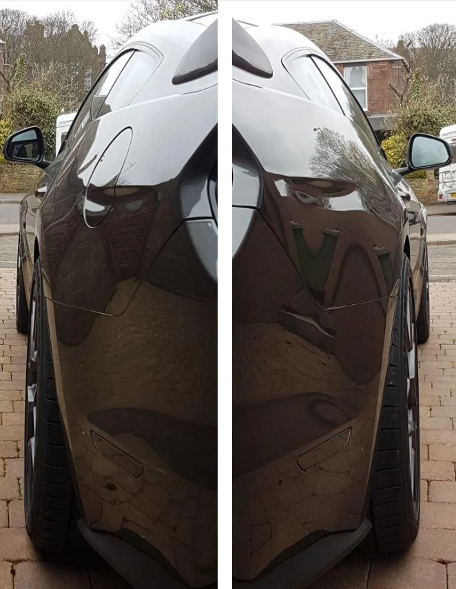

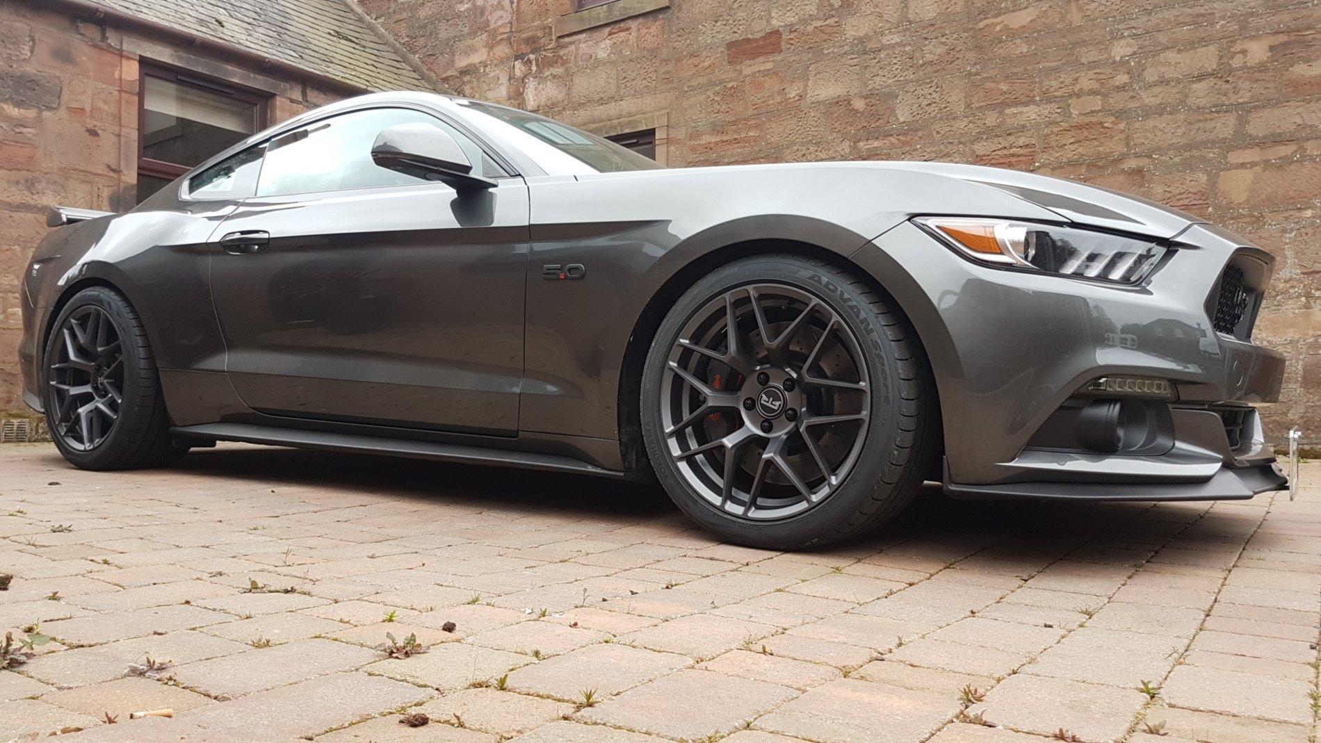

Hmm. They didn't improve this forum when they changed it. Try this...

They look awesome!!! Can you let me know which size rims are they and what size tires did you put on?

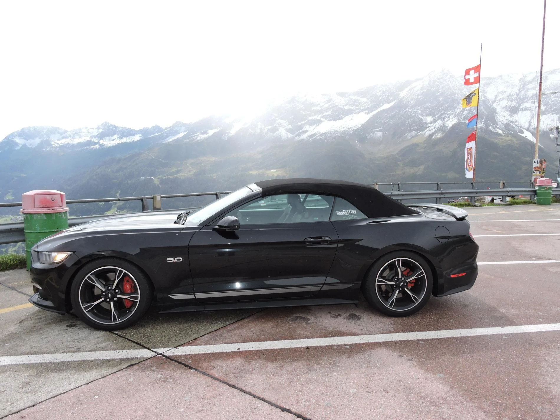

Mike done mine with the lowering springs at the same time, I took his advice, and have had no issues for 3 years and the car has been all over Europe,
