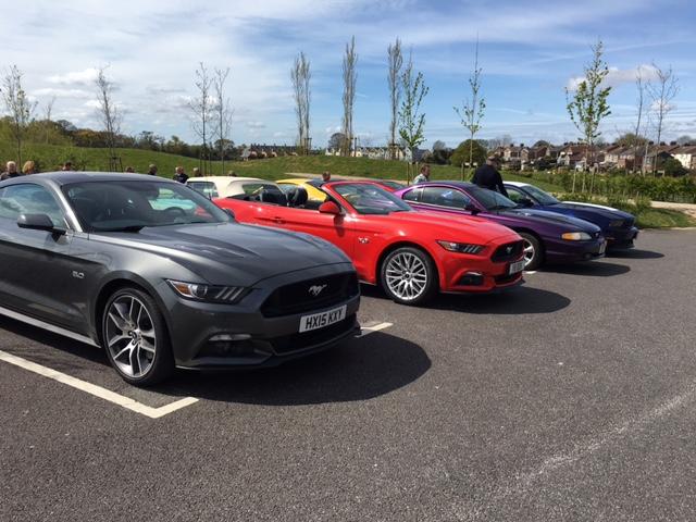

That's funny you should mention that,
Looking ahead, would 20" wheels sit better in the wheel space, or would the suspension still need to be dropped to help the top of the tyre/wheelarch gap look better ?
All else being equal you will need the outer tyre diameter to remain close to the same with 20s (using lower profile tyres) so the arch gap would remain the same :)
The Magnetic in this picture has 20" wheels with standard suspension setup.
