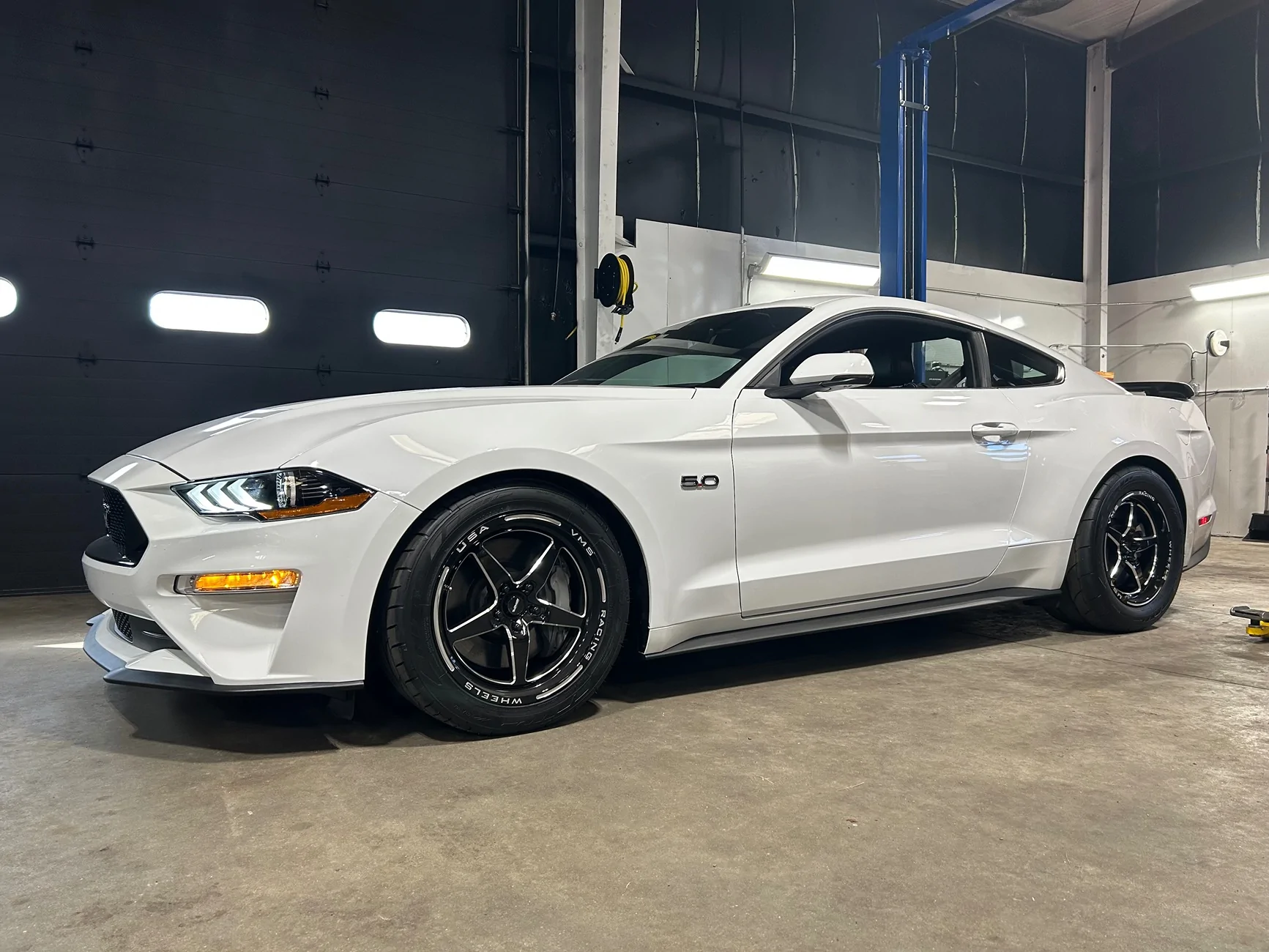

I'm running 20x10 square. With 35 offset. 285/35r20. No rub, closed the gap and could still lower if I wanted too.

20x10 +35 here. 285/35/20 tires

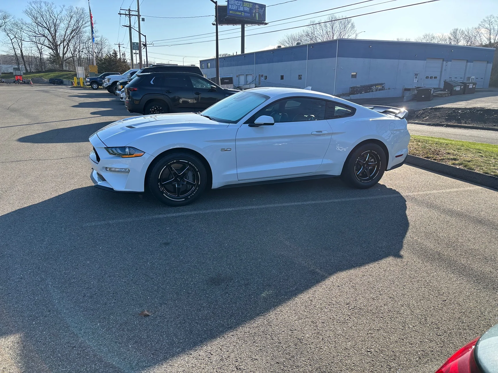

The size of the wheel doesn’t necessarily mean it’s going to fill the wheel well any more. I run 17’s in the rear and it definitely fills it up.
damn! thats some thicc rubber on your girl, looks very Drag Racing style

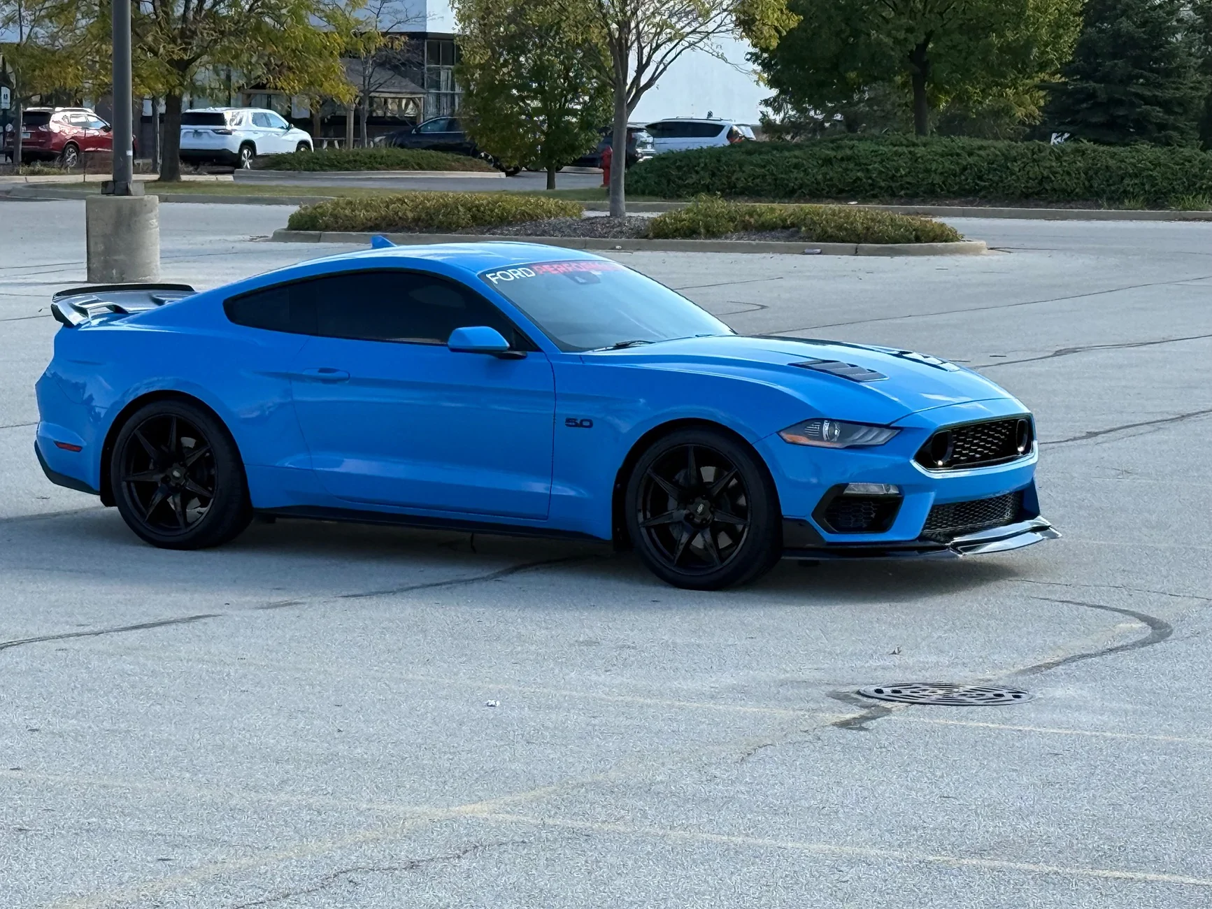

19 or 20, still x10" ET35 and a 285/35 tire works fantastic. You can rotate all four to even out tire wear and its a good amount of tire for the street ... assuming you put a good tire on it and not the cheapest nitto the online vendor give you a deal on. If you throw a 555G2 on there I'd rather have 9.5 with a much better tire.
Wheels just hold the tire on the car, the tire does the hard work, so don't skimp too much there.
