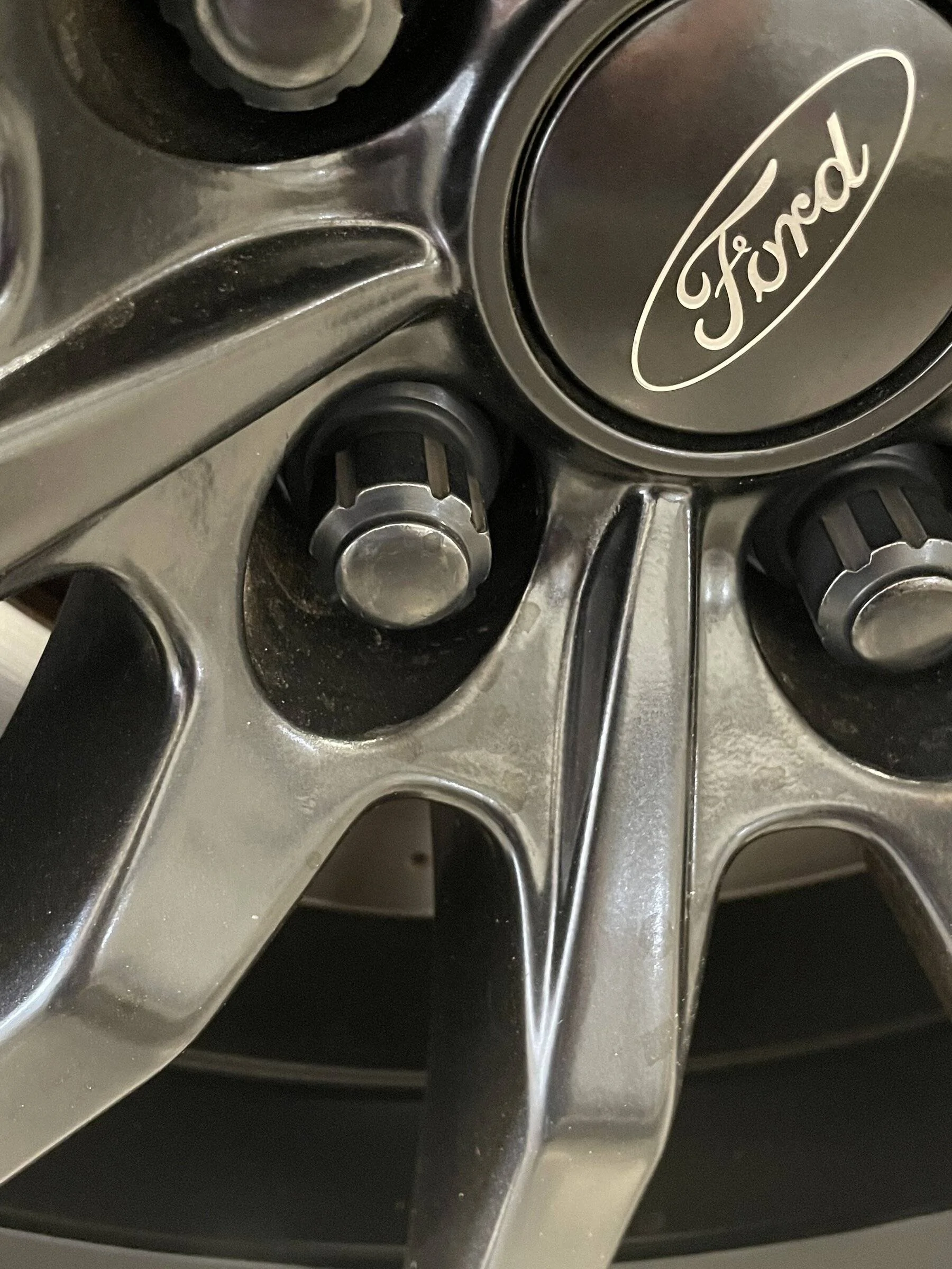

Can anyone tell me what brand of wheel locks these are? Was having calipers painted and just found out it has locks on it 😬

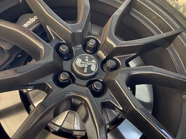

They look like Gorilla brand wheel locks like I have on my car. You may have all locking wheel lugs, which is the one I have at the 3 o'clock position on my wheel.

So you recently bought the car and you do not have a key for the locks?
Unless you get lucky and find the right key, your best bet would be to get an extractor to remove those locks. It can be a PITA to remove just one….you have twenty.
Have a new set ready to install after your caliper paint.
I would assume if they are Gorilla locks, Gorilla makes several different lock and key combinations. In other words, you need the ā€œrightā€ key for those locks.

I think I finally identified them
As gorilla locks. Talked to someone with their company who said they might be able to help. Stinks the old owner didn’t leave the sticker or the key though.
I can’t believe I have owned the car since October and never noticed the locks till now.

Thank you. Yup all 20 :(

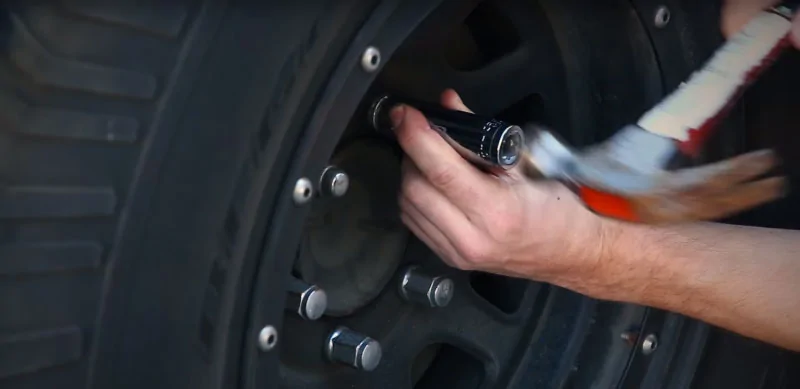

I double dog dare you to try this method…
When I was in college working at a tire sales/service garage that is the exact way we removed locks when a customer would come in without the key. Works very well but the sockets don’t last more than a lug or two.
There you have it Saxgod… no need to wait for the key, GTthree50 says so.🤣

Haha, I’m not the final word but it does work. Just have a decent supply of cheap sockets. I’d be wary of letting a dealer do it unless they could show me that they have a tool for the job.
