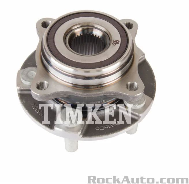

One thing to note, is that Ford doesn't make many of the parts they sell as OEM. For example, the Timken rear wheel bearing is a FoMoCo part. You can see the label right on the back side of the hub flange

Well, the OEM ones lasted 145k miles.
Timken is not the OEM supplier. This is just a photo of the OEM hub, you will not get this hub in the picture.
