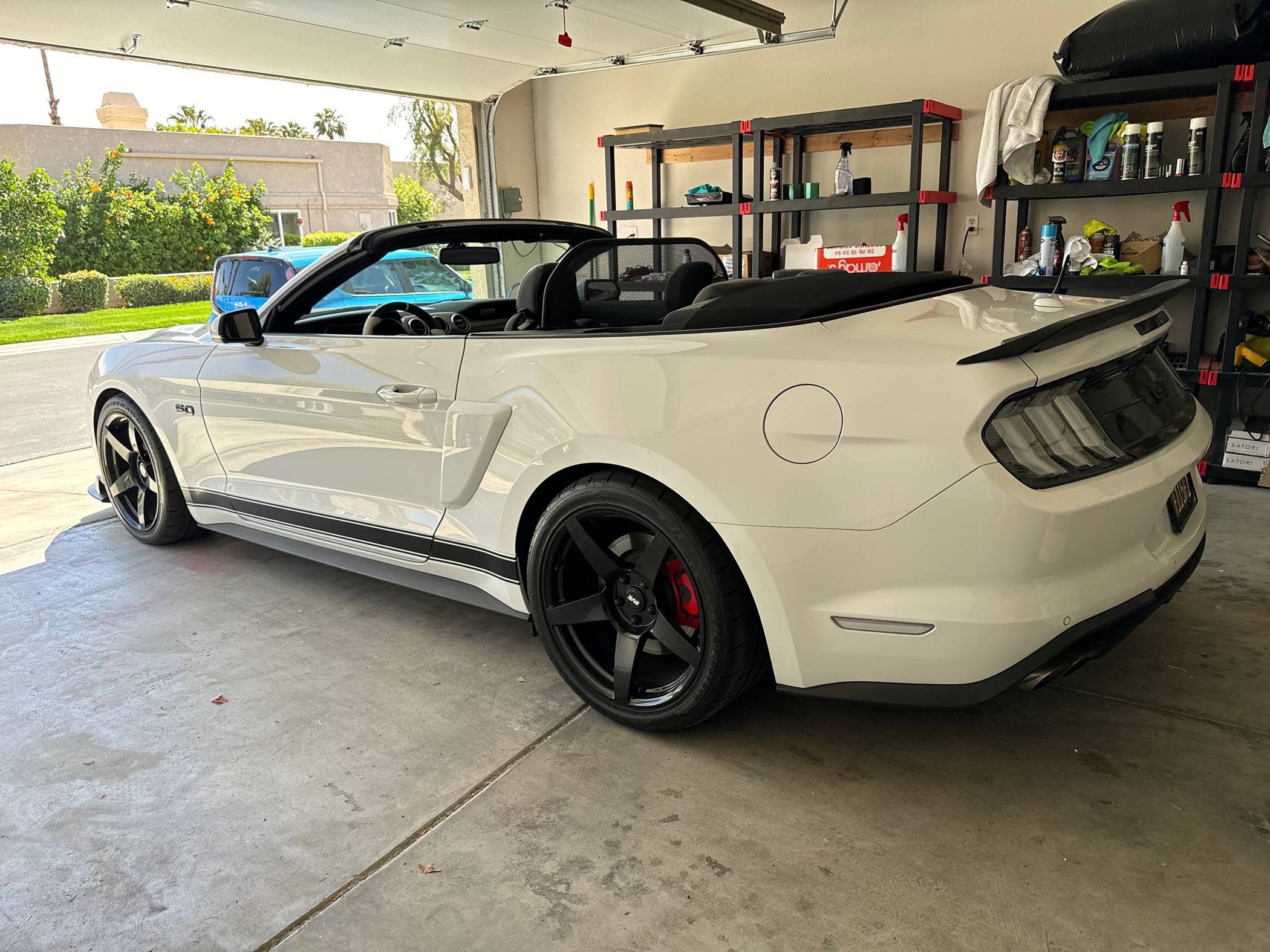

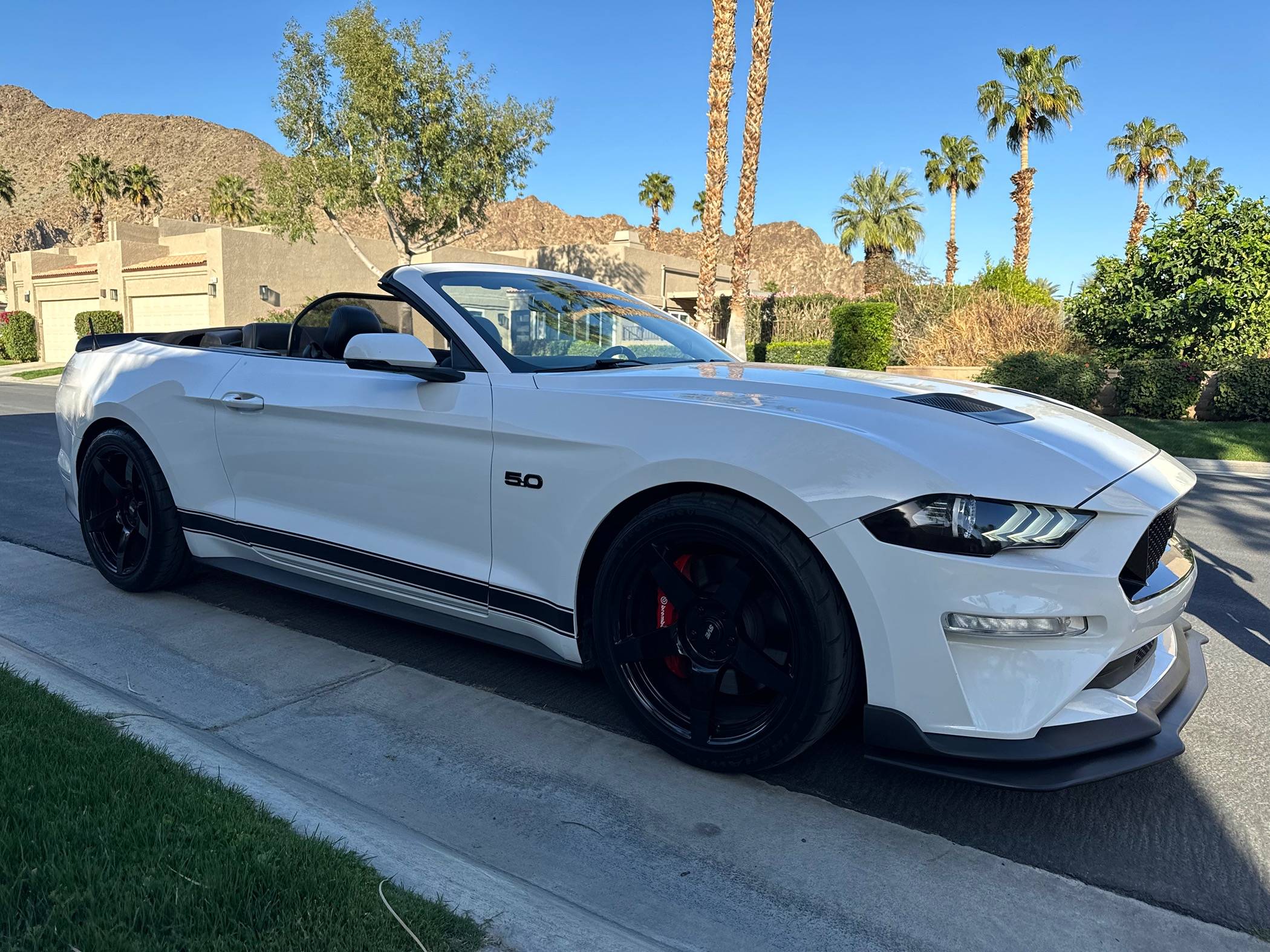

I have 325's on the back and it doesn't rub. I'm dropped about an inch I guess. It's shown on my profile pick now.

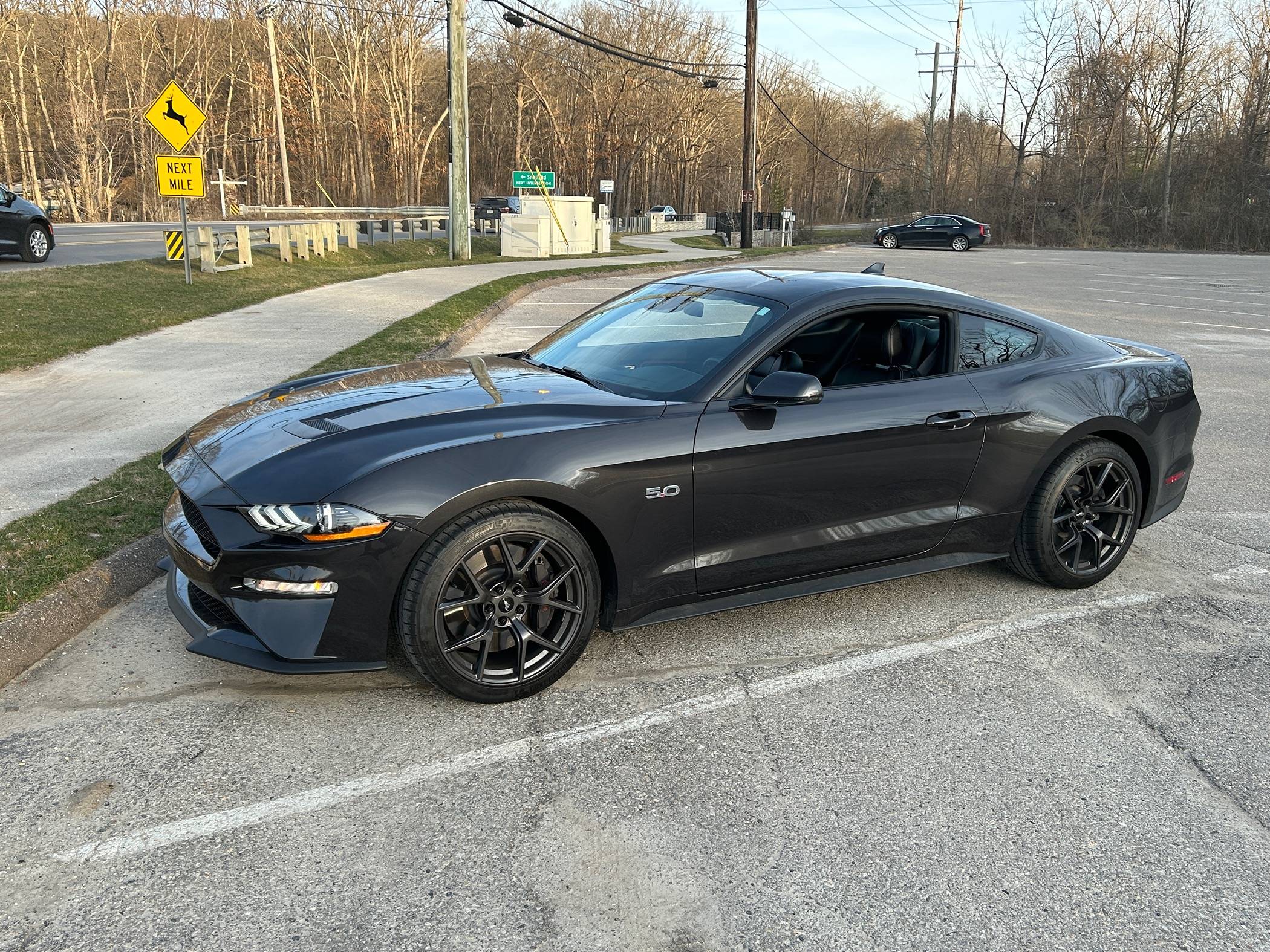

295/35/19 on 19x10 and 305/35/19 on 19x11. Wouldn’t go any larger on the front on 10” rims, doing it again id push to 315 on the rear with supersport tires which run narrower than others. Tires in pic are supersports btw

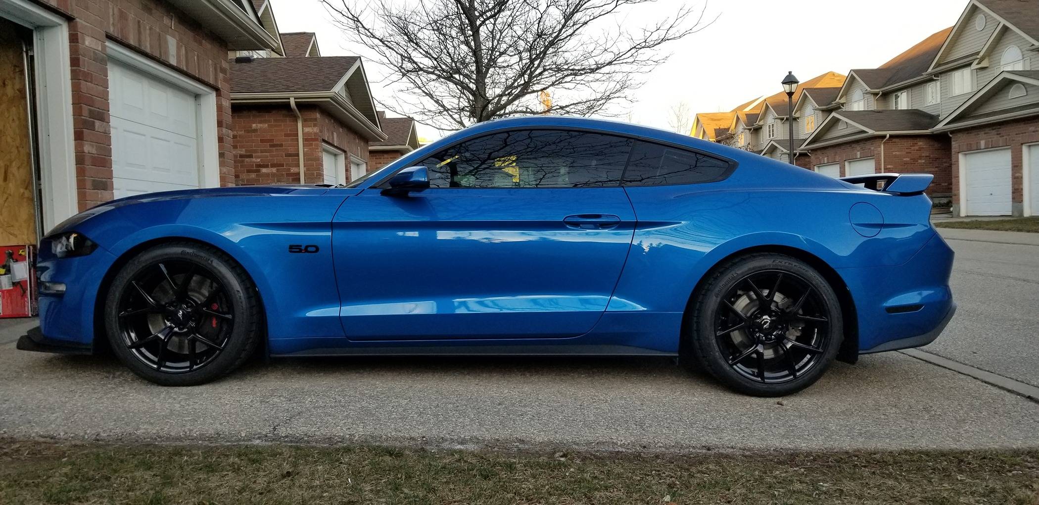

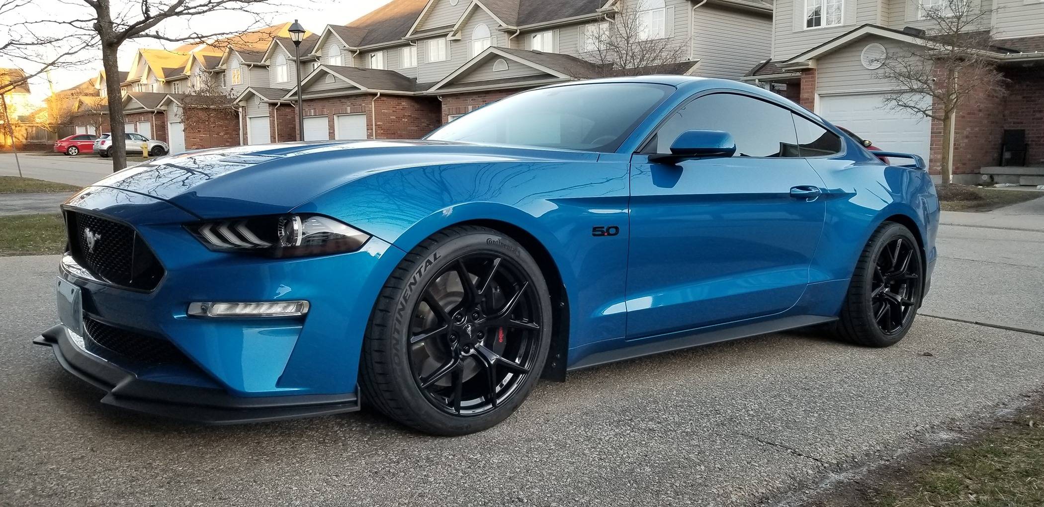

I run the same SP2 wheel size and spring setup as @Virnman on Conti ECS02 tires.
Wouldn't change a thing.
