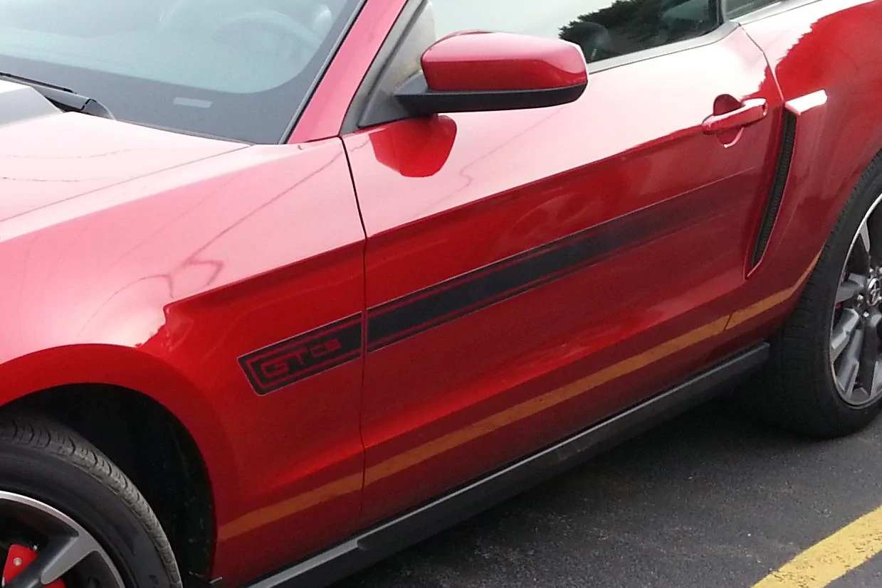

Can you wax over the stripes ok? Does it leave a white line the length of the graphic? You can see this on the factory side stripe graphic on my 2011. Is there a way to get rid of this?

Literally just a couple drops of dish soap in the spray bottle with water.
And use a clear wax, like Turtlewax Ice or similar. Or use a good polish/sealer.

I bought like 10 bottles of Turtle Wax Ice clear (the older version without the carnuba) for exactly this reason. It rocks and you can get it anywhere on the car with no residue, even the black plastic.
