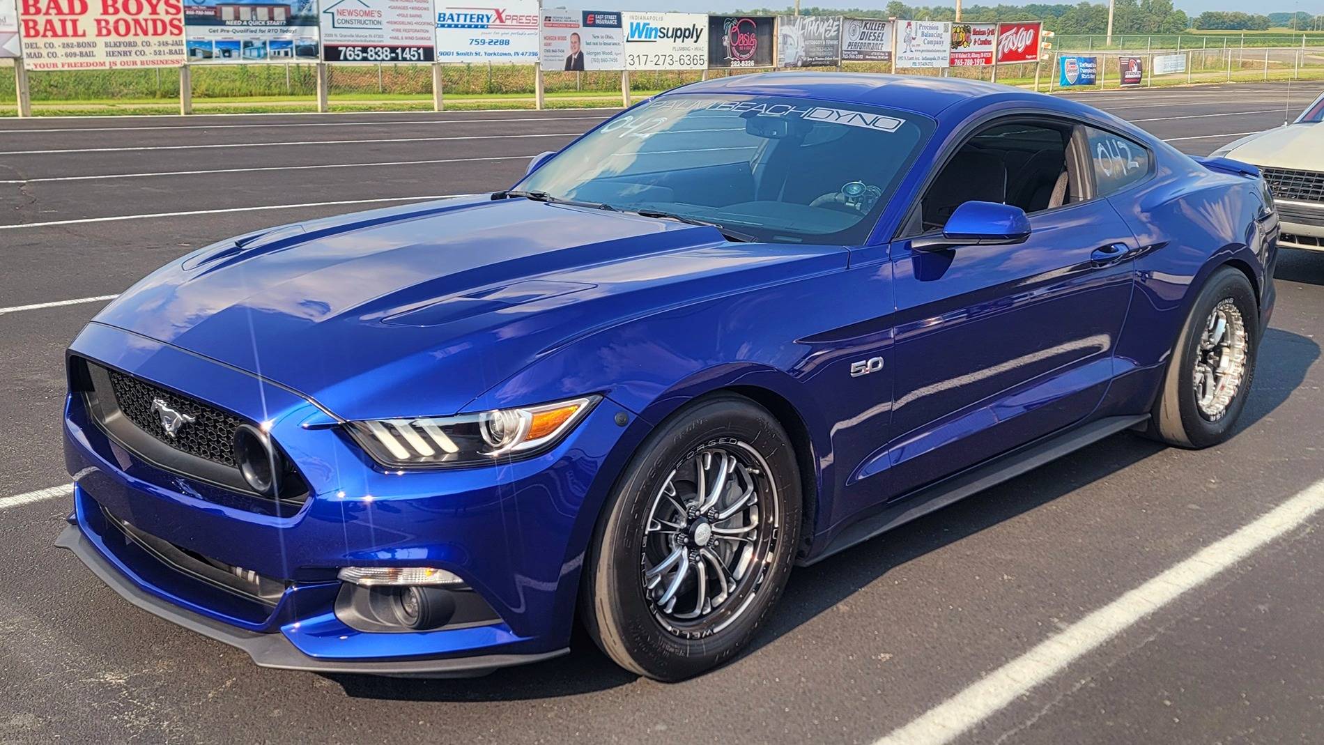

Weld 17x10 Laguna Beadlock - 5x114.3 ET 50 BS 7.50
305/45/17 tire
My car is lowered and has no issues with rubbing, but if you want to run a bigger tire than above then you'll definitely need to go back to stock ride height.
