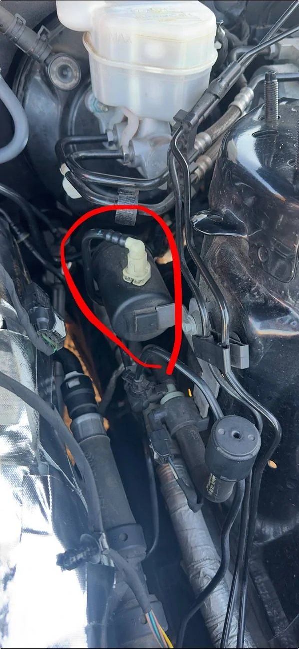

What is this canister for and can I delete it? It’s a mustang ecoboost btw

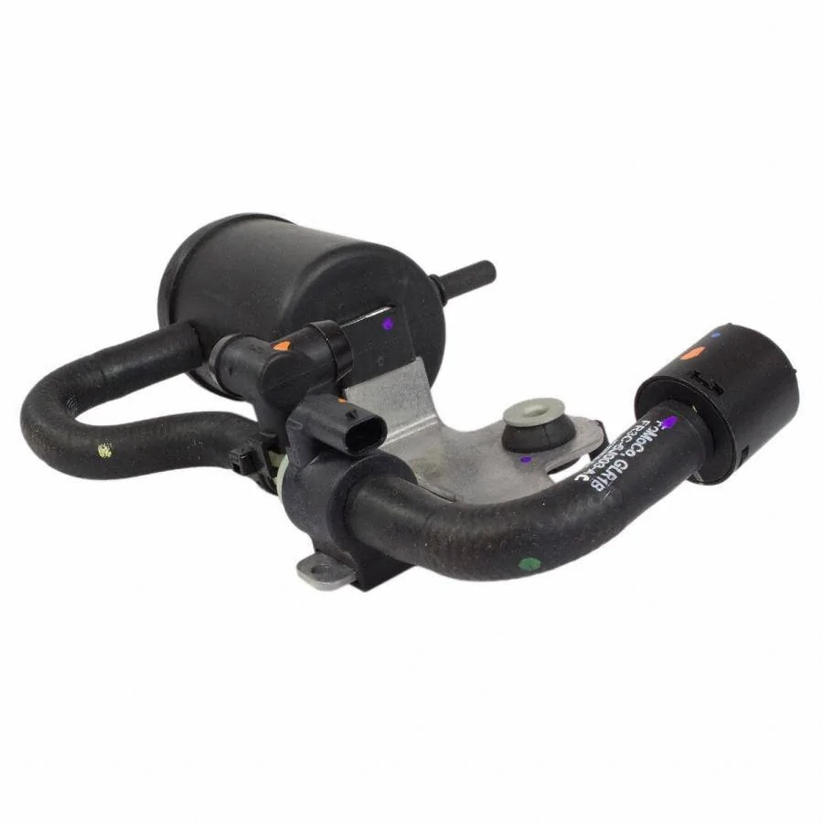

see if there's a part number on it then look it up.
Skye
Jan 18, 2022
3,032
4,251
≈39N
"Skye" Mach1 N2144
@Mike Pfeifer :thumbsup: mentioned it was a vacuum reservoir.
I've attempted to find a Ecoboost vacuum layout, but could not. FWIW, I do think I've identified the part.
What does it help control? Anything that needs a vacuum.
While driving, the amount of vacuum available (measured in "Hg" or inches of mercury) varies with throttle. While at a stop and idling, vacuum is maximum. But at WOT, vacuum is minimal.
The reservoir is there like a gas tank. When you need to operate a vacuum-controlled device, the tank ensures vacuum is available to it.
Potentially affecting so many items, I don't mess with things like that. The Engineers put it there for a reason.
YMMV.
https://parts.donnellyford.com/a/Fo...System-Engine-Mounting/f036610102.html#6J005C
https://parts.donnellyford.com/p/Ford__Mustang/Reservoir---Vacuum/141549639/FR3Z-6J003-B.html
