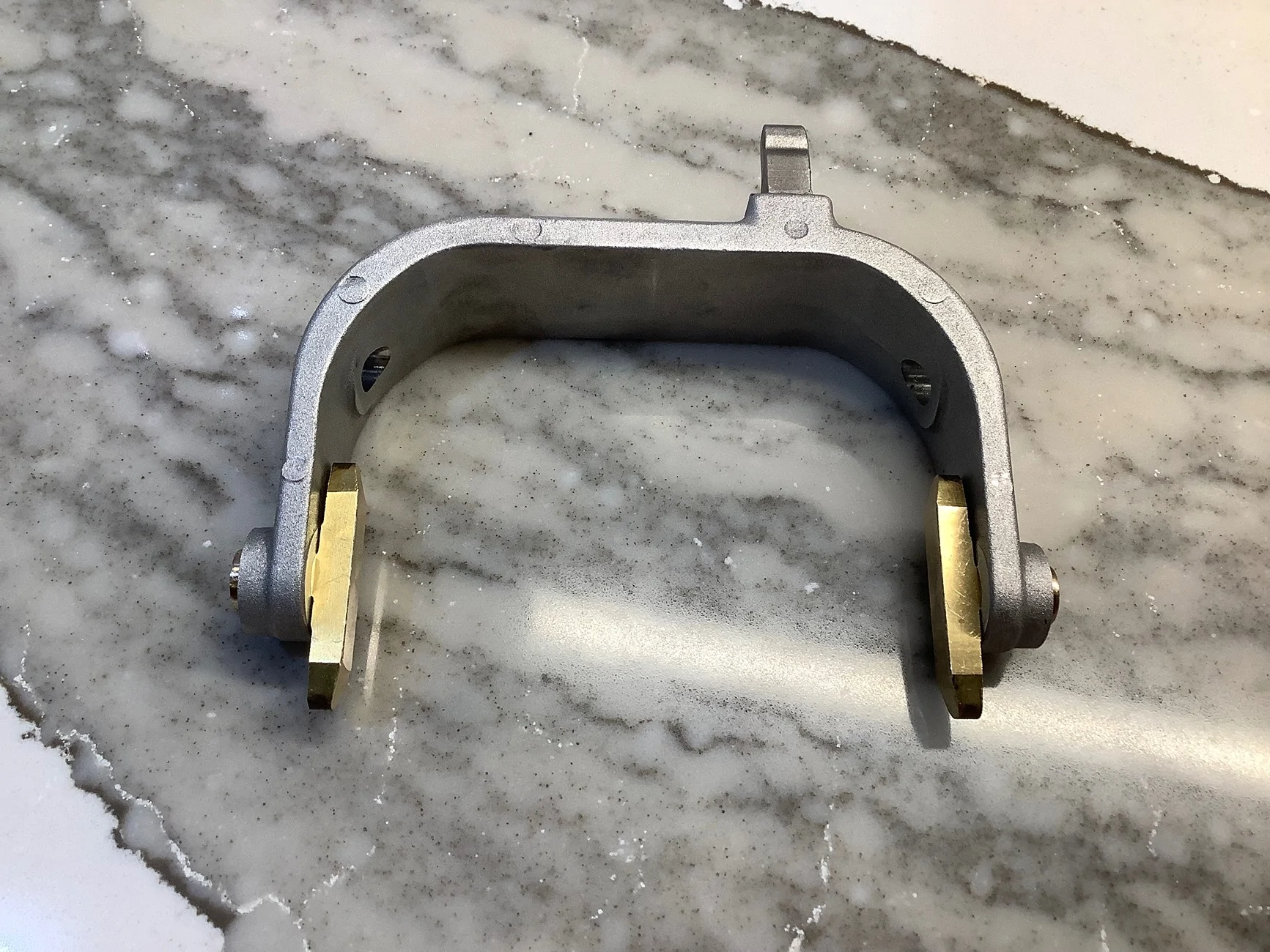

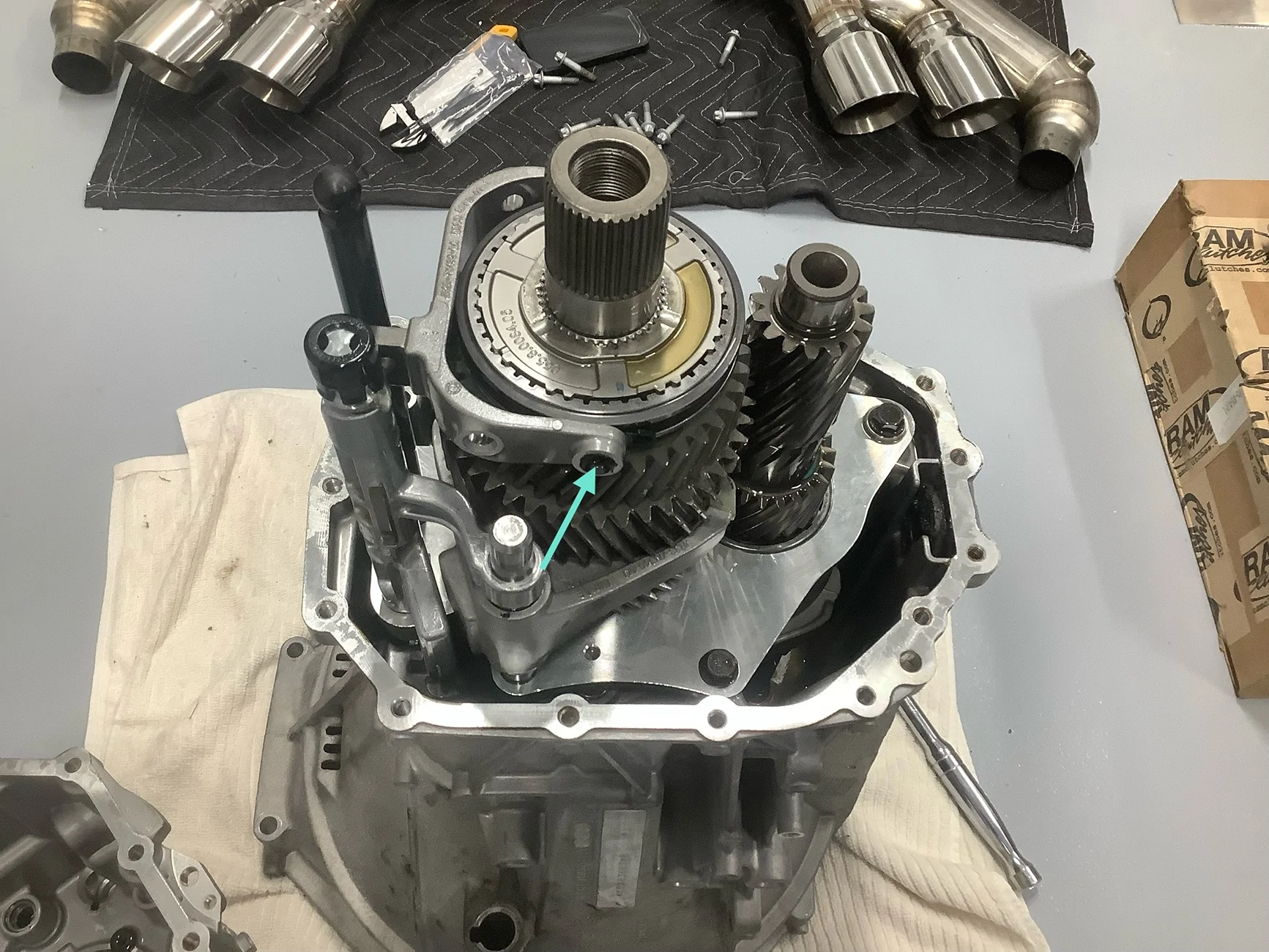

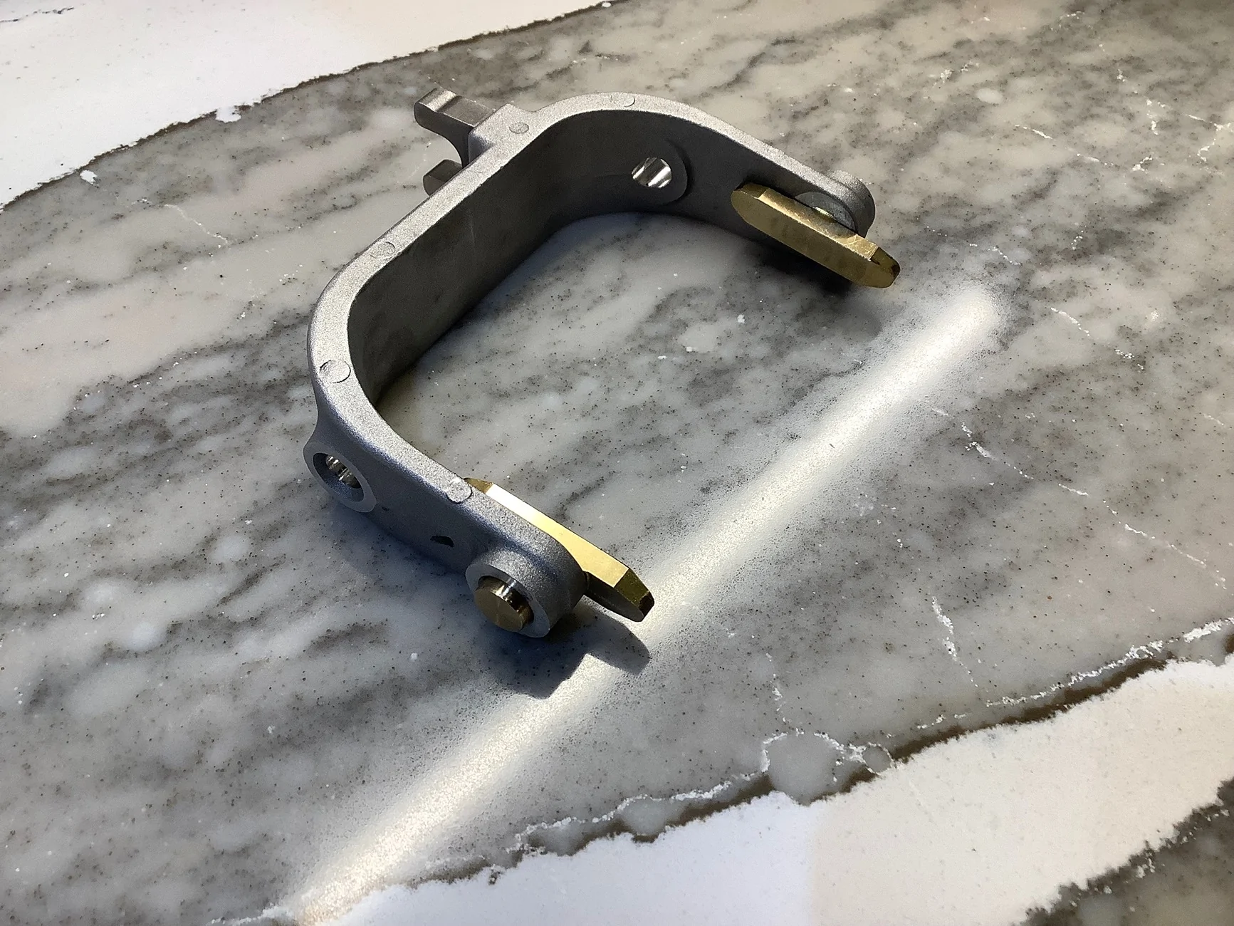

If the fluid bleeding/flush doesn’t work, you may need to pull the tranny, open it up and inspect to determine condition of the reverse shift fork pads. I’ve read at least one thread where someone’s broke apart and led to other issues in their tranny.
FYI, this is about the least invasive option, as they can be easily replaced and upgraded with bronze pads. All that is required is to remove the tranny output flange and tail cover and use a heat gun to get the pads hot (melting) and simply pull them out and replace them with the bronze pads.
