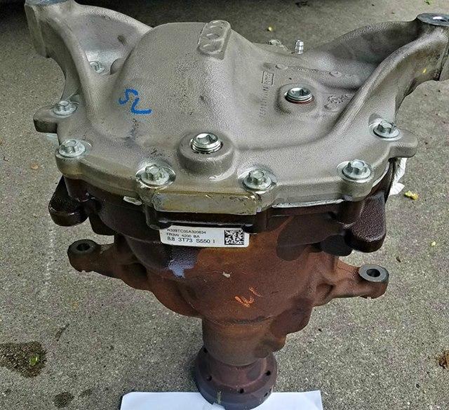

Hey all how's it going! Question for all, I lost my original window sticker, and I was wondering how I can find out what gears I am running!! Thanks all in advance

Look on the bottom or the rear housing. There should be a factory white sticker like the one in the pic below. It should read 8.8 then the gear...this one is a 3:73.
