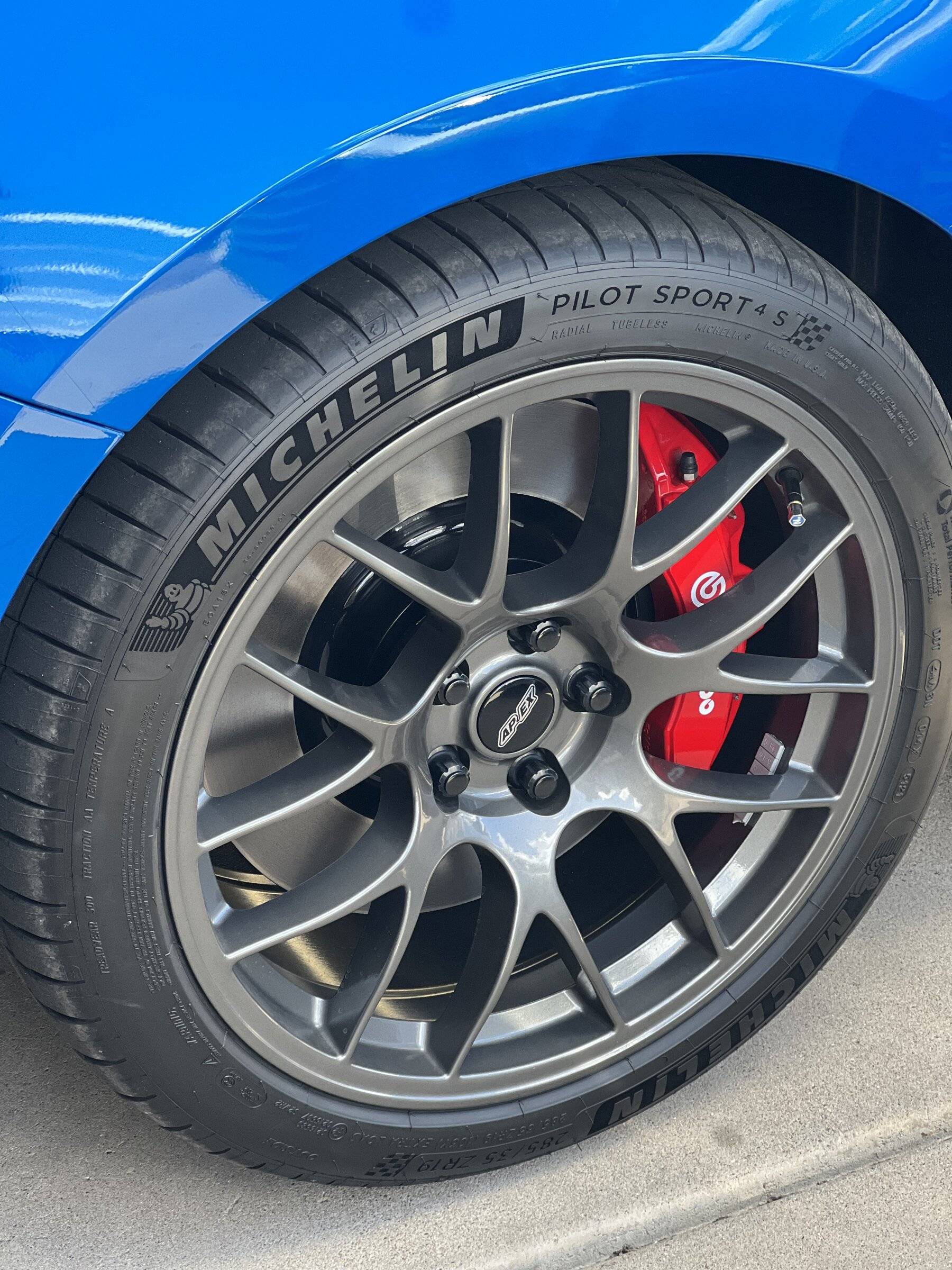

Discovered this on my stock Pilot 4S, between swapping to winters this is on one tire after about 20k miles....

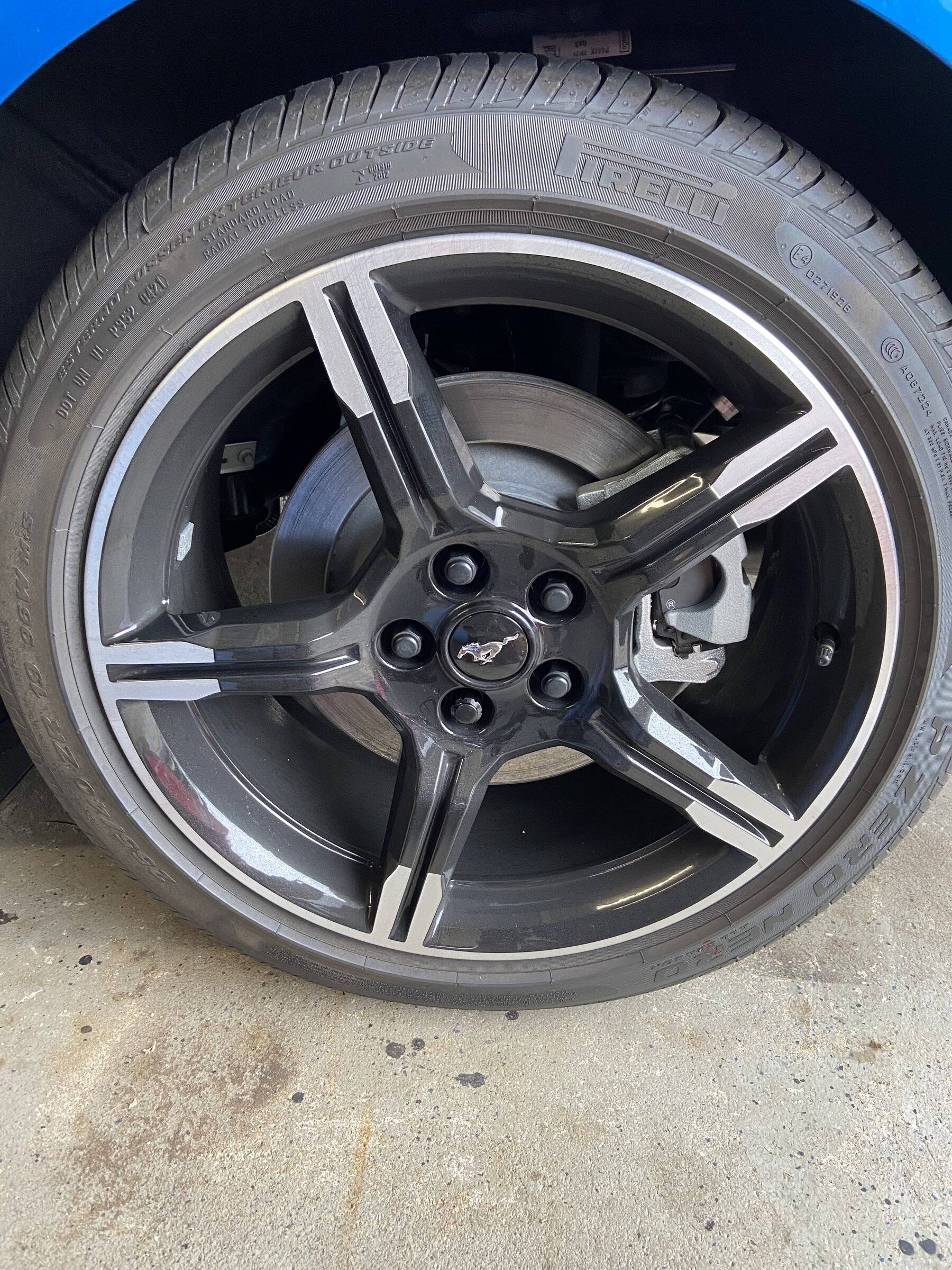

Well, the picture above is what sent me to get the alignment done the first time around, and that was after 2 track days, very uneven wear on inner right tire (I think). That would be explained by the toe I
I noticed it when swapping summer > winter set, hence why I scheduled the alignment.
