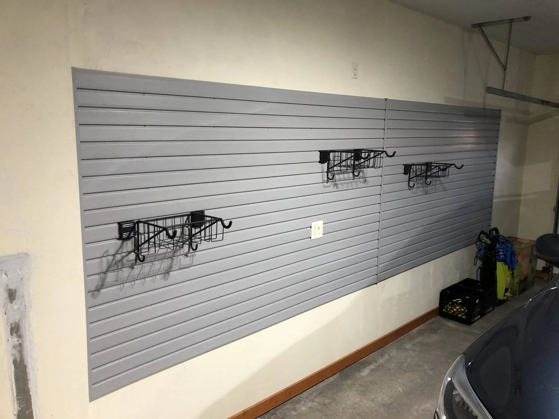

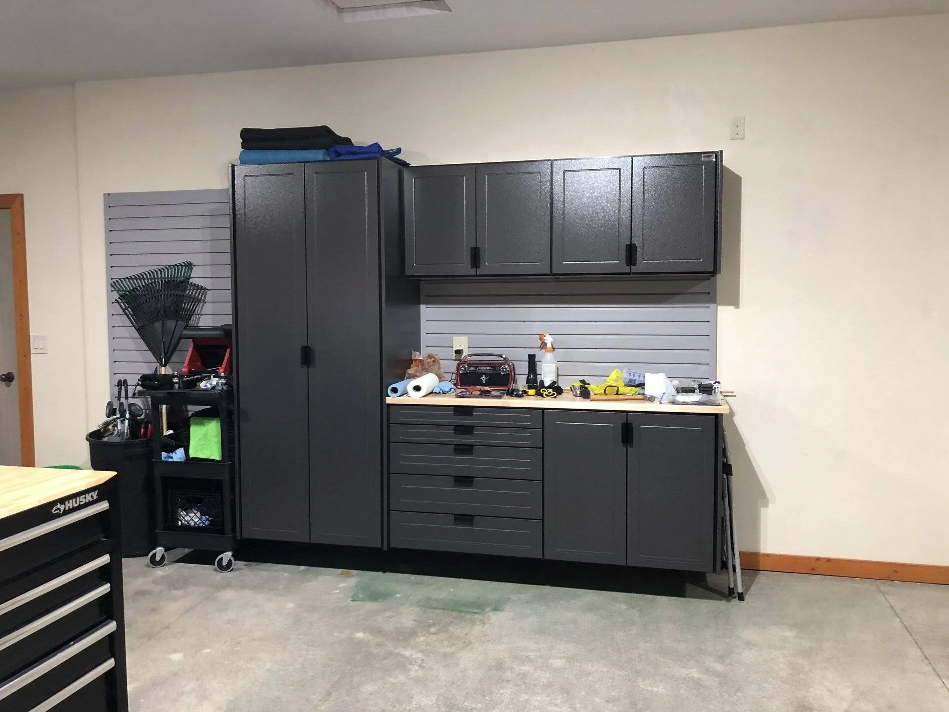

Redline Brand Garage Storage Cabinets and Slat Wall installed last week. First home with drywall and plaster on walls. Didn't really want to deal with screw in hooks to mount everything. Decided to start with a basic setup.. not sure if I am going to need another cabinet or just more slat wall. Now the fun begins as I decide on mounting accessories for slat wall. The possibilities are endless.

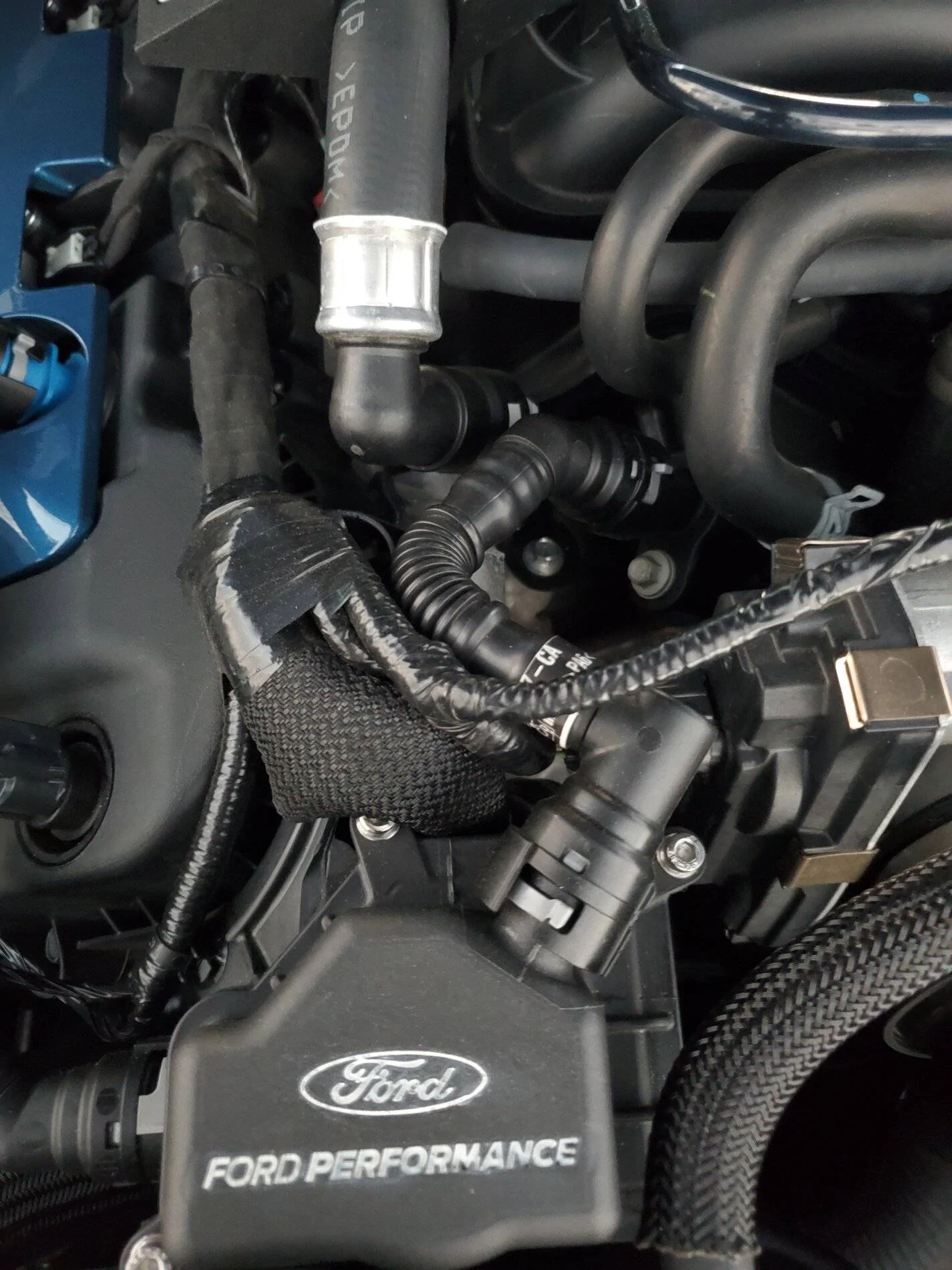

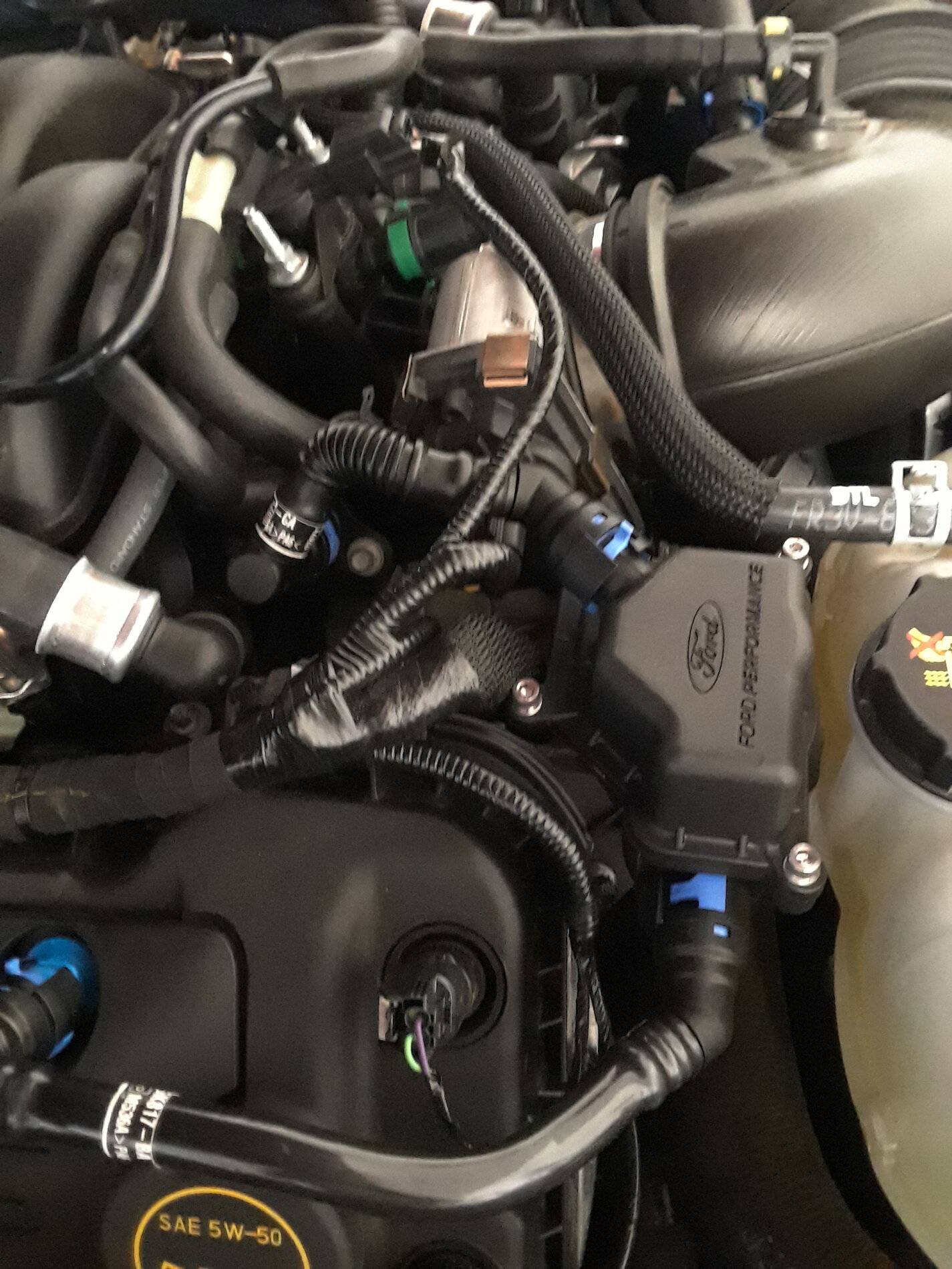

Here is a pic of install as per Ford Performance instructions. Did not have any problems. Also used clip for cam harness wires to secure instead of second pin.

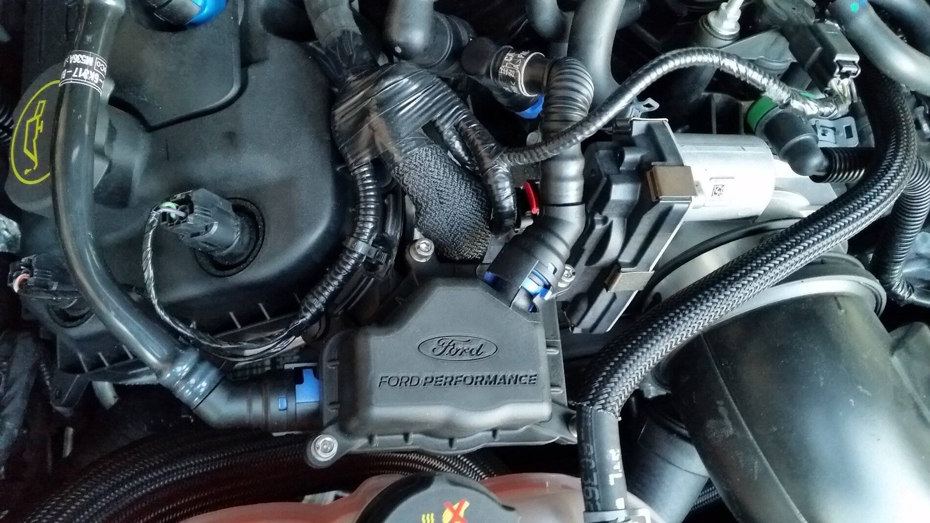

Here's mine, installed as per instructions. Temps were only about 50°, so I had to warm the hose to fit.
Thanks guys for all the input. It's hovering around 40, but temps start in the 30's this week so I am thinking I might wait until it warms up this weekend before attempting...
