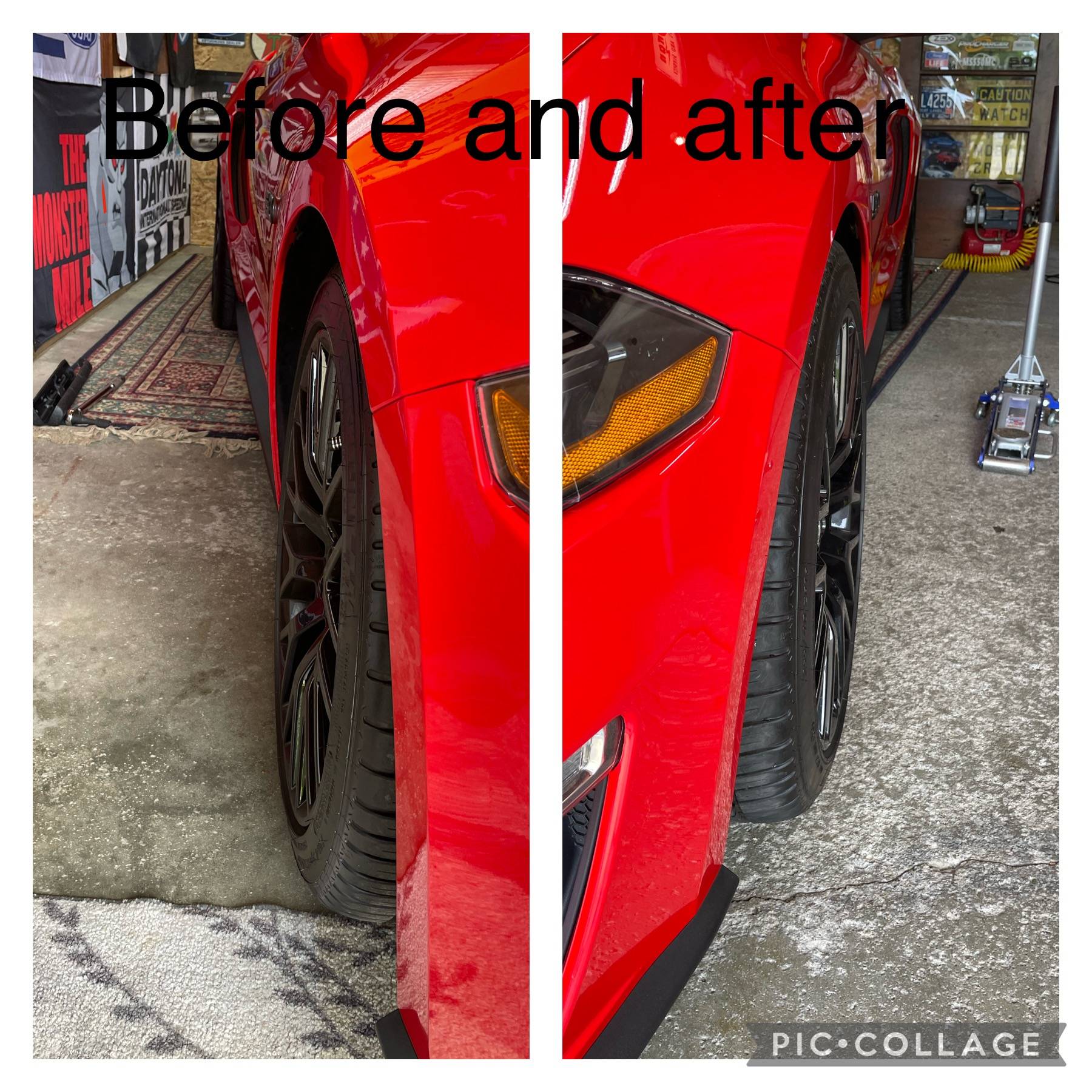

I did 1” on mine all the way around. Just make sure whatever size you go with get hub centric ones. This was mine before and after with the Eibach Sportline springs about 1” lower.

Can you send me what you order for the spacers?
I got mine from Amazon after doing a bunch of research. They’re just as good as any others I researched and were a bunch cheaper. I have had them on the car for a year now. Just make sure you follow the torque specs in directions.
