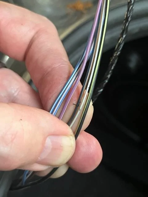

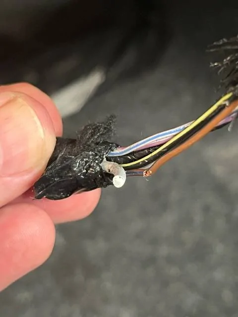

Before doing the tone tests, I figured I’d check the wiring harness in the trunk. I found that the brown/blue wire was damaged. The others look OK. I checked the wiring diagram and some of these wires aren’t listed for the 2018. Does anyone have an idea what each one of these wires are for? as I see it, they are the following wire colors (wire/stripe):
- blue/white(grey?)
- white(grey?)/blue
- violet/white(grey?)
- brown/blue
- grey (white?)
- black/yellow
Also, there is a thicker gray “wire” that appeared to be cut but when I tried to splice it, I realized it was just plastic tubing with no wire. Anyone know what this is?

I cut the brown/blue one which was damaged, and the trunk wouldn’t open. Spliced it and works now. Doesn’t help my audio issues.

If these are the wires that go to the trunk lid, then these are only for the trunk release and rearview camera. The white tubing should prevent snapping of the wires. Snapped wires are one of the main reasons the rearview camera goes black btw.
Speaker wires are all down in the drivers footwell where the stock amplifier is located. Wiring diagram is in one of the sticky threads.

There's a recall for that trunk harness issue.
