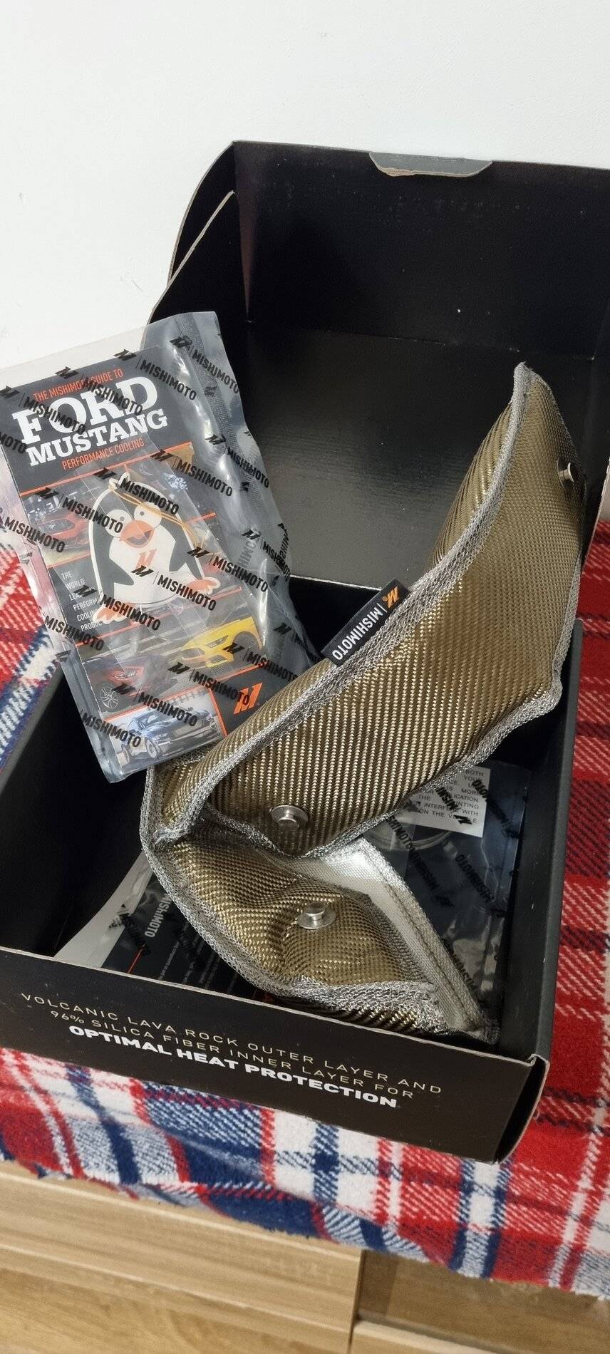

Just buy mishimoto turboblanket, direct fit for eco

Do you have a picture of it installed? I'm interested in getting this if its fitted for our turbo

I saw a pic of the turbo blanket on another site and it looks like it's a better solution than the tin shield. No idea if it's more or less of a PITA to remove/install.

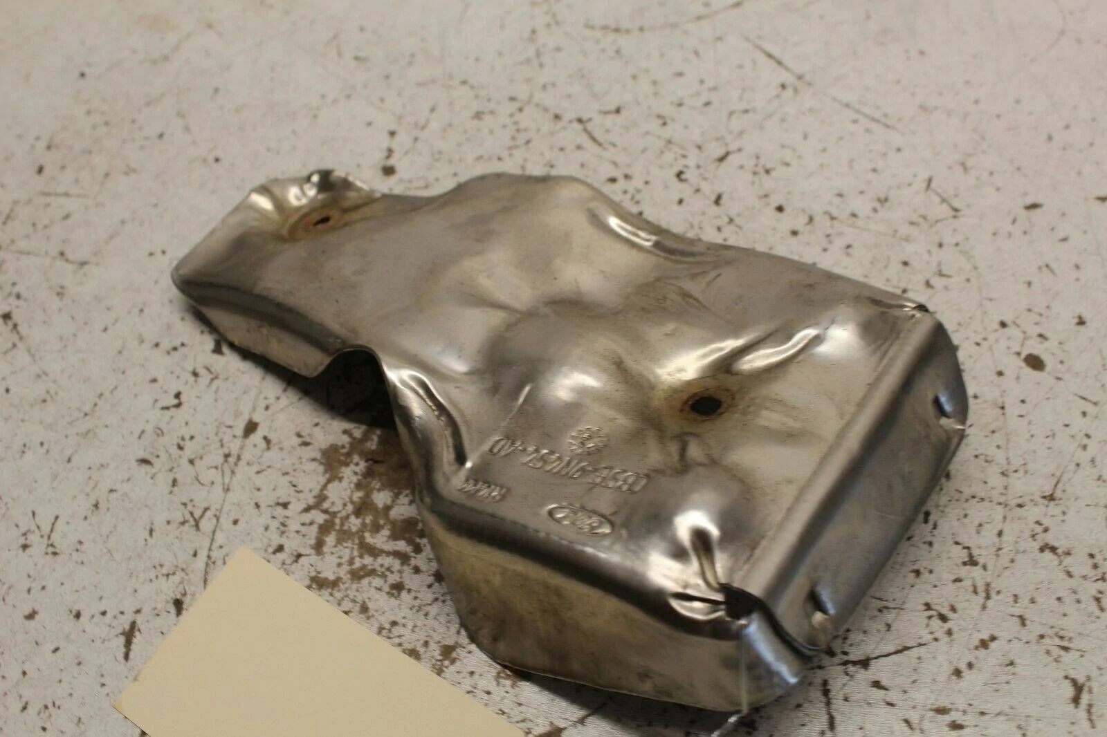

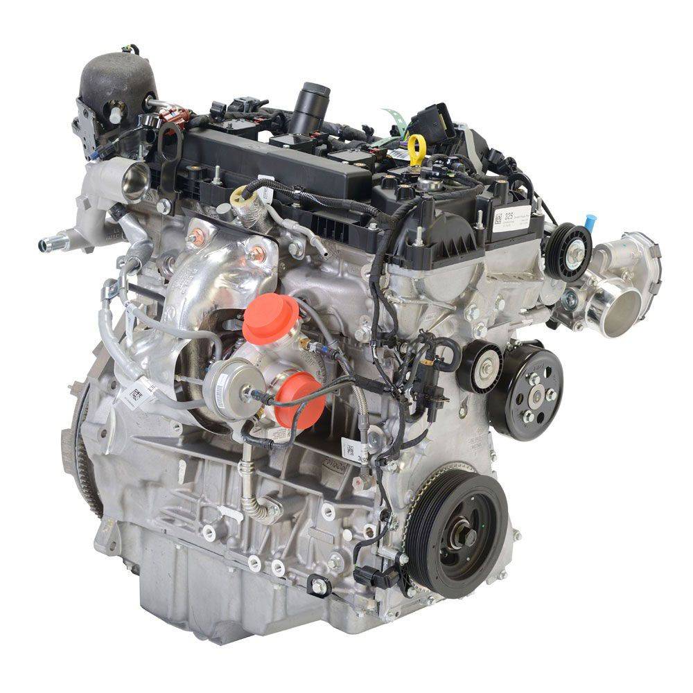

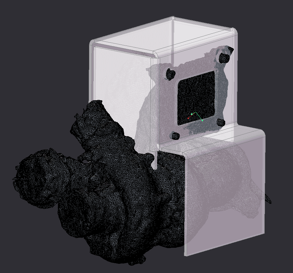

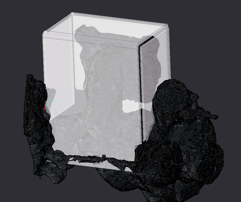

as much as i enjoy the idea of a turbo blanket, i would be worried about cooking the turbo during a 20 minute track session, even though it is water cooled. frankly the stock heatshield is there for liability reasons (hence the hot symbol), and maybe a bit of heat protection. the 2.0 ecoboost heatshield (pic1) is interesting, in that it sort of encloses the hot side. a lot of talked about ecoboom, but i'm wondering how much of that is related to the exh side being near cyl 2 and 3. assuming a glowing turbo radiating heat in that area would fatigue the part of the block that has been failing. i would really like to throw some inconel heat shielding to go between the turbo and the block in that area. i would also like to create an inconel enclosure with an airgap around the exhaust side, which is why i bought a stock turbo. Don't mind my rough cad model, not sure if i will ever actually make it.

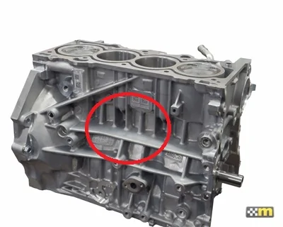

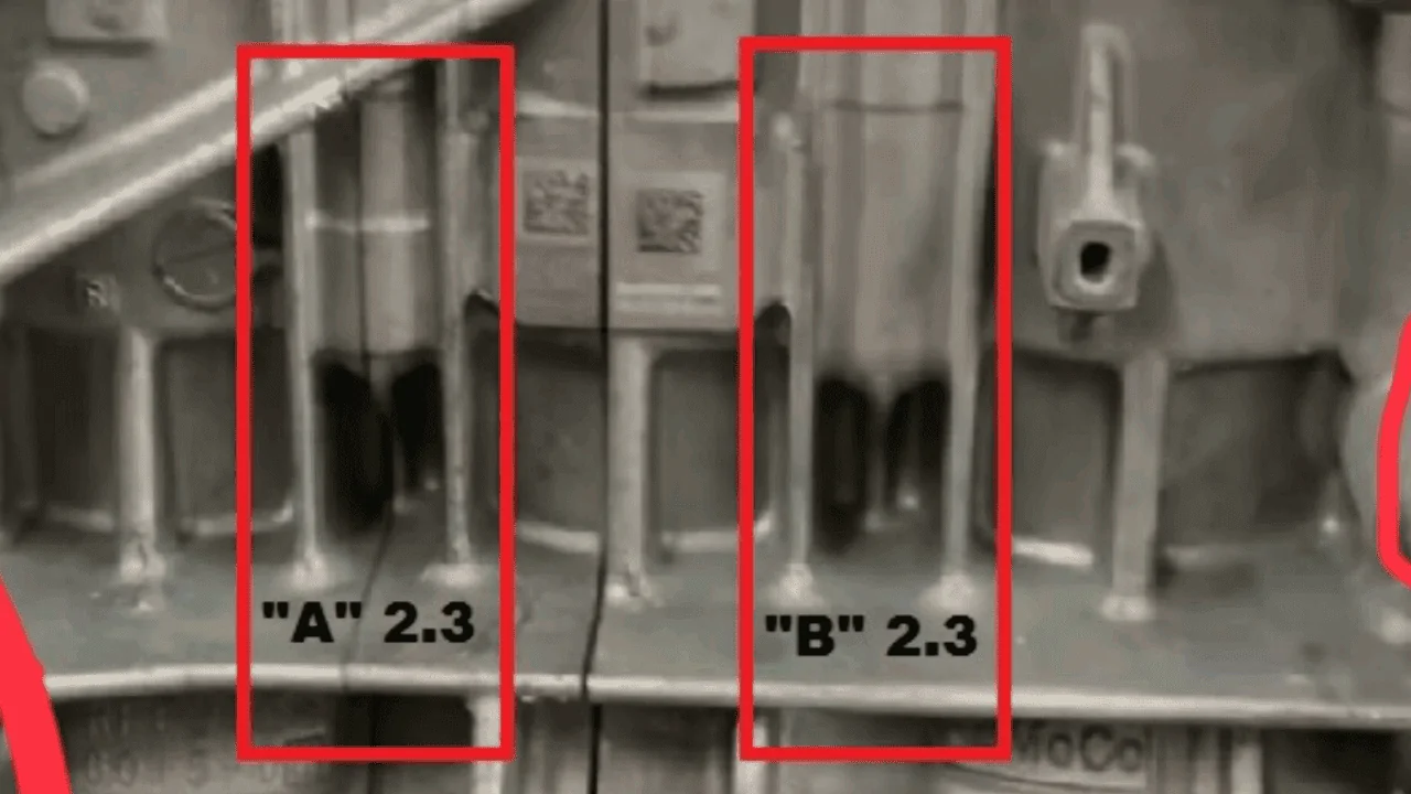

The turbocharger sits right in front of these 2 weak points of the engine block!?
