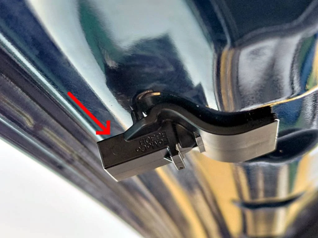

So the washer jet pushes out like so.

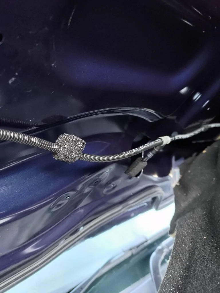

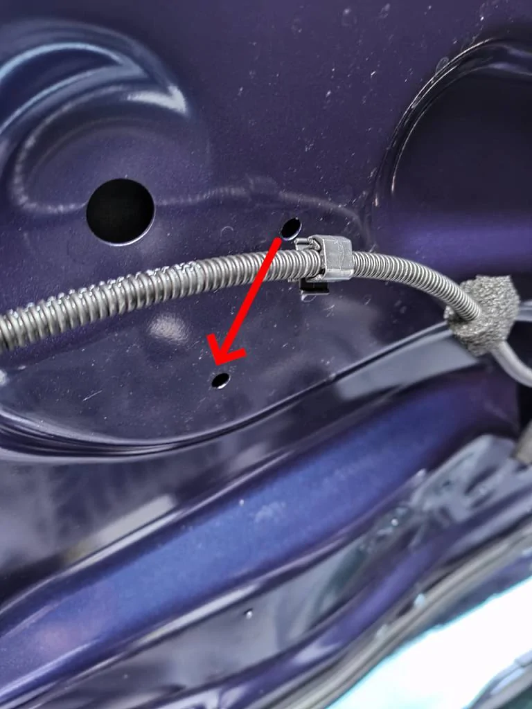

And then I removed some of the clips holding the cover up to gain access to the tube, and I just moved the clip holding the tube down a notch. This gave about an extra inch or so of length (oh my!). That should mean it'll never pull out again (oh my oh my!). 😂

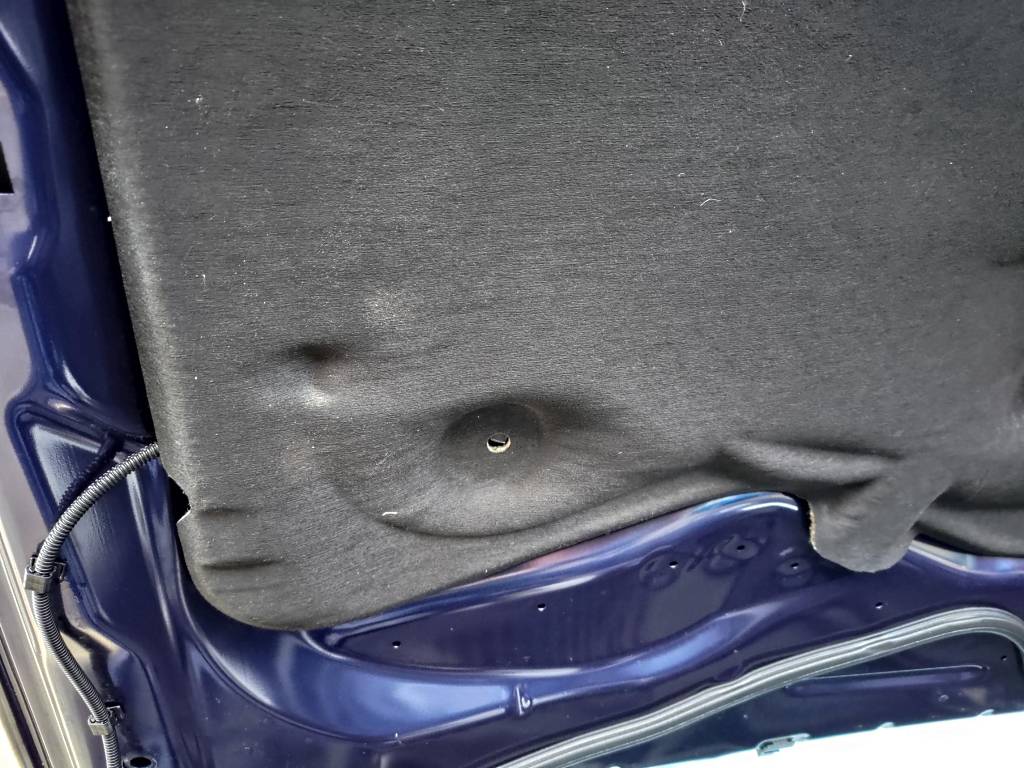

And then pushed the barb back into the washer jet as far as possible and reattached the cover in the engine; leaving the one corner clip off (as it can no longer go back in). If I get time I might make a new hole in the cover.
