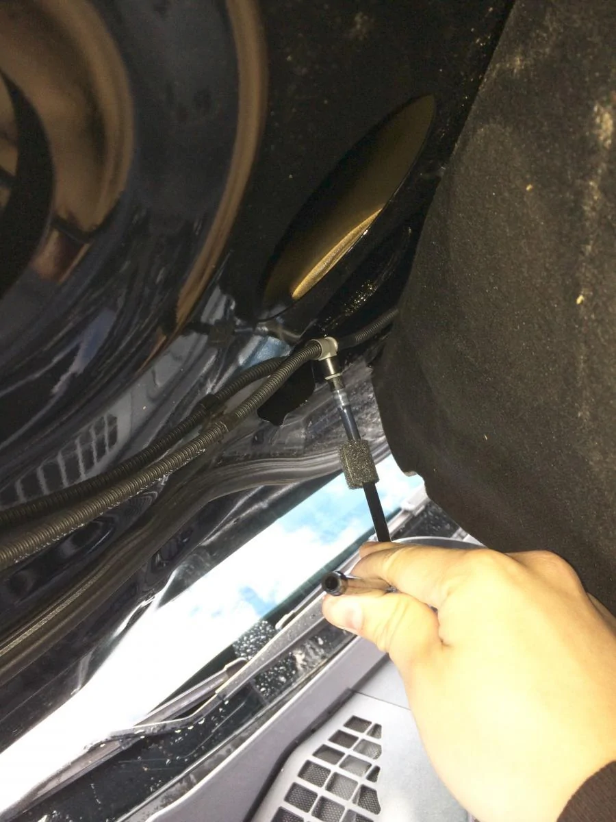

Found the problem. The tubing that attaches to some T connector for both jets is loose and I can't reattach it because it's inside the hood. It is now at the hospital ��

If you ran the washer fluid reservoir dry, disconnect the lines as recommended above. Then try blowing some compressed air through them.
Sometimes, the gunk that accumulates at the bottom of the reservoir fluid can clog the jets :doh: Happens all the time in my Wife's '07 Trailblazer, and doing this has saved us at least 3-4 visits to the shop :thumbsup:
