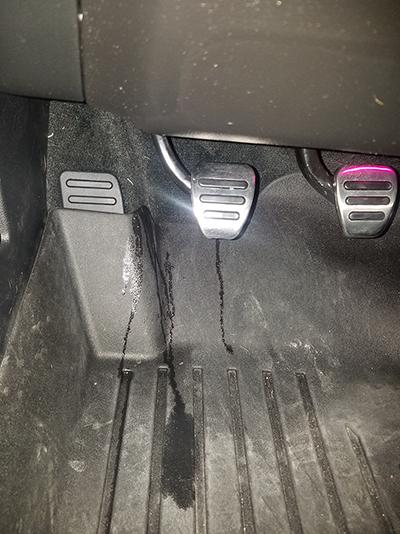

Sooo it appears this exact issue decided to manifest itself on my 2016 GT PP over the past week. I have cleaned up the mess about 4 times and after a 10 mile drive for commute, this is the result:
The car just hit 12,000 miles and took delivery in April this year. Off to the dealership it will go to confirm if it is a bad clutch master cylinder.
Anyone else have this issue? seems like it might not be too noticeable at first if you don't have the weathertech floormatts or something similar.
As an update: I took the car into the dealer and they verified the master clutch cylinder was defective and replaced it under warranty. The repair was completed in two days. The dealer did a good job and took good care of me with a loaded loaner Fusion while the work was done. The ecoboost fusion was fun, but glad to have the stang back.
