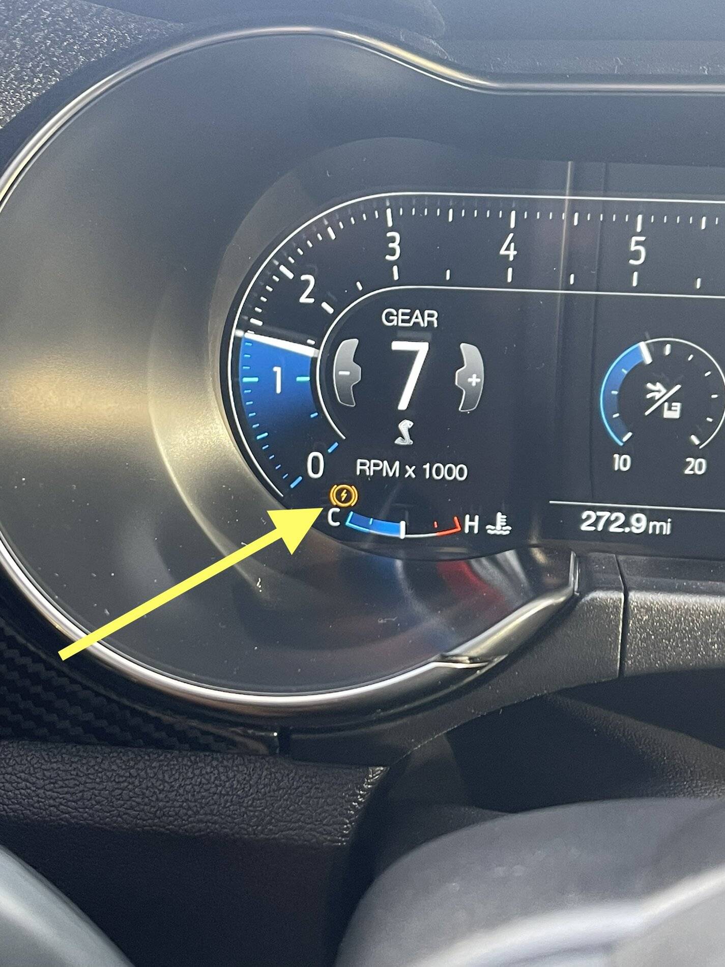

Yesterday this icon popped up after the car reached temp. I drove it twice yesterday with the same result. I looked through the owners manual and could not find the designation. Can anyone provide some help?

Definitely looks like it signifies something about brakes and an electrical problem.

That is what I thought initially, but the electric brake is a slightly different icon? But maybe?

check to see if any debris got in there, did you change tire size?

I checked to see if anything was dragging on the rotor, doesn’t appear to be. Earlier today I set the parking brake and disengaged. I moved the car a bit in the drive it’s currently not on. I will go for a short drive later.
I do have an 18” MT ET R currently on the rear. The tire size could cause the light to trip?

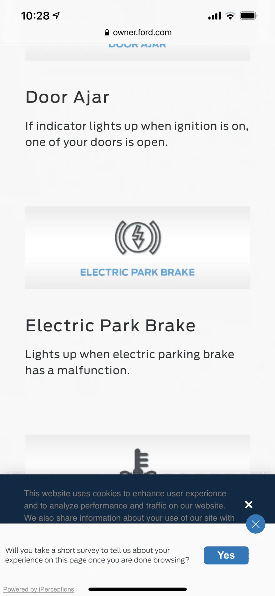

Found this on the Ford indicator light site:
