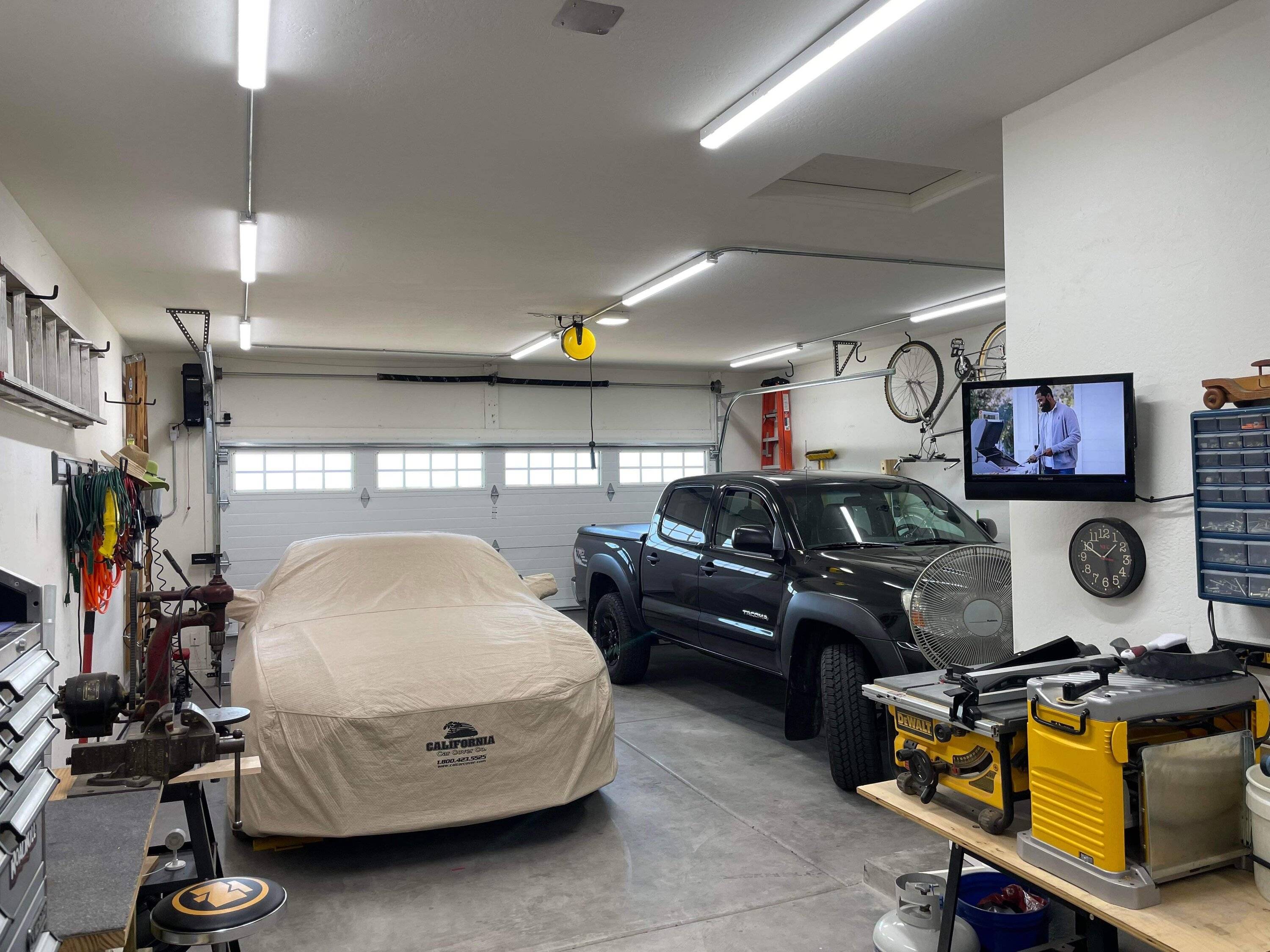

2019 Mustang GT Premium 401A, 2008 Toyota Tacoma PreRunner double cab
I’ve owned two of this model opener and love them. No problems at all for me.
