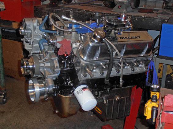

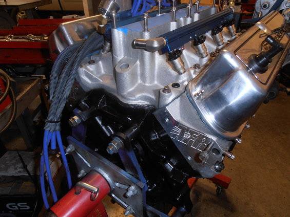

I'm with you KB. My GT500 went in yesterday for a 500 mile oil change and installation of the Air/Oil Separator, Front Splitter Wickers and Camber Adjustment Plates.
My flat tappet and roller engine builds usually start with high zinc and phosphorous Joe Gibbs Break-in Oil for 20 minutes, and then a dino oil change at 500 miles, 2000 and then +3000 thereafter. Rings should be fully seated at 8000-10,000 mile allowing me to consider changing to synthetic.
Now with the GT500, it has undoubtedly undergone initial break-in at the factory, so I will provide a synthetic oil change a 500, 2000 and then at factory recommendations thereafter, unless tracking.
I have found that keeping the early engine oil metallic shaving free extends the performance and life of the engine. Cheap insurance and peace of mind.
