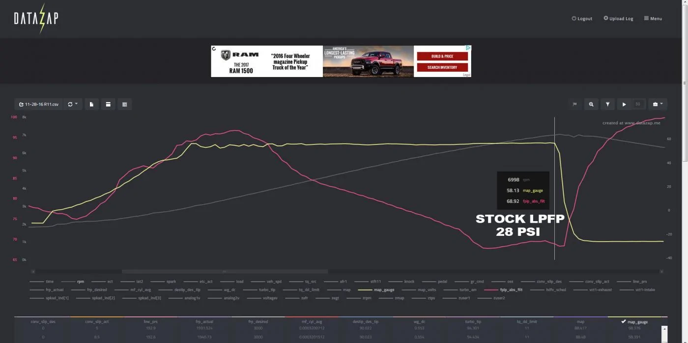

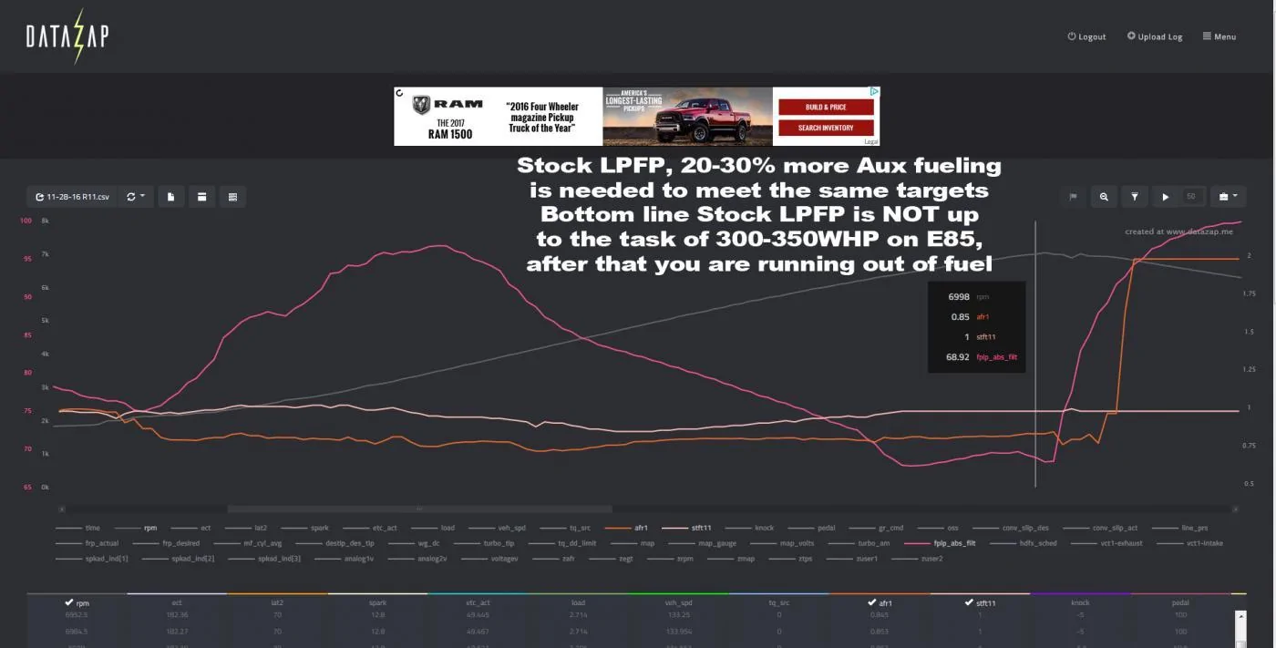

You can run any fuel you want on this pump, you can run any injectors you want. This pump is simply a higher flowing pump that feeds the HPFP system, which is the HPFP, and DI injectors. If you have an Aux system it fuels that as well. If you are on E85 at nearing 350WHP your stock pump is getting to the point where it can't keep up, and should be replaced. If you just wanted to upgrade for future power. This pump can be installed in a dead stock car pulled off the showroom floor, and would work perfectly.

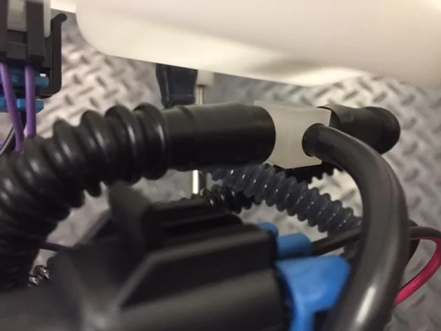

By drop in do you mean dropping the fuel tank and putting it in? I've not actually looked up the LPFP's on these cars yet.
You pop out the lower portion of the rear seat. It's located under it. Easy peasy.

Yeah this is a 10 minute swap at the most, unless you cannot find the tabs to push to remove the seat bottom =)
