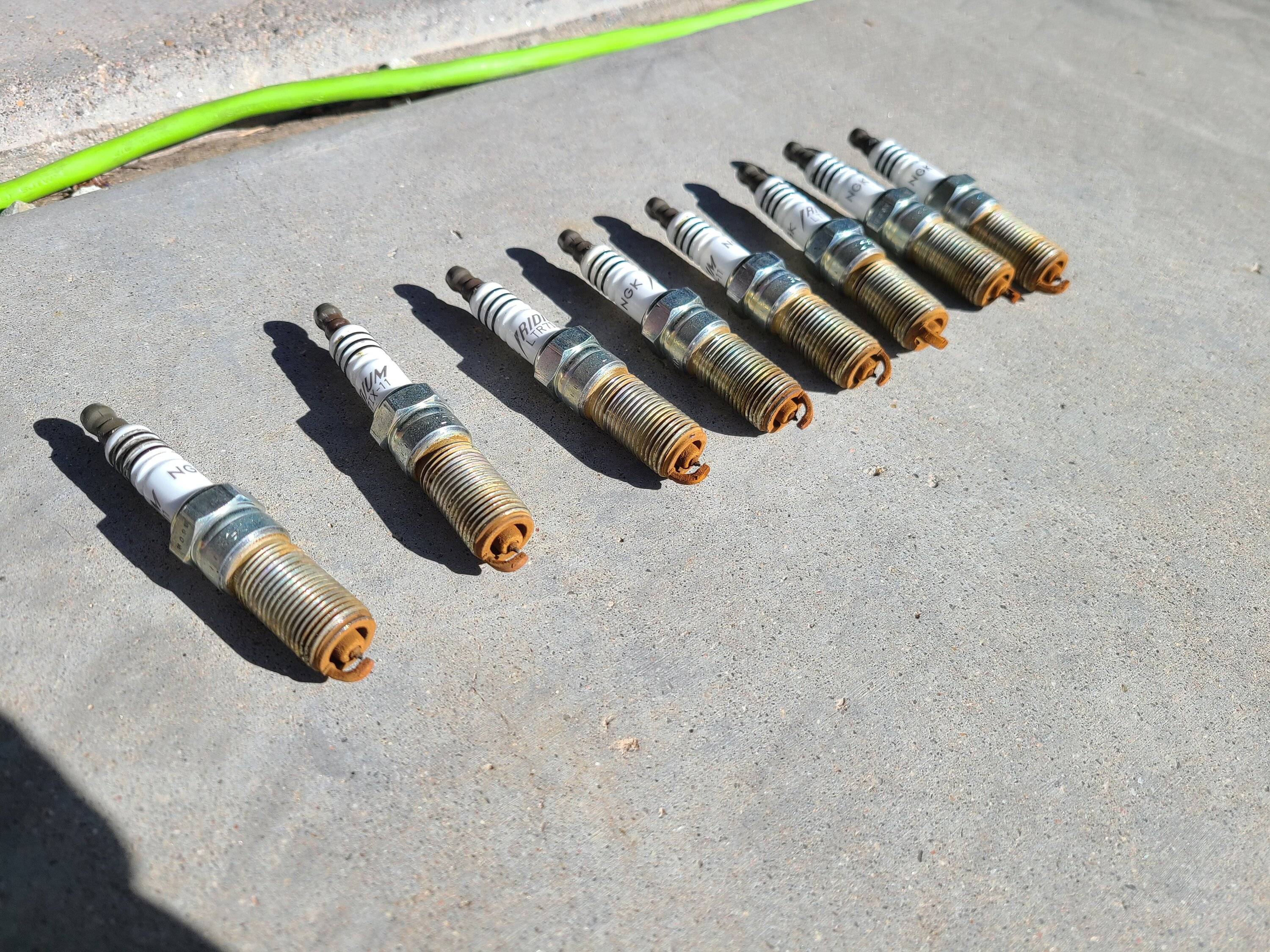

I've got over 71k on my car and 23k boosted. I've run boostane in every tank since going TT. O2s have not been changed but plugs and exhaust tips need cleaned more often. Here's what my plugs look like after 10k miles.

Good to know, plugs are no issue. I usually chance the every summer. Wonder if i can push it into the 9s with a pulley and the 132 tb on a good da.

Great to know as well. I haven’t changed my plugs and I have 45,000 miles on the car. I don’t run it every tank but I can’t wait to see what the plugs look like when I change them out.

It’s just MMT. Same additive used in Torco and a few others. No lead.

The MMT is what makes these octane boosters so effective. It's also what turns everything orange. Lol

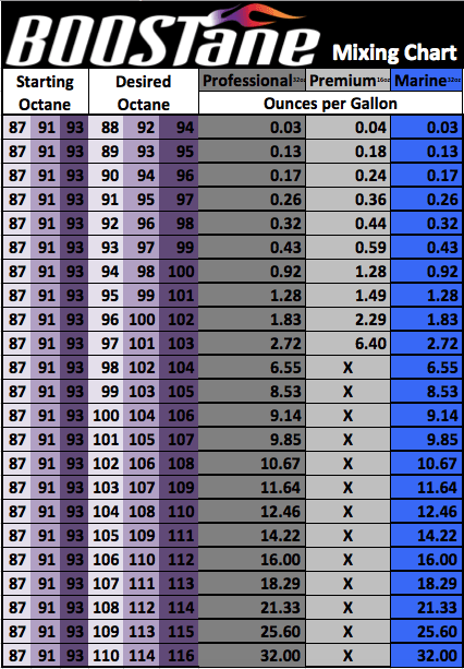

How much boostane per 93 tank?
