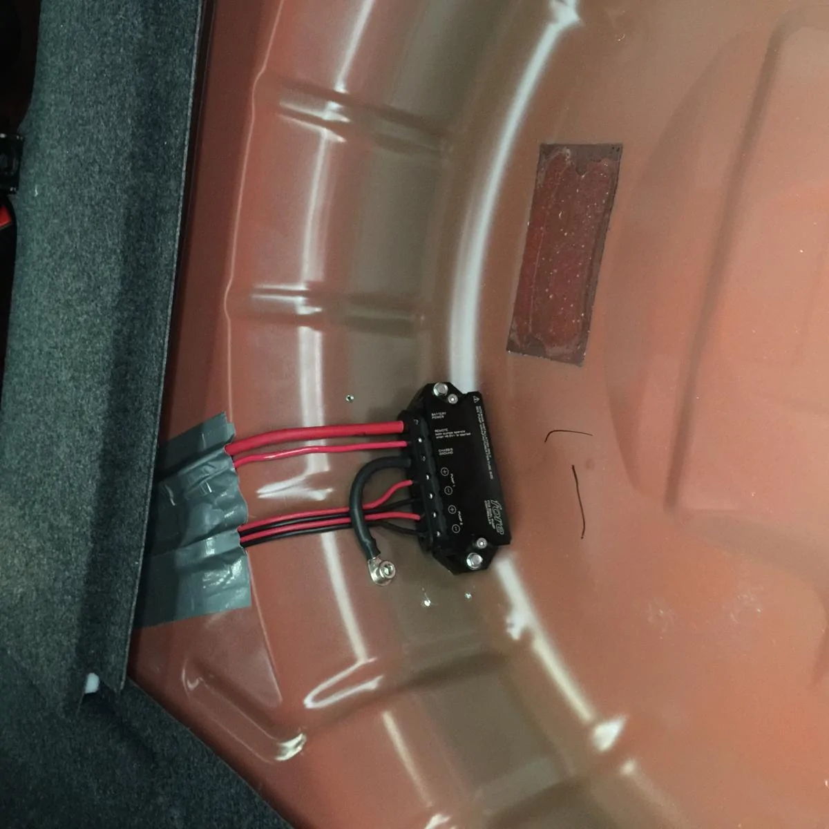

I received the standard Vortech bap in my beefcake special kit.
I know the fpdm is under the seat and I confirmed correct wire splice with Terry earlier today however I don't know if it's a good idea to mount under the seat or should I mount in the trunk and extend the bap wires to the fpdm
Anyone else with this setup? Where did you mount yours?

If its a pp car mount it I the spare tire area.

It is a PP car, I guess I'll just buy some wire to extend to the fpdm, the wires from the bap are quite short.

I mounted mine in the trunk using some extra wire. It's been replaced with a Fore fuel controller, but same concept.

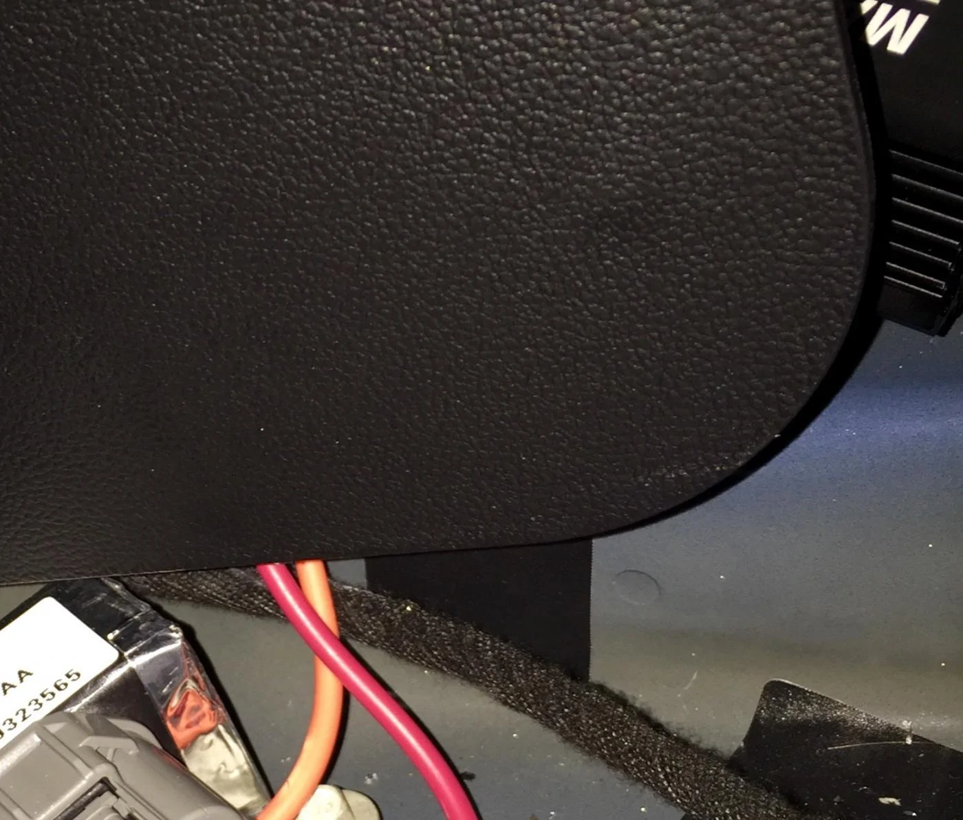

I mounted mine (same BAP) behind the plastic trim panel on the passenger side. Fit perfectly.

So not sure why I typed passenger. I meant the drivers side backseat panel, the wires on the BAP are long enough. Here is a photo. You can see the BAP from behind the panel. When the seat is in its location nothing is visible
