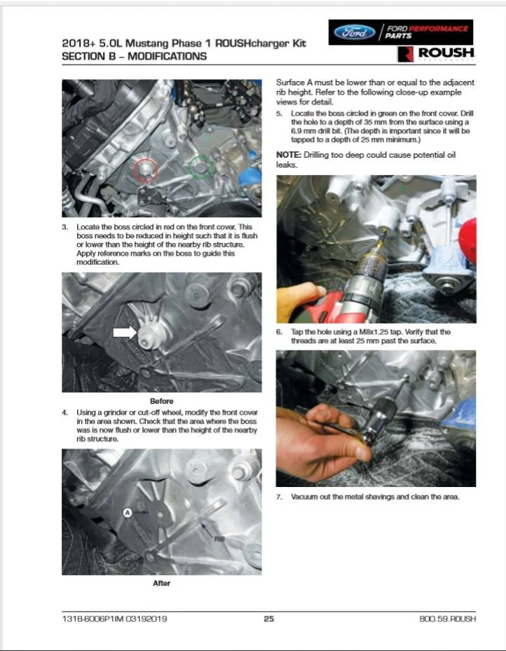

Just curious if you still have grind on the block for the 2018+ models like you did for the 17's and earlier to fit the Roush?
I have read the instructions and I don't see anything about that but I will not be doing the installation.
Yes, you do.
See page 25 in the pdf file.

Well, yep, it needs ground down. Not sure how did I missed that....
