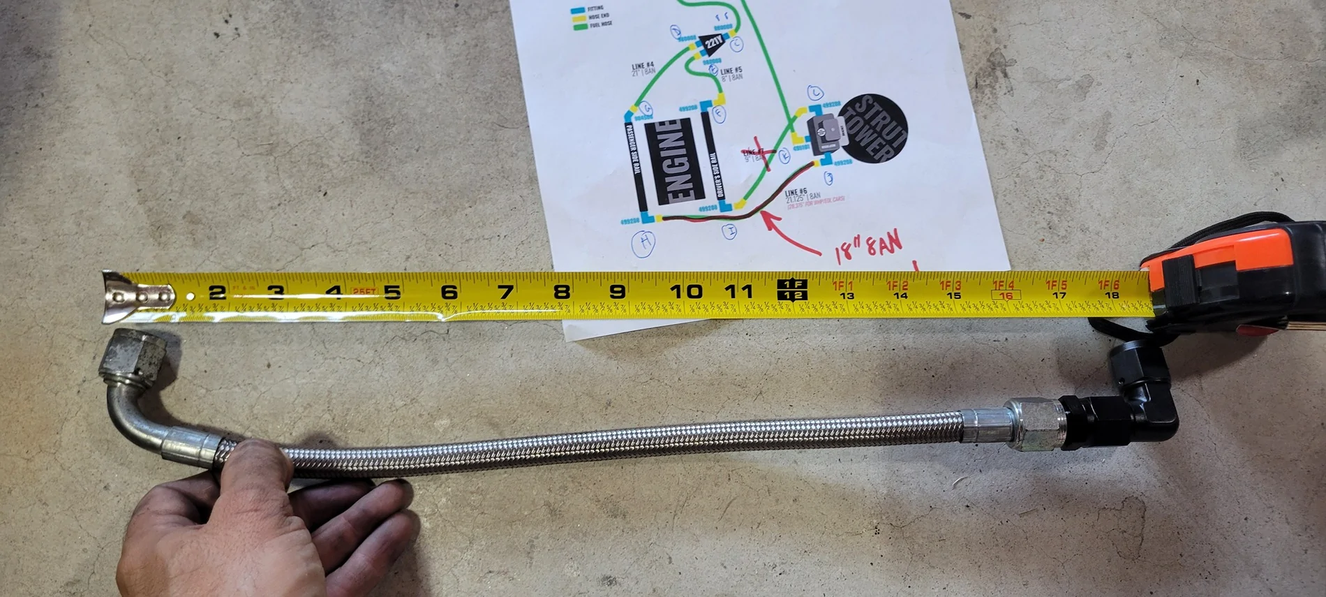

I'm working on mine now... the main issue is the routing of the lines...
I am waiting on a 18" line to come in the mail to route across the front to go from passenger rail to the regulator. The regulator has to mount right above the driver side fuel rail btw, no room on the driver side strut tower

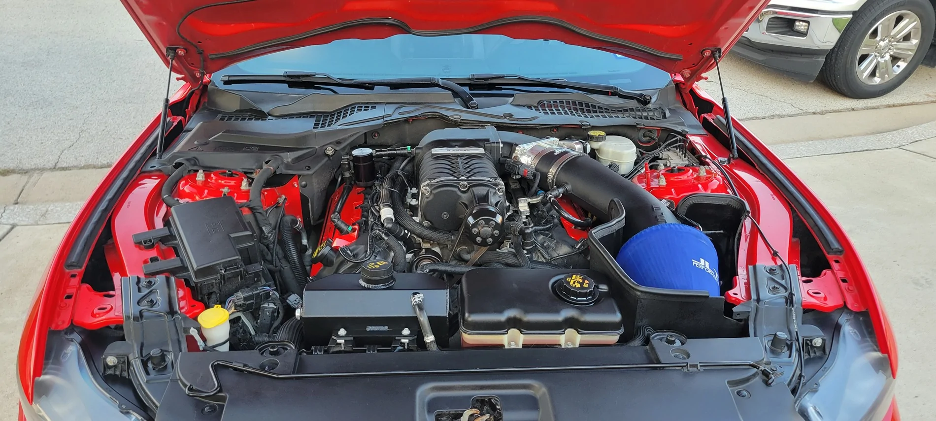

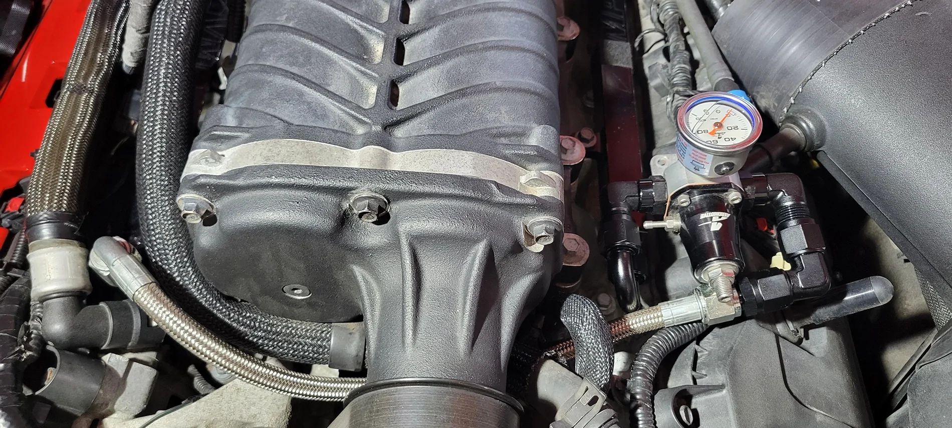

Hey i have a VMP gen3r and currently maxed it out. In fact i currently have my blower and lower intake off the car getting ported.
I have my fuel regulator mounted on my driver side strut tower.
I have mine setup to where the fuel pumps provide direct fuel to both vmp fuel rails through a y-block equally feeding them from the rear, and then both fuel rails feed from the front to the regulator. The regulator then discharges back to the fuel tank.
Currently dont have great pictures of it but could grab some later. Mind you all my lines are custom.

Nice. Looks like you have more room by your cold air box than I do. Likely the JLT intake i am using.... I test fit with the regulator and there was just no way
mepawn
Jan 24, 2024
163
81
Ohio
Joseph
2016 Mustang GT
Yeah I custom fabbed my cold air box for my PMAS intake

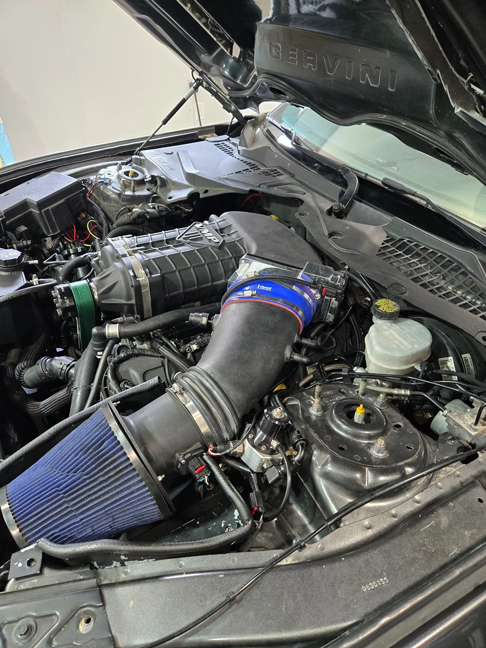

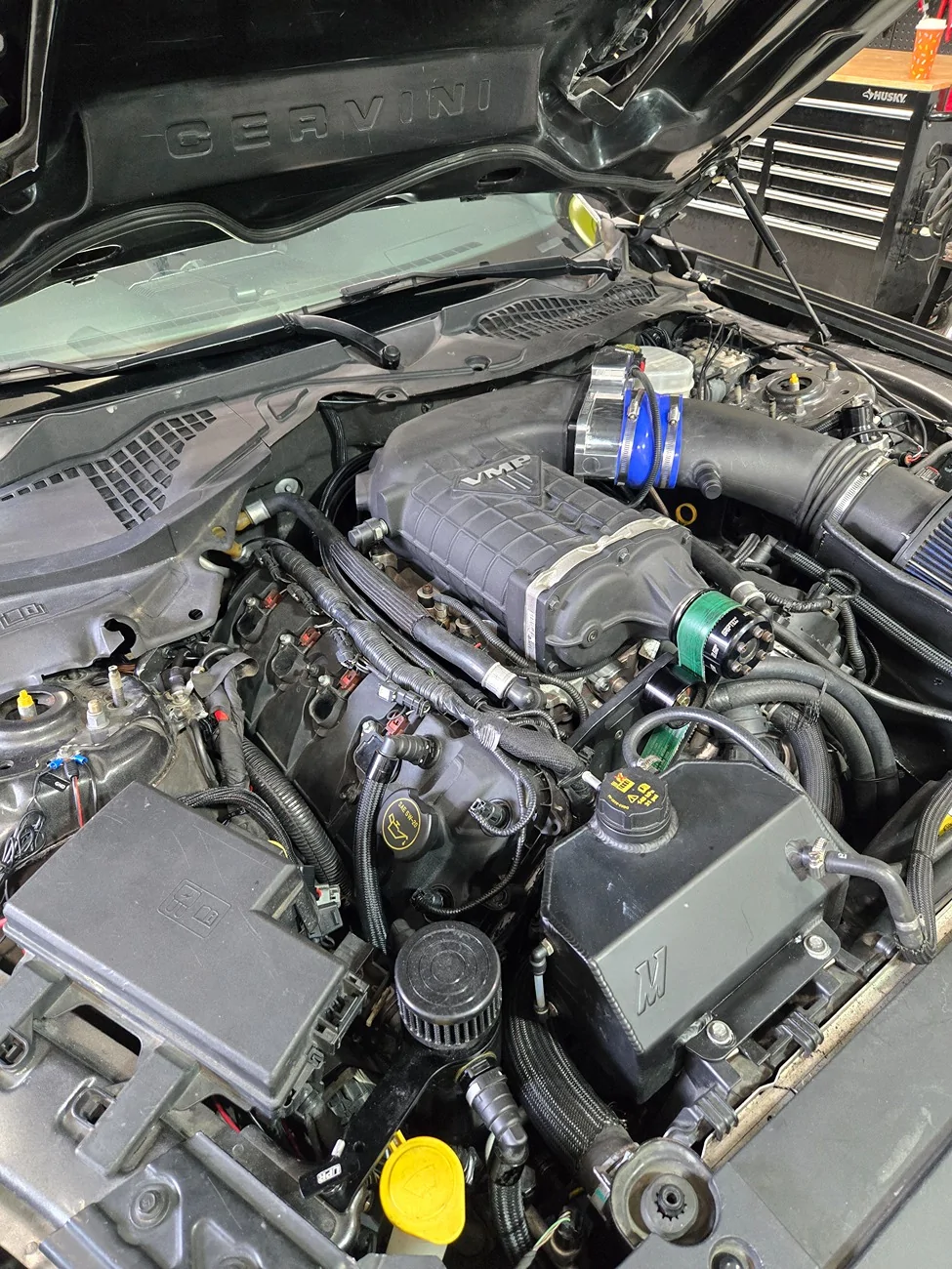

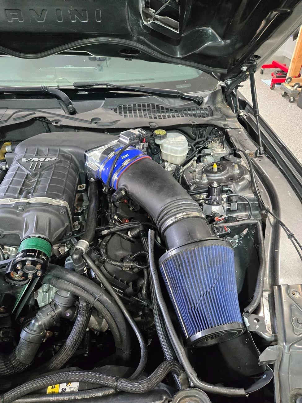

Same here. I am going to try to mount it on the driver strut tower further back below the intake tube. Waiting on my new injectors to get here.

Ended up keeping it on the strut tower. Just a little bit lower. Thanks for the ideas guys.
