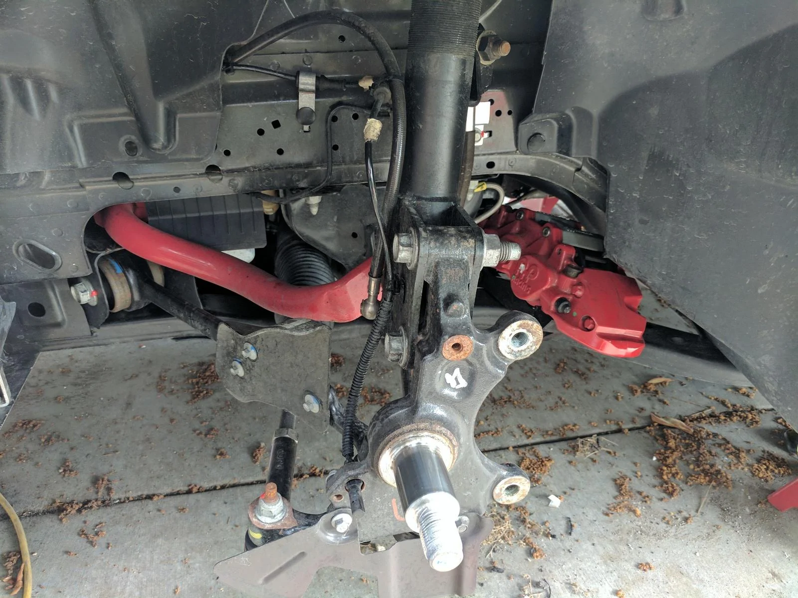

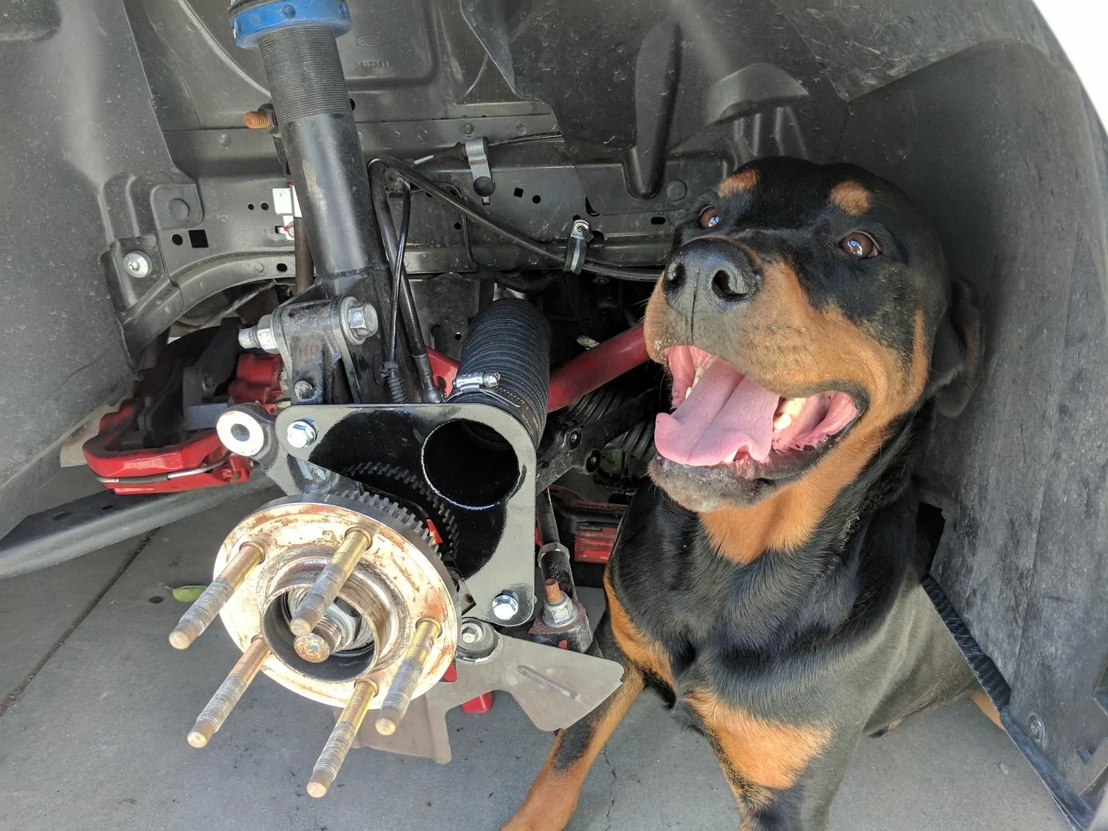

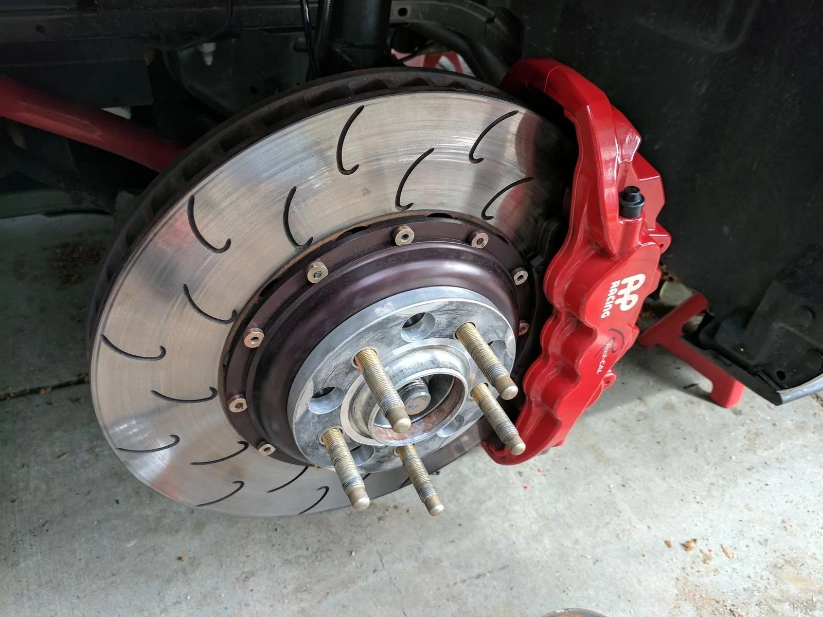

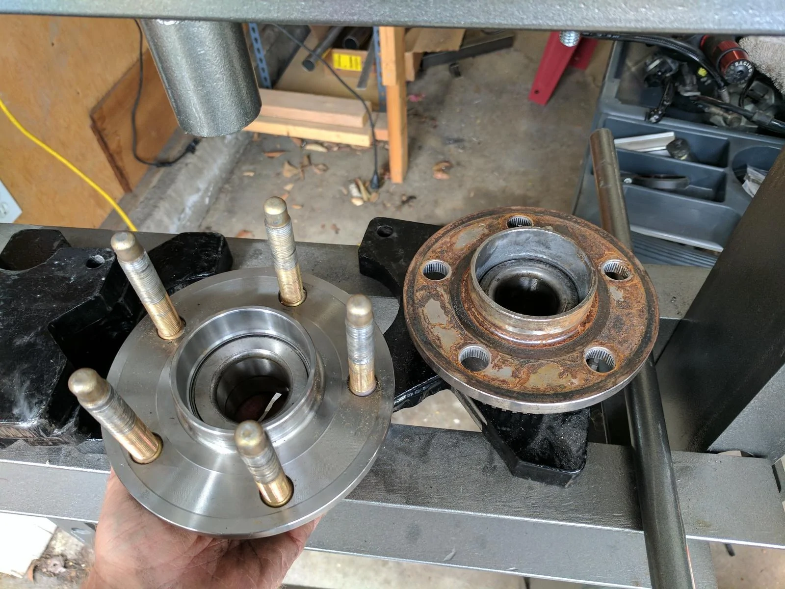

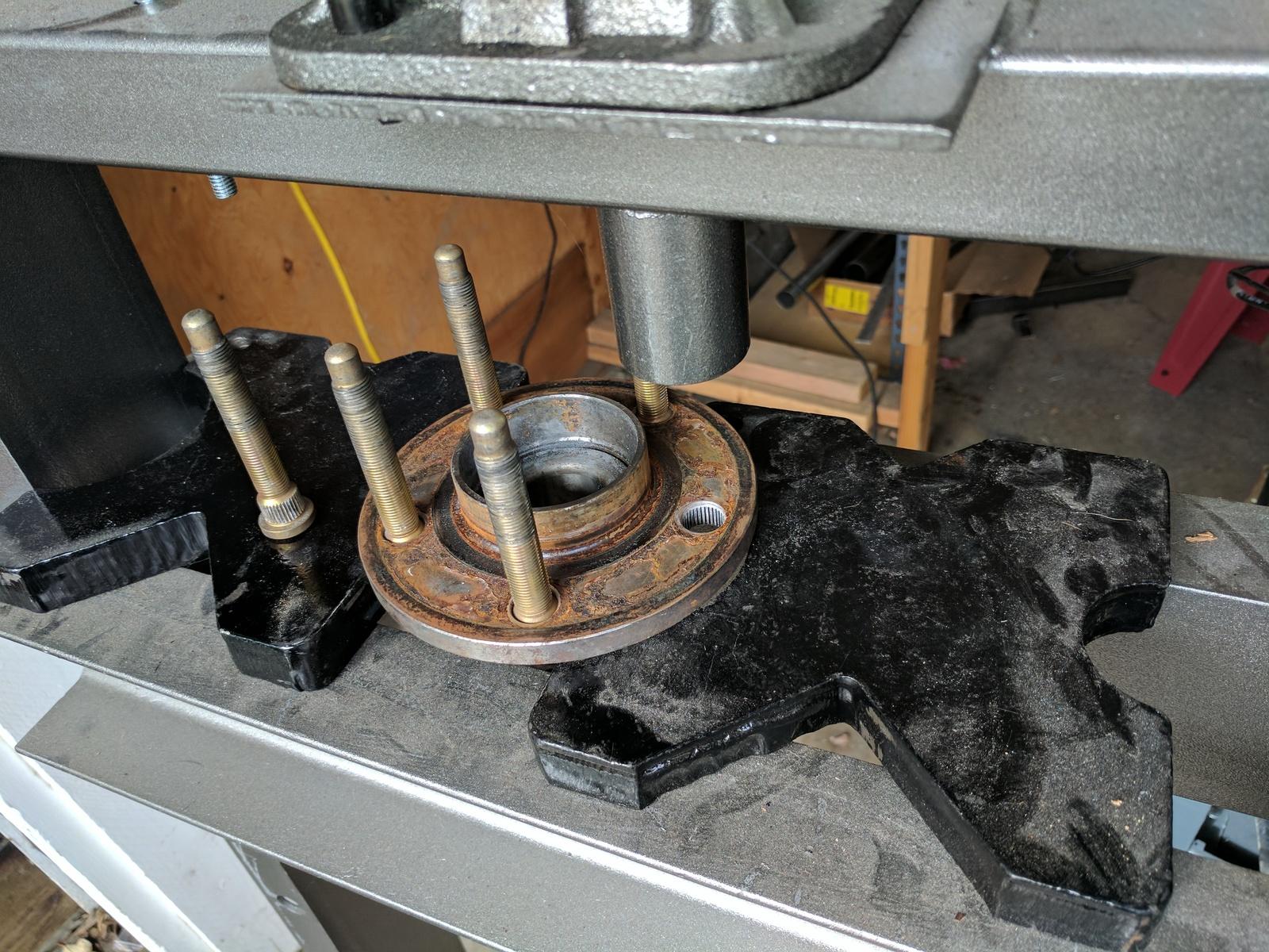

MOOG hub / bearing service on all 4 corners - had some bearing noise coming from the front right so decided to do all of them. Just pulled the whole spindle / upright off the back to make it easier
Did you have any problems with the ARP studs and moog hubs? I just ordered some moog replacements, and having a guy tell me that you can't use ARP studs with them due to the seats
