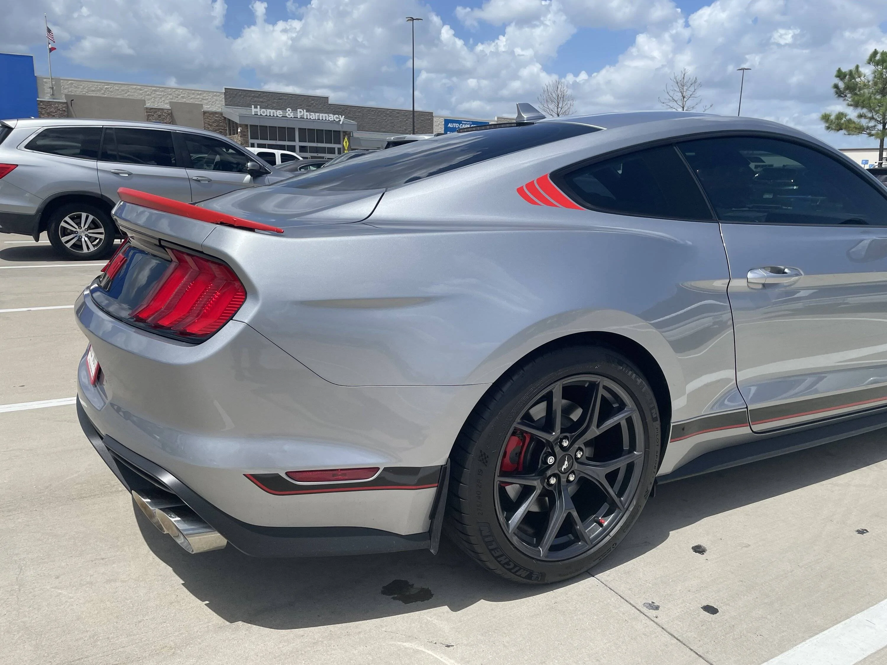

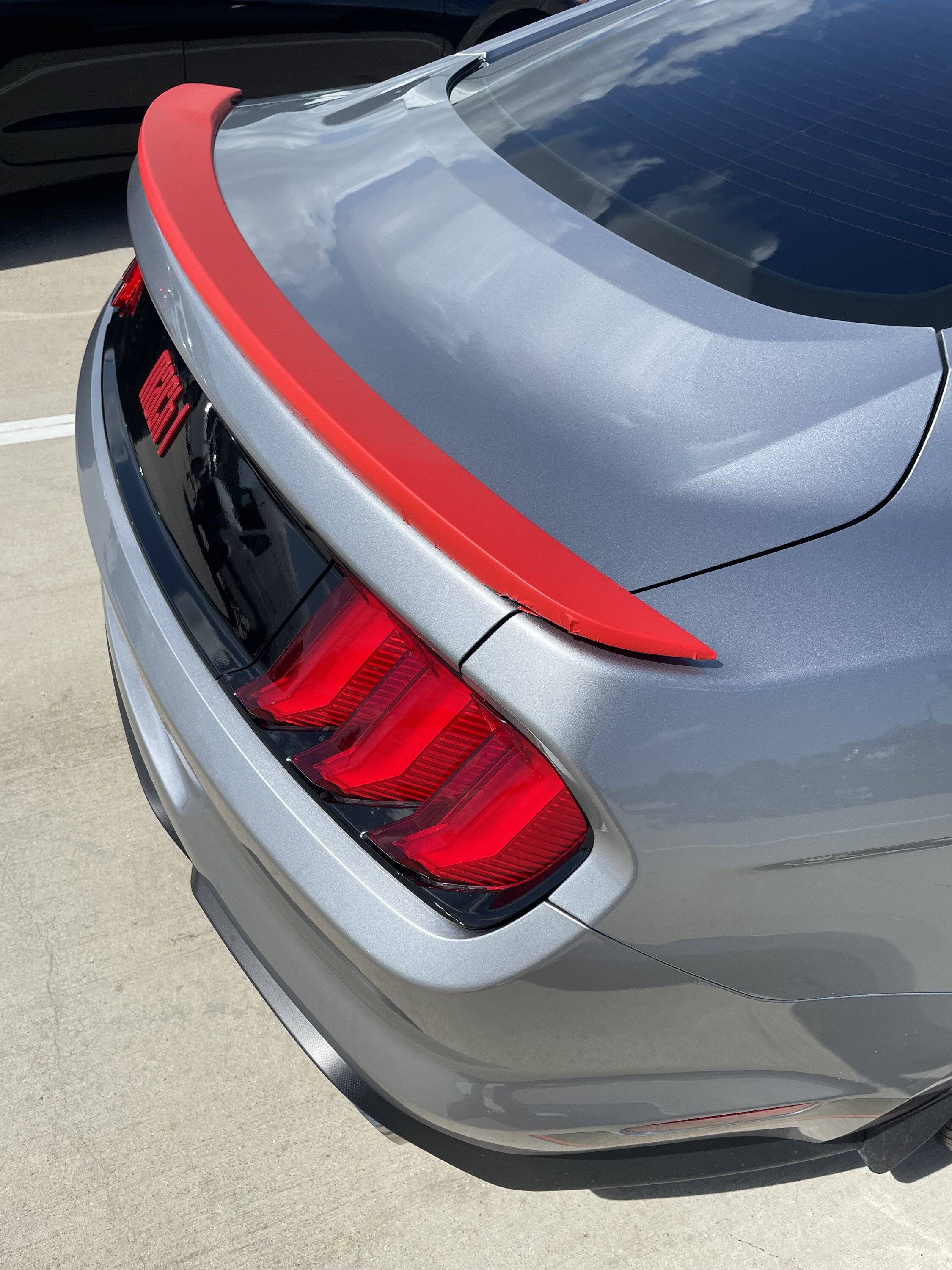

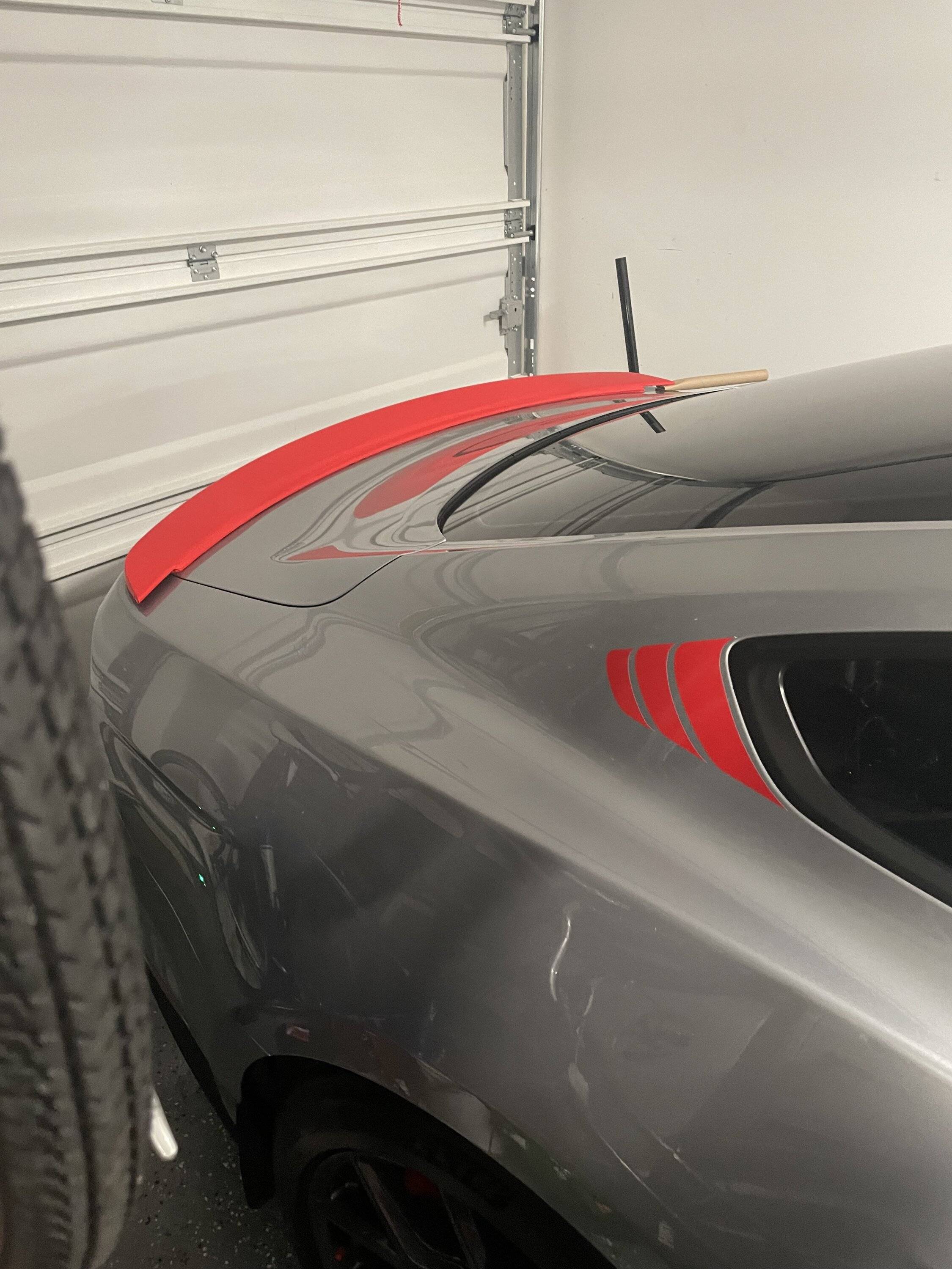

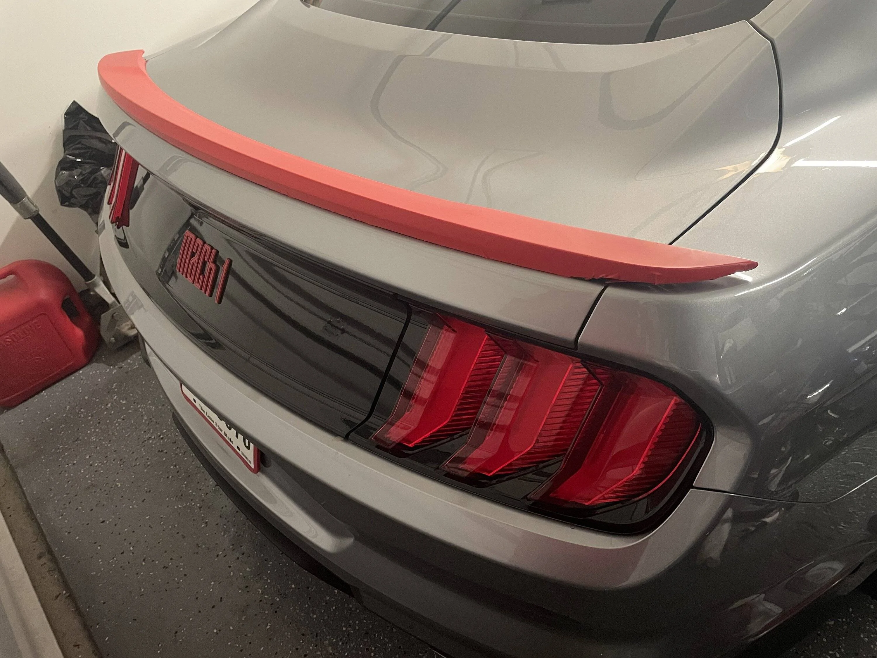

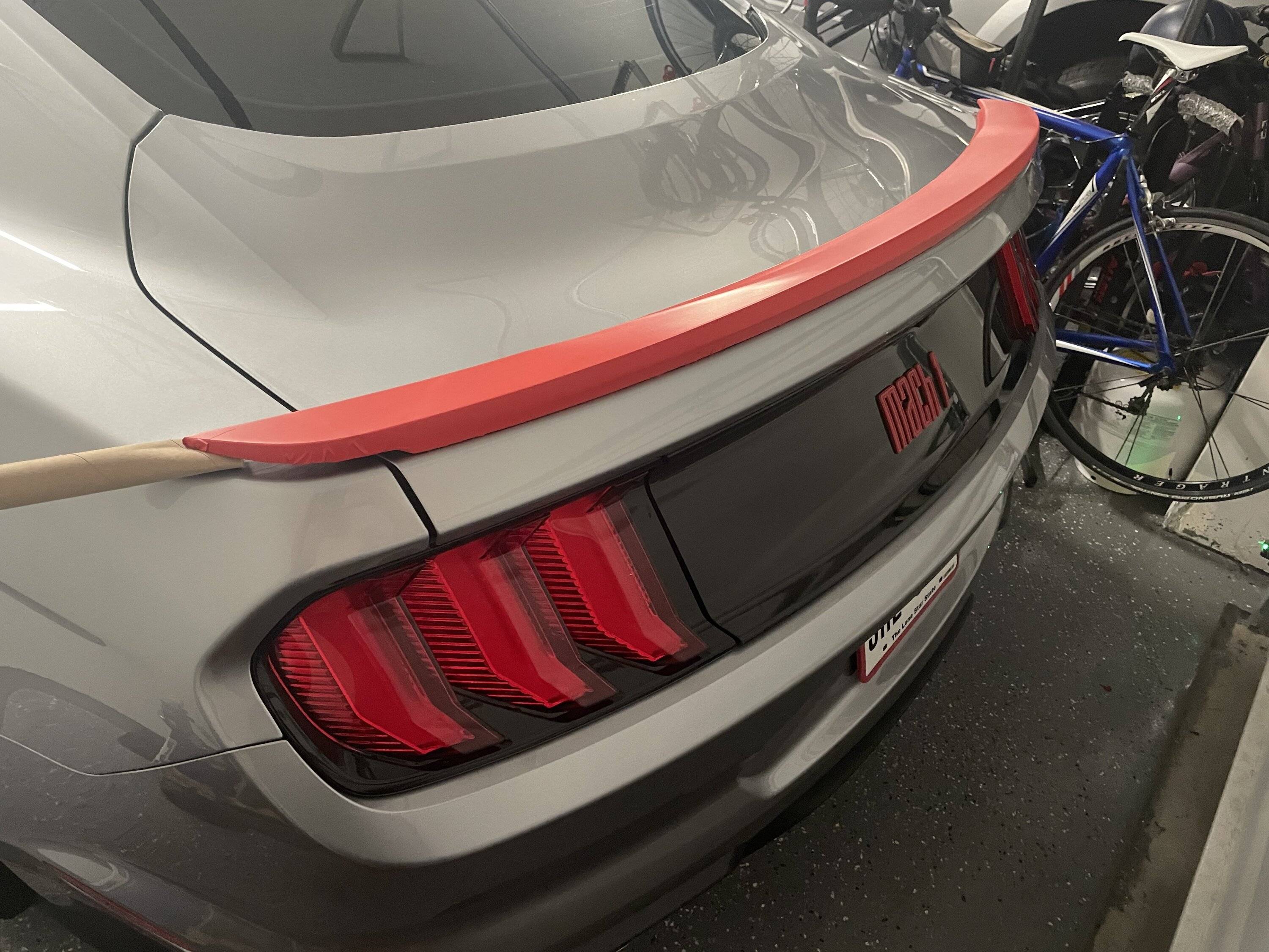

For sh.ts n giggles, I did a vinyl wrap on the non hp spoiler with mixed results. Easy enough to do and decent looking but up close, my skills or lack thereof showed. Maybe a matte black plasti dip if they make it is another option you can explore.
