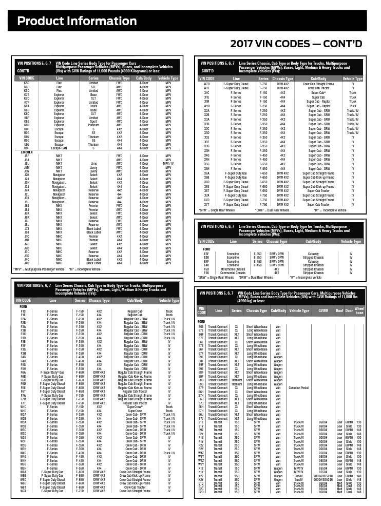

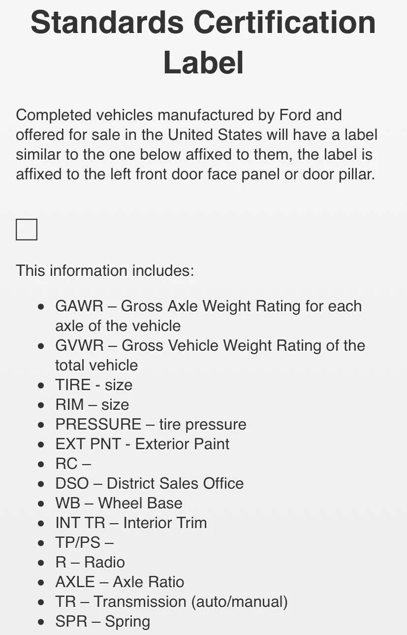

The VCL (Vehicle Certification Label), found on the driver side B-pillar with door open, is broken down as such:
Cobra Jet
Feb 12, 2015
771
17,595
20,037

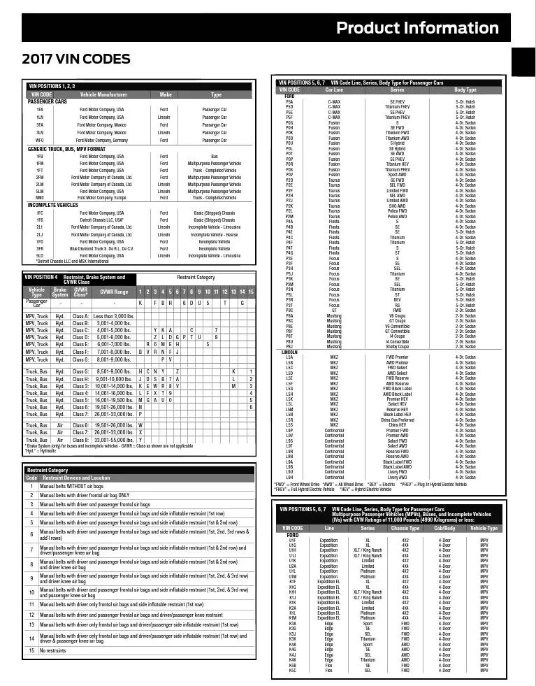

The VIN is broken down as such:
NOTE: the data presented was found online via googling and is only for the 2017 model year but displays how a Ford VIN can be pieced together.
Again, this does NOT give any insight as to all of the As Built features or what available options the car was selected with or packaged with for assembly. This type of data also changes every year, so what may be applicable to a MY 2017 breakout may not carry forward for MY years 2018, 2019, etc.
Complete build information would only be gleaned from:
1) Window Sticker
2) OASIS
3) ETIS
4) Ford Motorcraft site listed in the DIY sub-forum for finding vehicle “As Built” codes.

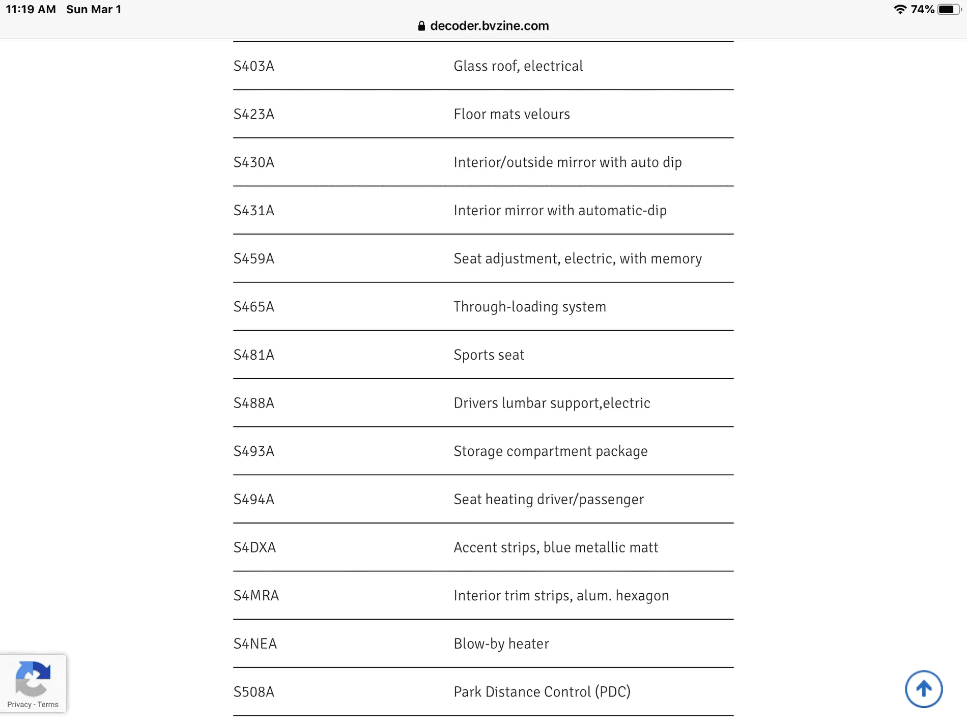

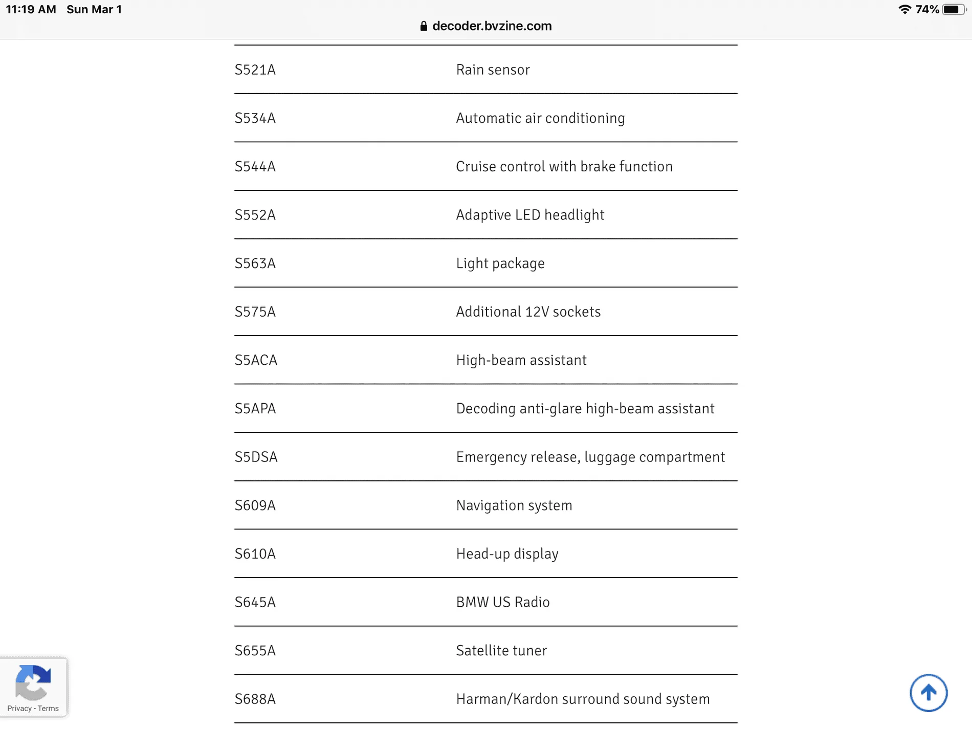

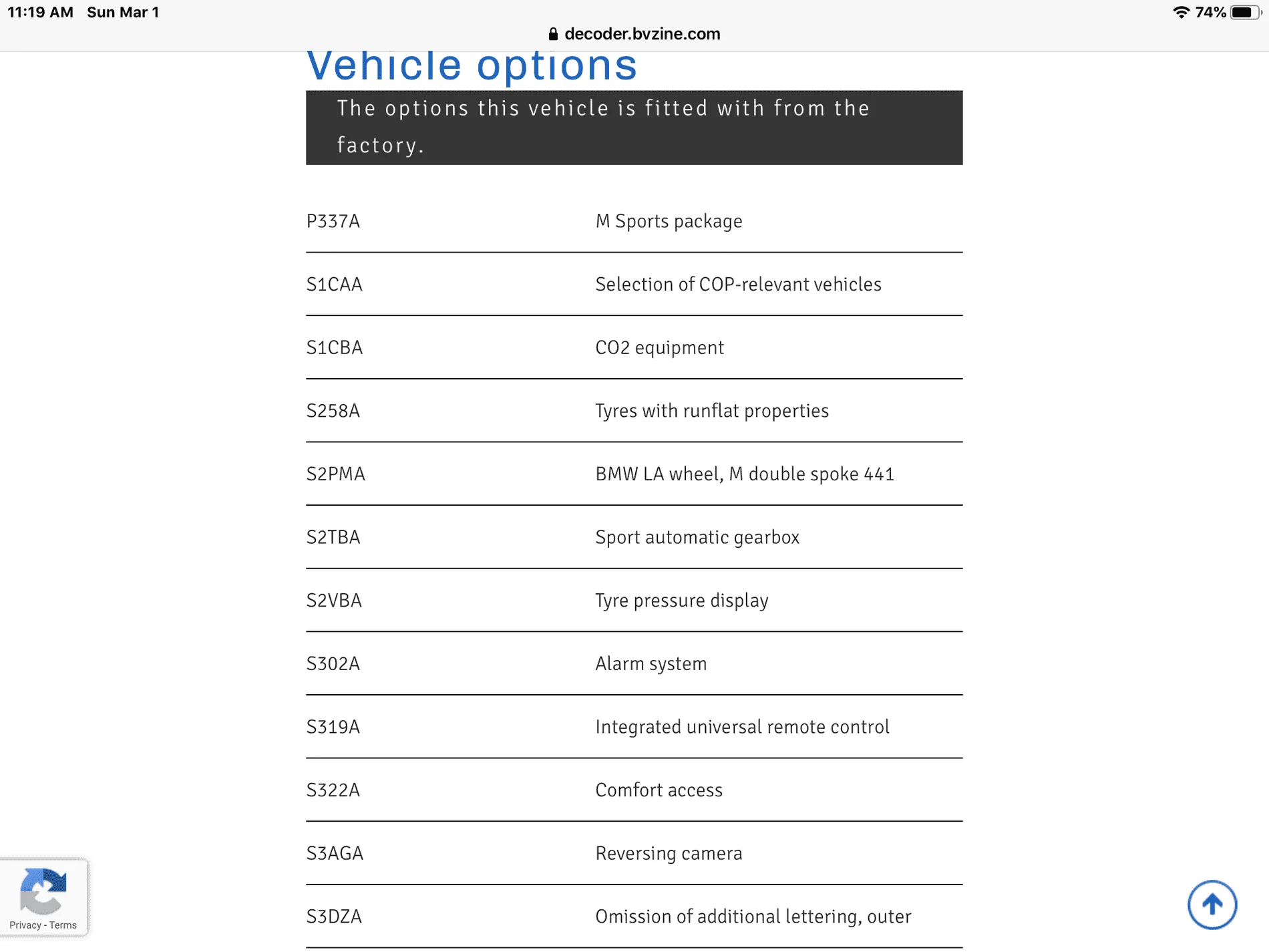

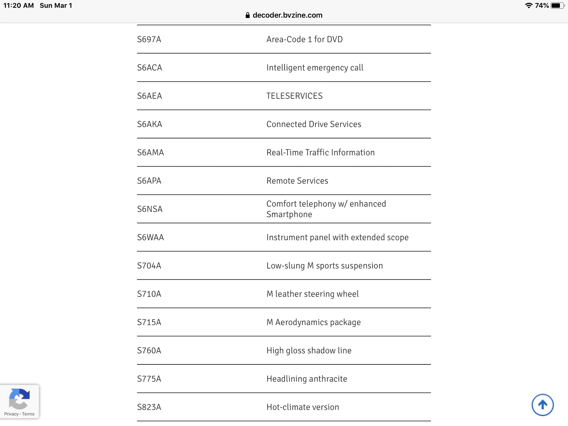

Would be nice to be able to access our builds online though, without having to jump through hoops. Here’s what it looks like on my BMW
Cobra Jet
Feb 12, 2015
771
17,595
20,037
What you are displaying from BMW is exactly what is available in Ford OASIS, which is not public access.
Do you happen to have those attachments in a higher resolution? Or a link to the originals?
I can't read some of the smaller parts. :blush:
