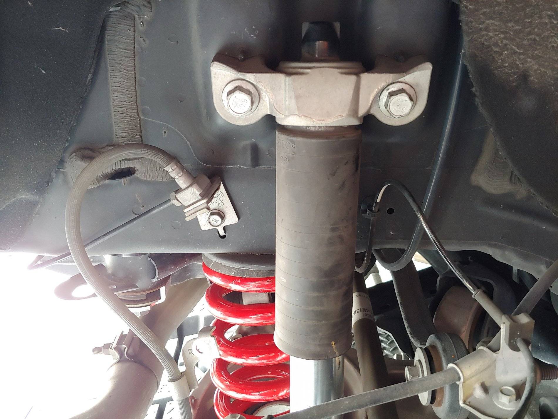

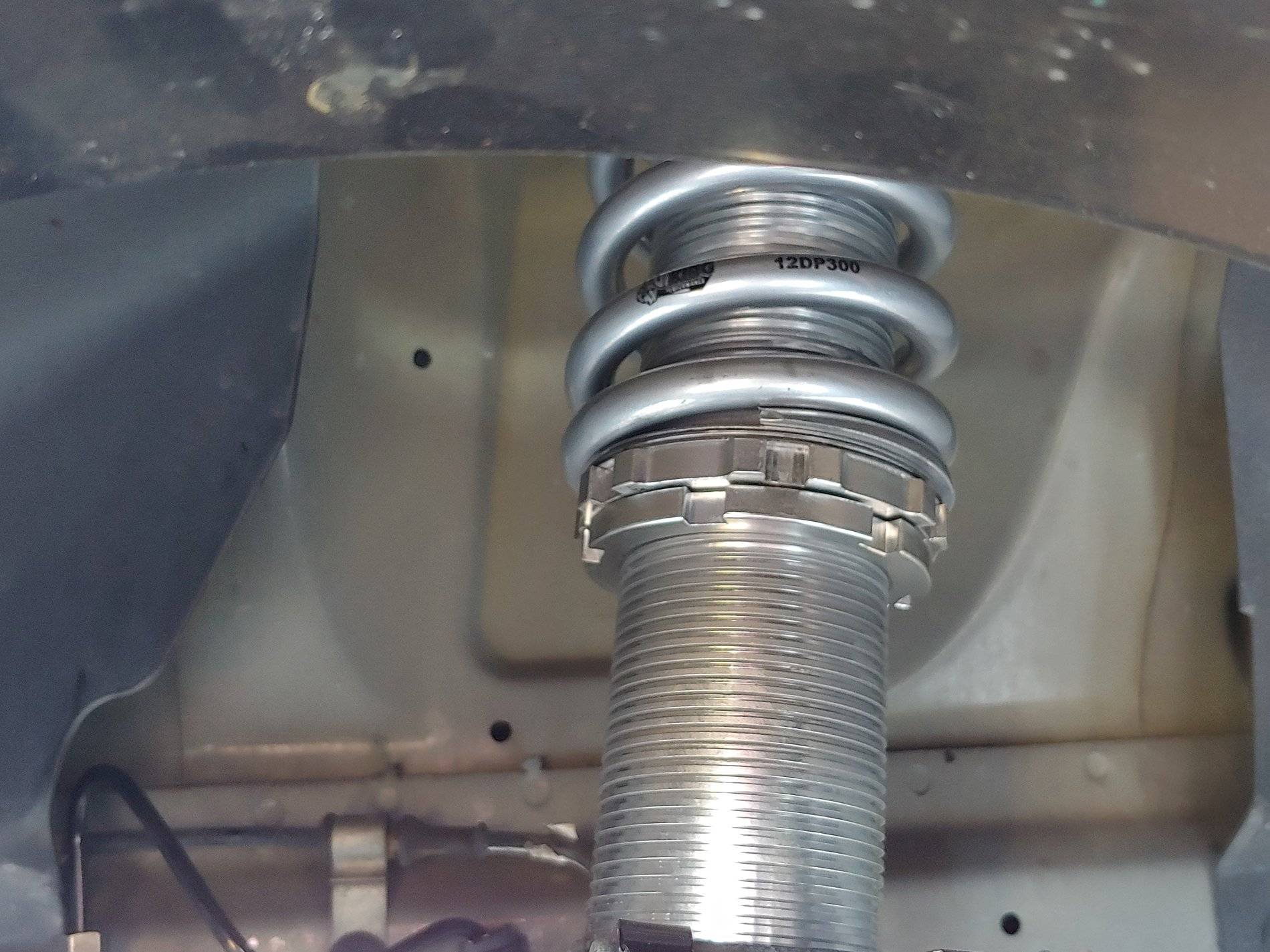

I have put a total of about 39,000 miles on Viking shocks with no issues at all.
Just put a full set on my 2016, front and rear. They ride great and I still to this day have not had the rattle or click that some people claim to have.

Good to hear. Are you running the front coilovers? If so what are you using for the rear?
