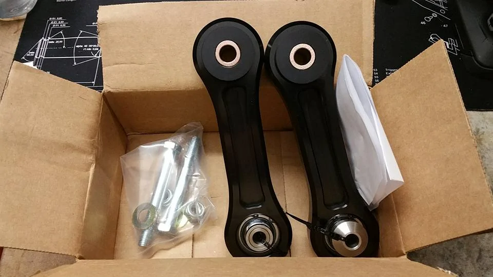

I am not sure of the issue - the only thing I can think of, is you stripped the threads.
To clarify here, the lower bolts are to be torqued to 129ftlbs, the upper bolt is 81ftlbs.
From what you have stated (PM) you did the opposite, and that is your issue.
Send me another PM with your address and I will get some bolts sent out, OR....go to the store and acquire them.
M12 x 1.75 threads and they are 100mm (4") long.
Keep me updated.
Couple of quick questions:
1. When you say lower and upper bolts, lower is the bolt holes closest to ground yes?
2. Do I need to apply any grease of any kind when installing these?

No problem.
All new bolts etc are on the way. ;)
Its posts like this which is the exact reason I chose BMR products, this is customer service at its finest.

Just got mine from UPS this AM...getting this & more suspension goodies installed in the next 2 days.

The most beautiful vertical links on the planet right there. Great choice. ;)
Just wait until we release our other components in the near future, like our billet aluminum CC plates and billet rear upper camber arms. Muwahahahaha.

Lol I actually considered that while struggling to cut the bolt out. Was thinking if it's this hard to get the bolt out maybe it's fine if I just leave it. Got it out tho. These vertical links are much nicer in person than the pics show.
