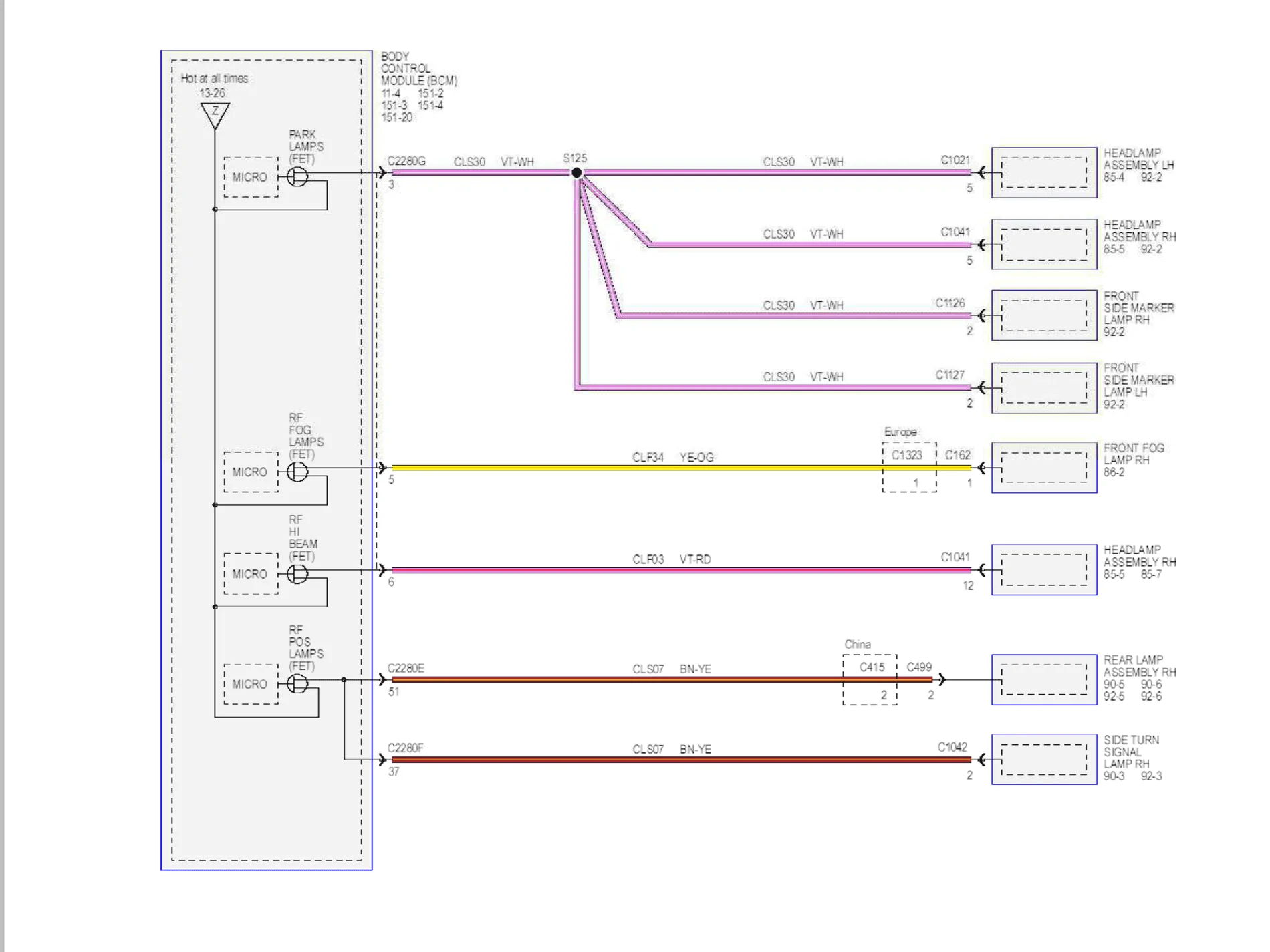

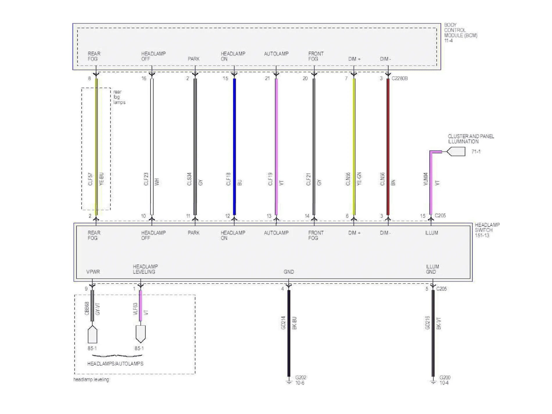

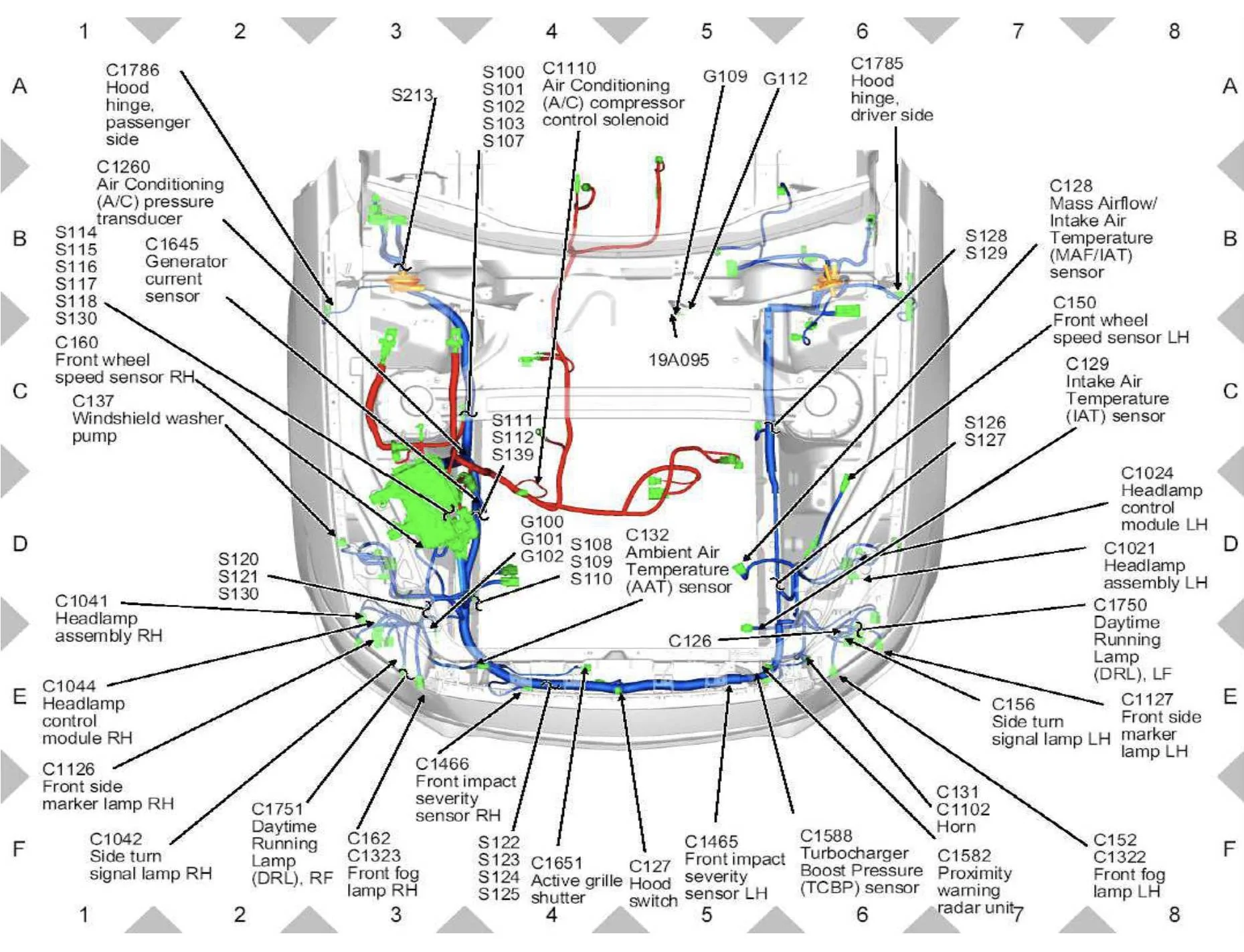

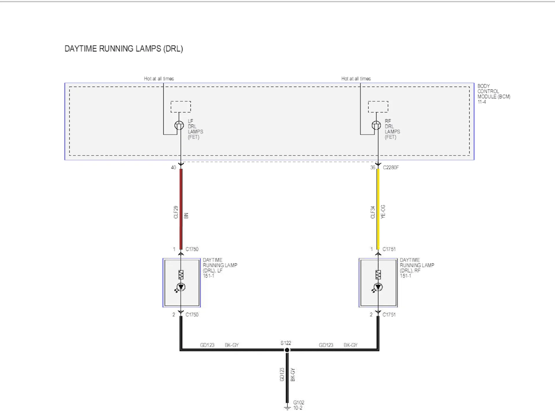

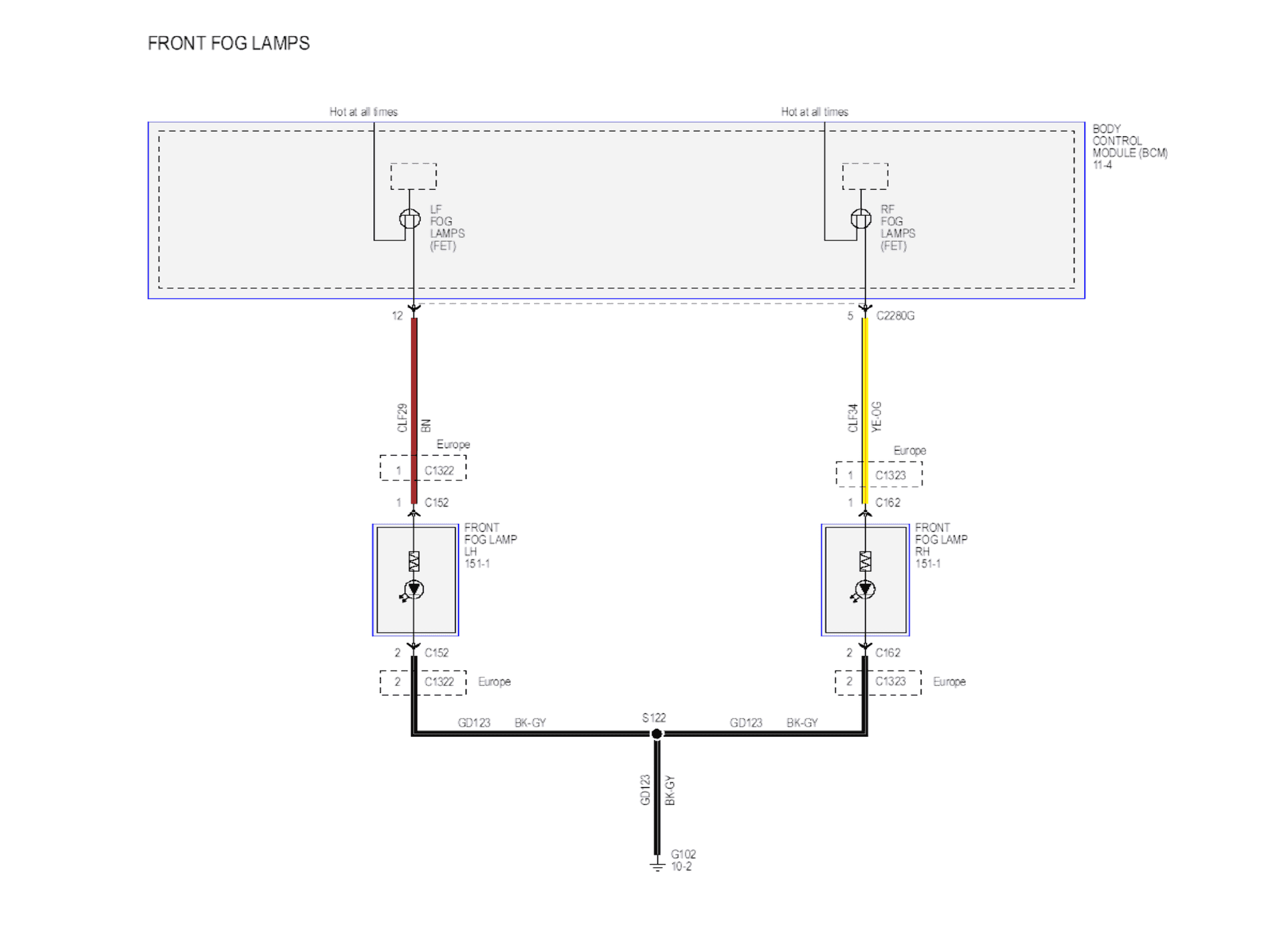

I have a 2015 v6 mustang that did not come with fog lights from factory. I am trying to tap into the headlight wiring with the aftermarket fog light wires. Does anyone have the wiring/pin diagram for the headlights? Thanks in advance.
Cobra Jet
Feb 12, 2015
771
17,595
20,037
Here ya go, hopefully this is what you need and it helps:
