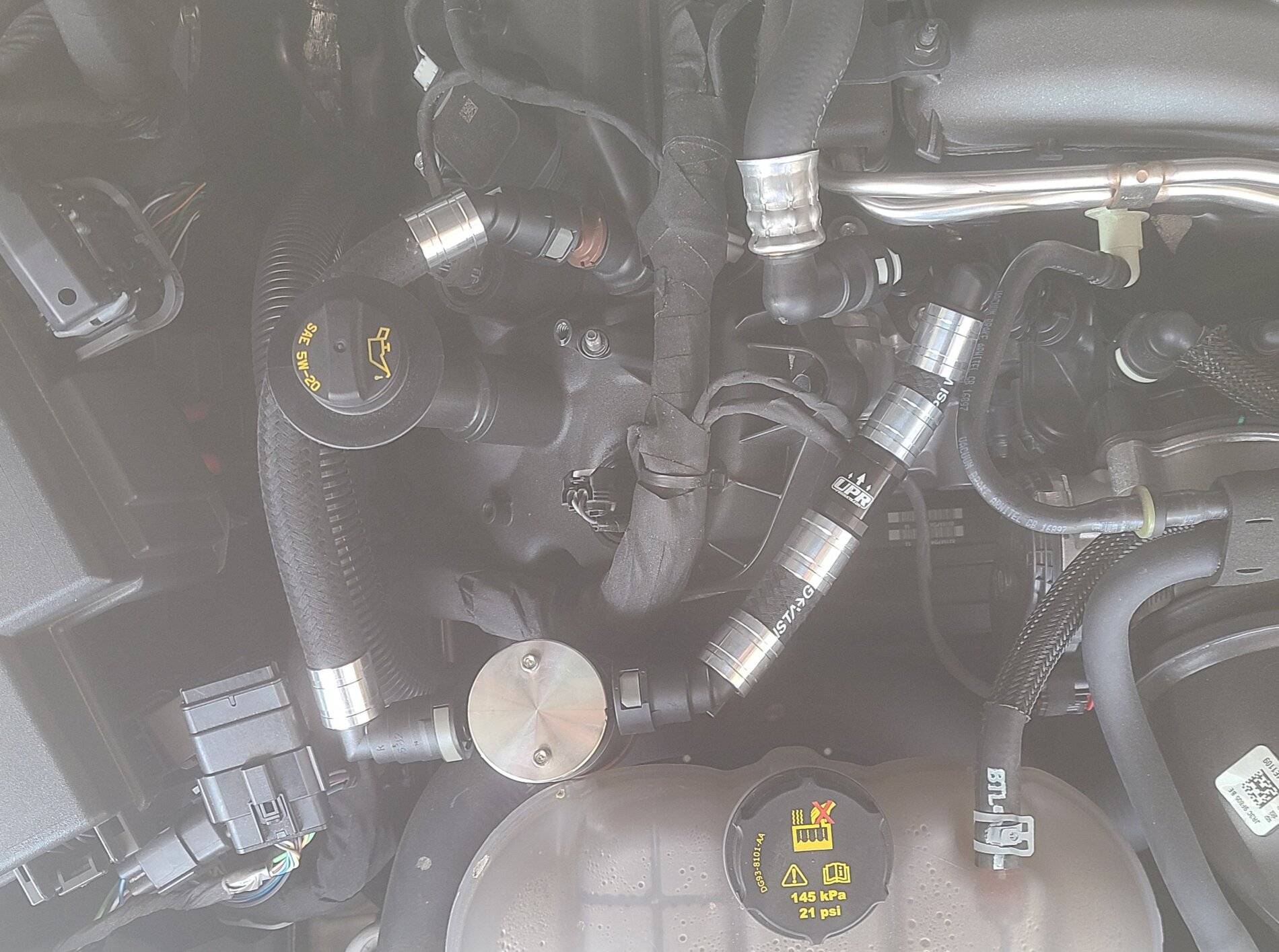

I put a UPR plug n play catch can on my car yesterday. This is the one without a bracket. Sorry for the noob question, but the can rests on the radiator hose and the coolant tank. There is no way to move it off of them. Is this anything to worry about? It doesn't feel right. I'm starting to think I should have got a can with a mounting bracket.

Pics would be nice to see it and evaluate.

If the can is only supported by the 2 hoses and not a bracket, it’s a bad design and you should send it back and get a better designed oil/air separator, such as the Ford racing part

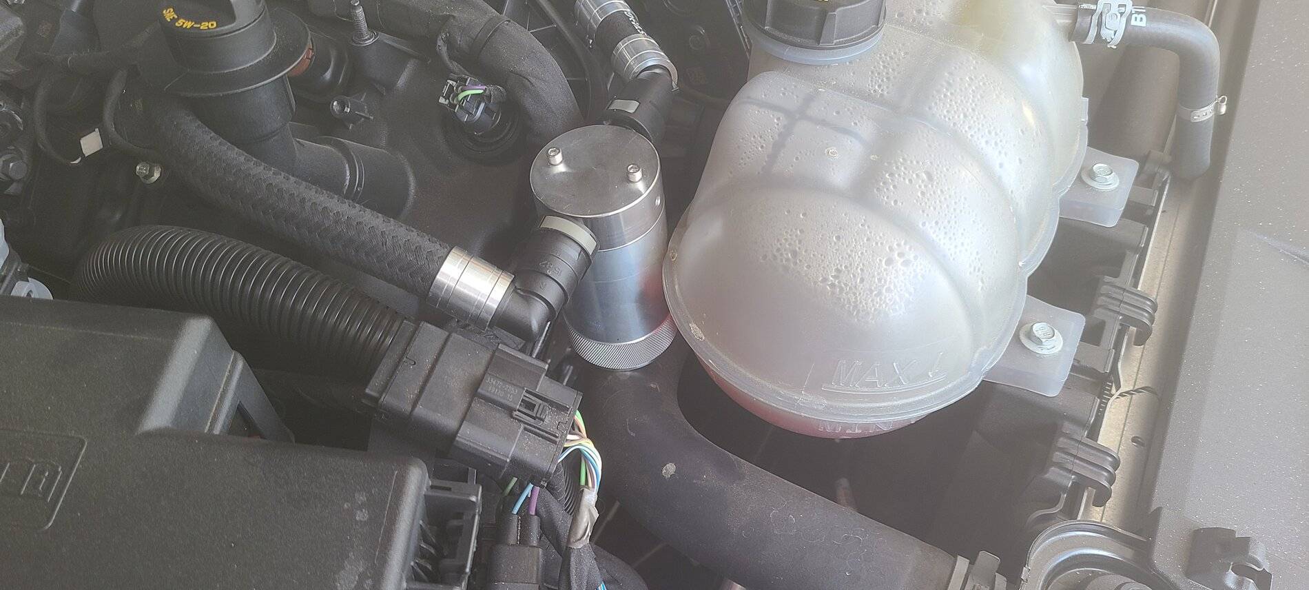

Here are some pictures.

I removed my UPR can because it was rubbing on stuff too, it probably won't be an issue but I wasn't a fan
